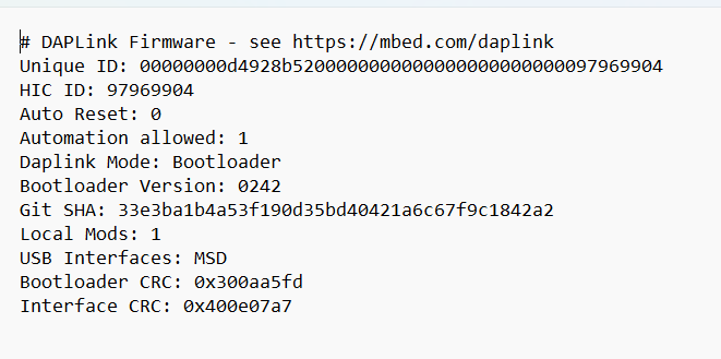

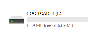

  • rsjawale24
    rsjawale24 over 4 years ago in reply to BigG
    I get the bootloader drive when I hold the boot button while powering it up. But when I drag and drop a binary file into the bootloader file, it says timeout error
  • rsjawale24
    This is my details text file inside the bootloader drive
  • BigG
    BigG over 4 years ago in reply to rsjawale24
    It's pretty much the same... key is bootloader version
    # DAPLink Firmware - see https://mbed.com/daplink
    Unique ID: 000000009ecfc04000000000000000000000000097969904
    HIC ID: 97969904
    Auto Reset: 0
    Automation allowed: 1
    Daplink Mode: Bootloader
    Bootloader Version: 0242
    Git SHA: 33e3ba1b4a53f190d35bd40421a6c67f9c1842a2
    Local Mods: 1
    USB Interfaces: MSD
    Interface CRC: 0xbb0e972e
  • misaz
    misaz over 4 years ago in reply to rsjawale24
    Hi. After yet another experiments and some hints from BigG I successfully found the cause of the issue.
    It looks that DAPLINK checks for binary data and most probably checks some data in binary (I gues it checks for vector table). The reason is that by default our firmware is compiled with addresses starting at zero which are used for DAPLINK firmware. You need to recompile with address skipping bootloader. Change contents of mbed_app.json file to following:
    	"target_overrides": {
    			"target.mbed_rom_start": "0x00010000",
    			"target.mbed_rom_size": "0x001F0000"
        "config": {
            "main-stack-size": {
                "value": 65536
    Then open mbed-os/targets/TARGET_Maxim/TARGET_MAX32620C/device/TOOLCHAIN_GCC_ARM/max32620.ld file and update line #36 containing FLASH memory definition to following:
    FLASH (rx) : ORIGIN = 0x00010000, LENGTH = 2031616
    This change linker script for TARGET_MAX32620C (note the C at the end). I am not sure why my MBED environment selected target ending with C but I recommend change this line in both TARGET directories.
    After that you get firmware which you will be able to flash to the device.
