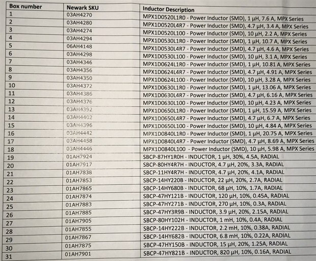

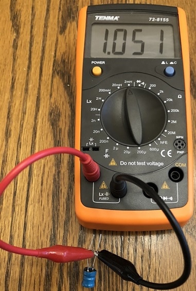

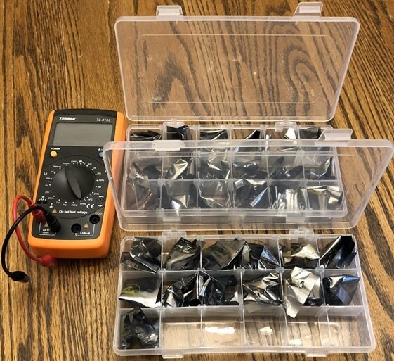

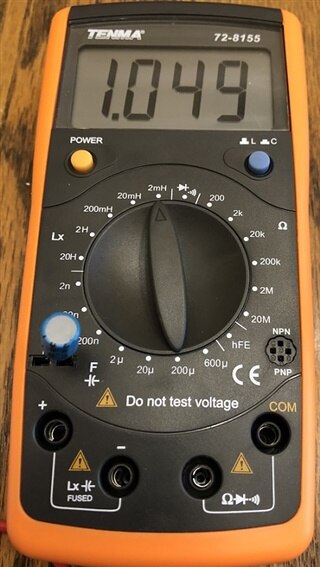

My element14 Kit for the "Experimenting with Inductors" Design Challenge, arrived yesterday (thanks!). The kit contained an LRC meter (Tenma 72-811572-8115) and 31 Inductors (contained in two plastic storage boxes - Duratool D00413D00413). The Inductors for these experiments are all from Kemet (18 surface mount and 13 through-hole parts).

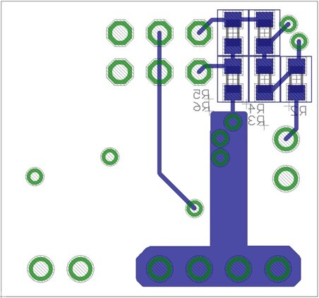

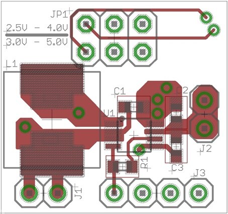

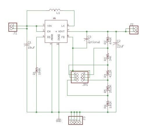

DC-DC Step-Up Regulator Board
This board will contain the minimal circuitry necessary for the regulator functionality.  This board is built around the Diodes Incorporated, PAM2401, 1.0MHz Step-Up DC-DC converter.  I choose this chip for my WalkyII project, based on it's true output disconnect functionality.  In order to facilitate testing at multiple output voltages, I have added a set of jumpers for different output values (2.5V, 3.0V, 4.0V and 5.0V).
The actual board measures 0.8" x 0.75" and contains a combined footprint for the L1 to allow for multiple Inductors from the kit to be soldered to the board.  My plan to start with some of the smaller Inductors (physical size) first and verify the regulator design and the base boards measurement circuits prior to doing a data collection on the fuller range of components (driving down the DC resistance of L1 with some of the larger inductors).  In addition, I will acquire a few more inductor values (From the same Kemet families) to generate a few more test points within the 1.0 to 10.0uH range, suitable for the PAM2401 device (2.2uH and 3.3uH).  I will also explore the need for a filter capacitor (C3) in this design.

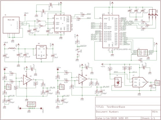

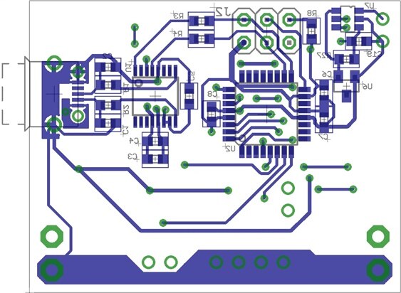

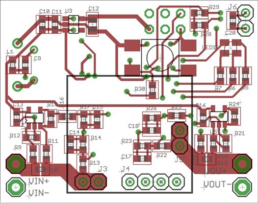

Regulator-base Measurement Board
This board will contain all of the support circuitry for testing the regulator board.  The regulator board plugs into the Regulator-base Measurement Board, providing power to the regulator and routing the regulator output to the DC load.
The actual board measures 1.65" x 1.3" and contains a USB peripheral port, ATmega328PB processor and the necessary measurement and support circuitry to allow testing of the regulator board.  I will be using the USB port and processor to read the voltage and current present at the input and output of the regular and communicate those values to the PC for data logging.  This will allow me to enter temperature readings (L1 and U1 of the regulator board) into the data logging stream.  The load level (constant current) will also be set through this interface.
Twisted pairs of wire will be attached to the VIN+/- terminals and connected to the power supply and between the VOUT+/- terminals and the Electronic load.  The regulator board will plug into the top side of the board (bottom center) using conectors J3, J4 and J5.  J6 will connect to the backside of the Electronic load to remotely control the constant current setting.  The LED and switch were added to support testing and to provide a standalone functionality for running tests.

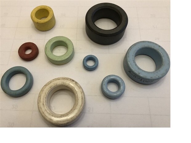

If I have sufficient time, I would like to wind some inductors and test the inductance measurement relative to the calculated values.  I have a few toroidal forms (Molypermalloy - Nickel, Iron, Molybdenum) of various sizes that I would like to experiment with.
