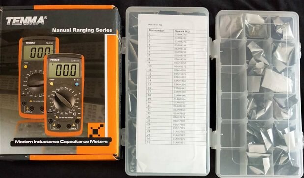

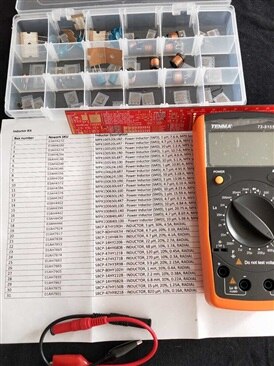

2. The inductor kit and LCR meter
2.1 There are 31 types of inductor samples and one TENMA -8155 LCR meter,
The element14  and KEMET are kindly offering brand-new product, since I have tried to buy more before the sample kit arrives. Searching simply return empty page with no stock available.
It is obvious that the inductor are of high quality, I have some other at hand as comparation. But I have difficult get precise value by TENMA LCR meter. Within 2mH range, the bias value shall be got before measuring value, but it perplax me with short circuit value normally about 1mH. This is still one unsolved issue for me.

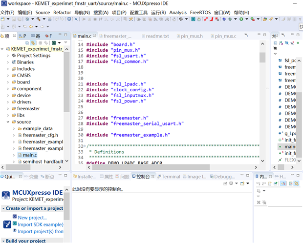

3. Experiment with RF Transmitter
3.1 Configurate with Freemaster library in NXP-LPC55S69xpresso
Import the Freemaster lib into the project
Key code in main.c

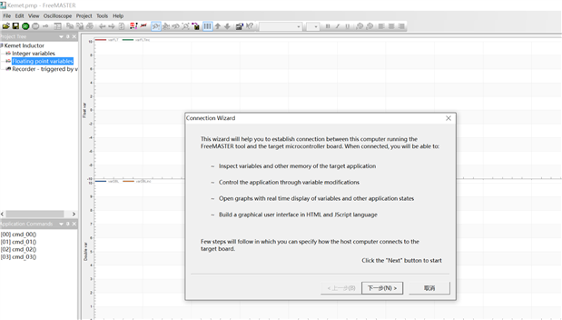

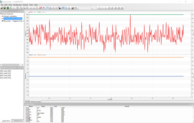

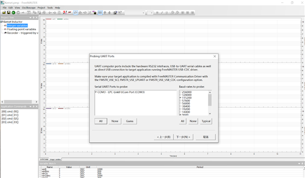

3.2 Run freemaster in PC host
Design the Freemaster project, with watch-grid, oscilloscope , recorder Blocks. Watch-grid show the values in MCU, it can be revised in PC host if set as Read/Write. oscilloscope block runs like real oscilloscope in realtime, but limited by UART baudrate as of 115200. Recorder Block runs in burst mode, sends data onece MCU buff is full, shown in PC host block by block.
Then Start Connection Communication,
Once connected, the oscilloscope starts,

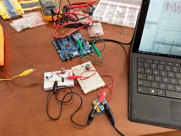

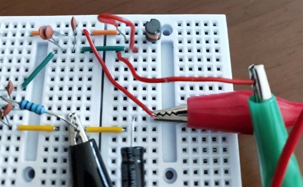

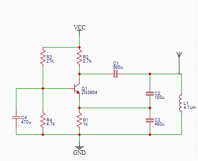

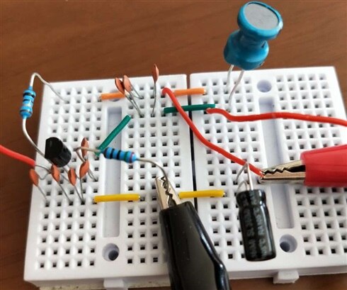

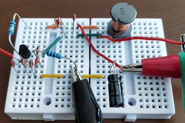

3.3 RF transimmter circuit in breadboard
Typical transmitter circuit shall be decided by L-C and NPN thyristor like,
The source wave shall be fed into base pole of thyristor 2N3904, then modulated by carrier wave decided by C2,C3 and L1, the frequency shall be
change the value of inductor can change the oscillator frequency, as in breadboard,

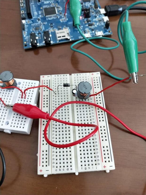

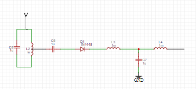

4. Experiment with RF receiver
Here is typical circuit or recever after demodulator, the inductor can normalize the signal after half-wave modulator by diode. Different value of inductor change the quanlity of signal.
Here is simplified bread board circuit wiring,

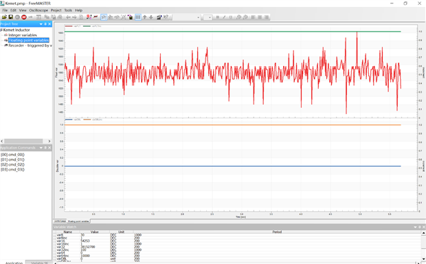

5. The result
Here is the full connection in bread board,
Even the RF part is skipped , there is no surprising with the results. There are conditions to be met for Oscillation, the value of capacitor and inductor shall be fine tuned for better output. In this case, there is no resonate in the circuit.
the demo video,
Clearly only the irregular noise is detected.
