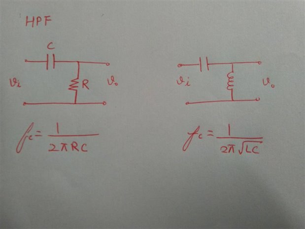

  • High Pass Filter(HPF)
A HPF as the name suggests is a filter circuit that will block all the signals with frequencies below a certain frequency and allow the signals with higher frequency.
Since, this is just the opposite of LPF, a HPF can be made by interchanging the positions of R and C in RC low pass filter and L and C in LC low pass filter.
Below is the circuit diagram for RC HPF and LC HPF
Note that the formula for the cutoff frequency for HPF remains the same as LPF. Only by interchanging the positions of the R and C or L and C are interchanged.

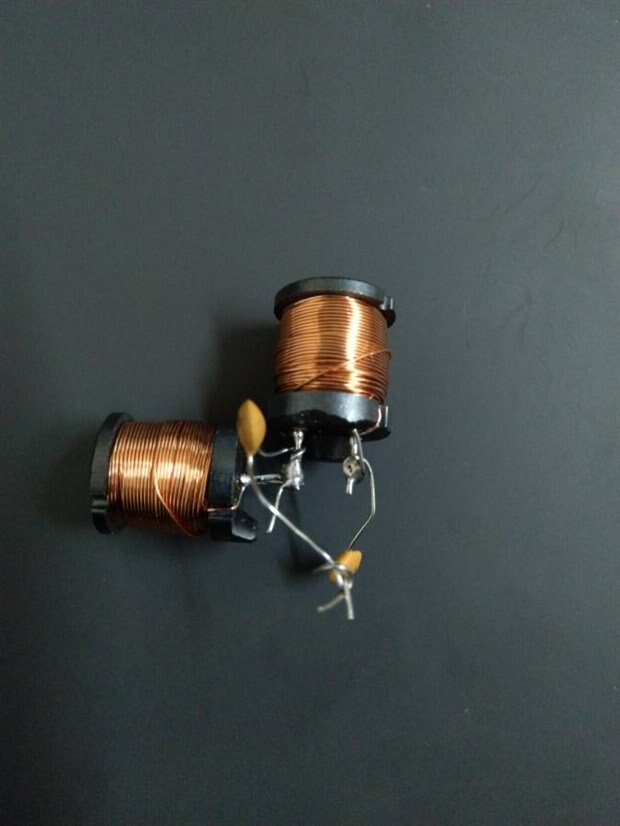

Implementating a LC low pass filter and extracting the fundamental frequency sien wave from square wave
I have implemented a low pass filter to filter out a sine wave out of a square wave. As we all saw in my last blog that a square wave is made up of sum of inifinte harmonics of sine wave.
Which means, we can produce a sine wave from a square wave if we are able to somehow separate the individual harmonics. The filter circuits help in filtering the frequencies and separating the harmonics.
Design
Firstly, I chose a L from the Kemet Inductors Kit, 2.2mH L and then a standard value of C (in my case C = 0.01 uF).
First order LC LPFimage
Then, using the formula the cutoff frequency is obtained as 33.9kHz.
Using a signal generator, I generated a square wave of 33.9 kHz. The screenshot below of DSO shows the square wave output from the signal generator.
Now, this square wave contains a fundamental sine wave of 33.9 kHz and harmonics of the 33.9kHz wave. I tried filtering the fundamental sinusoid from the square wave by using the LC LPF above.
First, I used only a single LC LPF (order 2) and
This is what I obtained after filtering the above square wave
As it can be seen on the DSO, the output of the filter is a sine wave of the same frequency as the input (There's a small frequecy deviation as the signal generator is not stable).
But as it can be seen that the signal doesn't look like a perfect sine wave, I cascaded another LC LPF with same L and C value to create a 4th order LPF which can give a much sharper attenuation of -80dB/decade
4th order LC LPFimage
I obtained the below output using 4th order LC LPF.
The sine wave is less distorted and frquency is also same. Here, we have succesfully, extracted the sine wave of fundamental frequency from a sqaure wave.
This circuit can also be used as a sqaure to sine converter.
