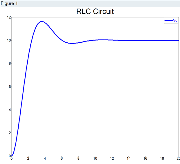

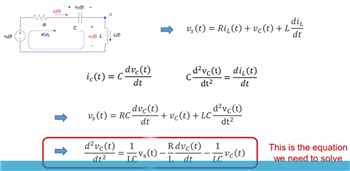

0 dimension equation can be used to model inductor. Example is this RLC circuit.
The equation we need to solve is derive as below
This can be modeled with OML (open matrix language) and i use Altair Compose with it
Compose can be downloaded and used for free at https://www.altair.com/mbd2019/
0D Equation
OML model
% Define the system function
function dx = myrlc(t,x,v,R,L,C)
  dx1dt = x(2);
dx2dt = v/(L*C) - (R/L)*x(2) - x(1)/(L*C);
dx = [dx1dt; dx2dt];
end
% Define the circuit
v = 10; % volts - constant voltage source
R = 1.; % resistor
L = 1.; % inductor
C = 1.; % capacitor
options = odeset('RelTol',1.e-3,'AbsTol',[1.e-6,1.e-6]);
handle = @(t,x) myrlc(t,x,v,R,L,C);
[t,x] = ode45(handle, [0:0.1:20], [0;0], options);
% Plot the results
vc = x(:,1); % Vc
plot(t, vc);
legend('Vc');
title('RLC Circuit');
Plot
Plot

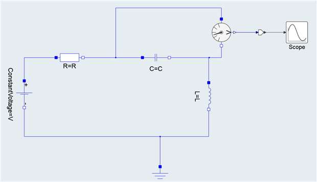

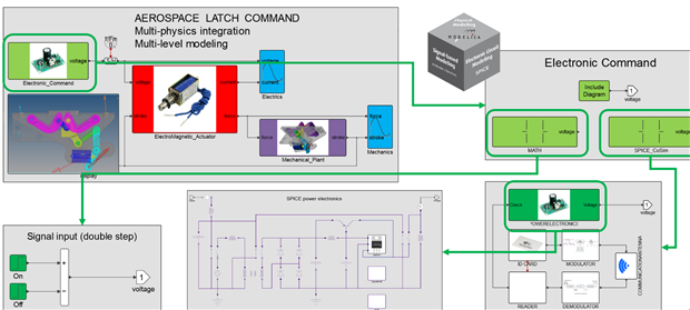

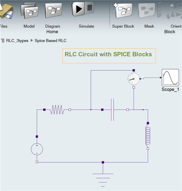

For this work, i will perform simulation with SPICE language, using Altair Activate [1]. It is an open integration platform for modeling, simulating and optimizing multi-disciplinary systems-of-systems using inherent 1D block diagrams. One can simulate cross domain physics via its built in blocks and Modelica library – a collection of blocks describing the physical behavior of Electrical, Electromagnetic, Mechanical, Thermal components. SPICE netlist can be used for the electrical side. For my experiment, i plan to model a power electronics driver that can drive a mechanical device. Below is an example that i will adopt to use
Modeling in Altair Activate
for this blog #1, let's look at how to model in Activate.
First, a simple RLC circuit. there is a webinar and project file is provided. Go to https://learn.solidthinking.com/activate-videos/rlc-circuit-with-different-modeling-approaches/
SPICE can only be used with non free edition of Altair Activate

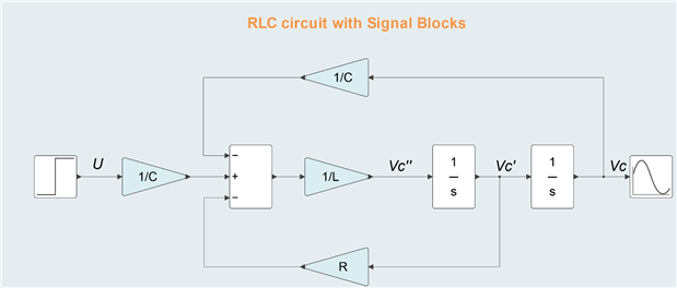

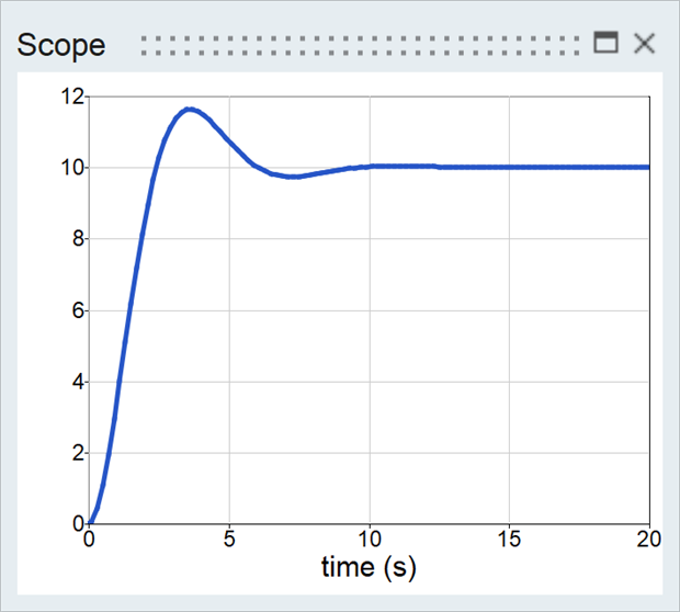

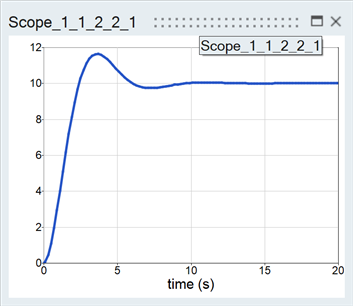

Activate Block based
with basic blocks in Altair
Input
Output

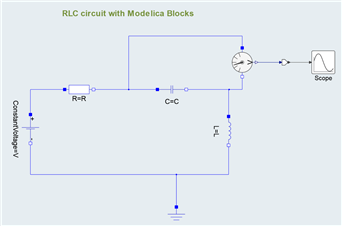

Modelica
with Modelica blocks
output

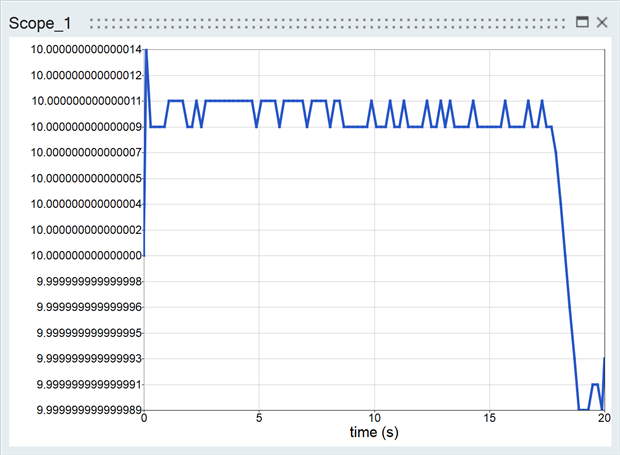

SPICE
SPICE

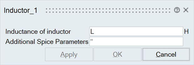

Altair Activate make use of hyperspice, which is originally and SPICE model software acquired by Altair.
in the SPICE blocks, we can enter additional SPICE parameters
we get this output....which is different

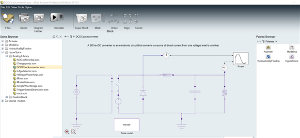

More Examples
You can also explore some built in example

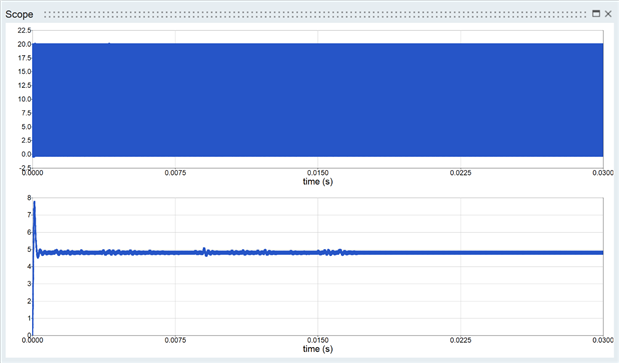

the screen below shows a DC-DC convertor and its output

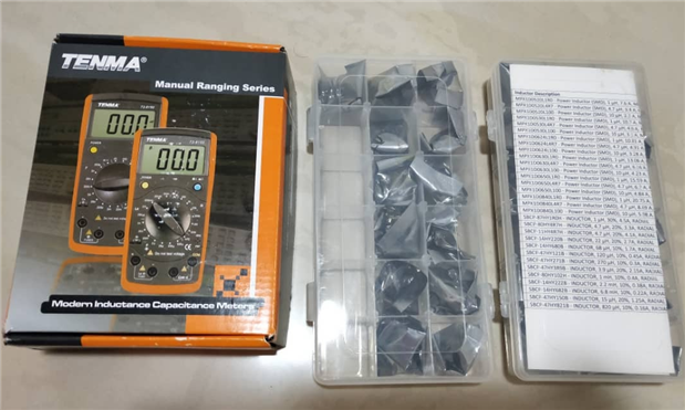

Validation
In modeling and simulation, we will need to perform validation on the simulated result. We will make use of the inductor kit to build a RLC
circuit for validation.
PS : have just come back to work from week long lunar new year but immediate having a week long business trip. will update this simple validation result
further once reach home on 9 Feb and test with oscilloscope  >> this is now updated in Inductor Modeling and Simulation - Experimenting with Inductors - Part 2 of 2
