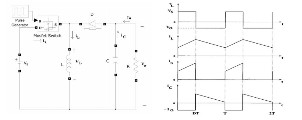

A Buck Boost Converter is a DC-DC regulator which provides an output voltage that may be less than or greater than the input voltage, hence the name “Buck-Boost”. A non-isolated topology of the buck-boost converter is shown below. The converter consists of DC Input voltage source Vs, controlled switch S, inductor L, diode D, filter capacitor C, and load resistance R. With the switch on, the inductor current increases while the diode is maintained off. When the switch is turned off, the diode provides a path for the inductor current. The buck-boost converter waveforms are also depicted. The condition of a zero volt-second product for the inductor in steady state yields; VsDT = - Vo (1-D)T. Hence, the dc voltage transfer function of the buck-boost converter is, Vo/Vs = - D/1-D. So the equation is, Vo = - DVs/1-D.image

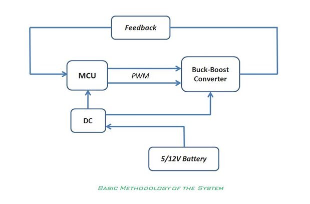

Block Representation

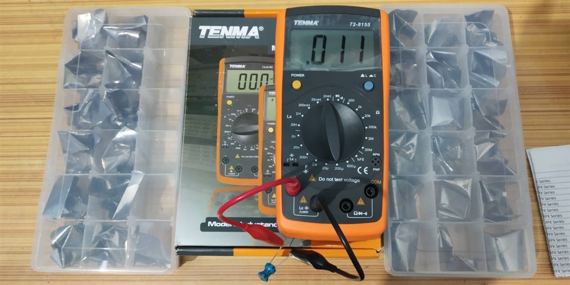

A Tenma -72-8155- LCR Meter, along with assorted set of SMD and Radial Inductor Pairs.
While measuring Inductors, I have noticed a slight (minimal) error in the approx. values of the Inductors, the Lx test-point provides much accurate result than that with alligator-ended probe!!!

    Ambitious project with all the datalogging and everything. Good luck with it. You've got a small typo on the circuit. For a positive supply the output is negative, as you show with your equation and waveforms…
  • jc2048
    jc2048 over 6 years ago
    You've got a small typo on the circuit. For a positive supply the output is negative, as you show with your equation and waveforms, so I think the + and - on the load resistor need to be swapped.
