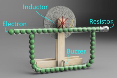

In the first blog, we did a deep dive on what an inductor does using a model I called the Crazy Inductor Learn-o-Nator.  So, how does all that theory apply to my project?
Crazy Inductor Learn-o-Nator1  Used to Understand Inductors
For a switching regulator circuit, the inductor works with a capacitor to manage and smooth the energy involved with the switching action.  Remember that the inductor will store up energy in a magnectic field around the coil.  When current slows or stops, that field will serve as electron inertia and the inductor will continue to throw electrons past it similar to our massive paddle wheel in the Learn-o-Nator above.  With a capacitor paired with the inductor, they can create a very stable constant voltage and good current source.  In the Experiments section, we'll see what happens when you remove that capacitor.

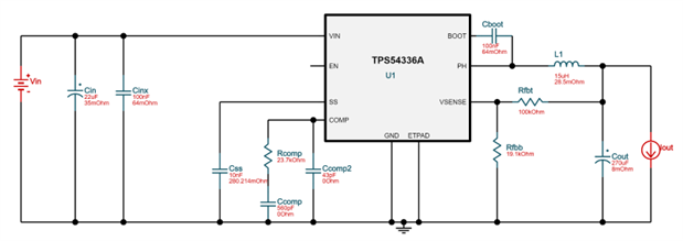

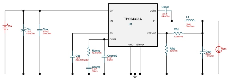

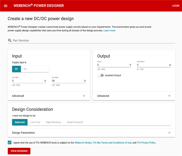

When researching for this blog, I stumbled upon a great toolkit available from Texas Instruments to support designing with their Integrated Circuits.  It's called the Webench2.  One design tool it has is for switching regulator circuits.  You simply put in your specs and it gives you the schematic, Eagle File, and a BOM!
TI's Webench Free Online Design Tool - just put in your specs and out comes the design and BOM
Output of the TI Webench Design Tool for Switching Regulators:  8V - 24V Input, 3A, 5V Output DC Power Supply Circuit
Output of the TI Webench Design Tool for Switching Regulators:  8 V - 24V Input, 3A, 3.3V Output DC Power Supply Circuit
Per the datasheet3, the output voltage is set with a resistor divider from the output node to the VSENSE pin.  TI recommends using resistors with 1% tolerance or better.  You may begin with a value of 10 kΩ for the upper resistor divider, Rfbt, and use Equation 1 to calculate the value of Rfbb. To improve efficiency for loads less than an amp, use larger value resistors.  But, if the values are too high, then the regulator is more susceptible to noise and voltage errors from the VSENSE input current are noticeable.
Equation 1:  Setting the Output Voltage
The output of the TI Webench tool also includes an Eagle schematic and a BOM.  I was glad to see, it even sourced KEMET components by default.  With this design and my existing stash of through-hole components, we can prototype and experiment.  So, I placed an order for some TPS54336A Switching Regulators2.

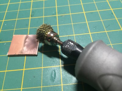

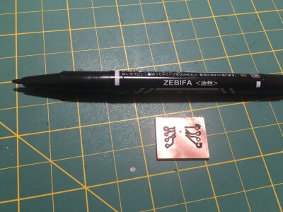

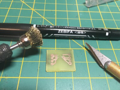

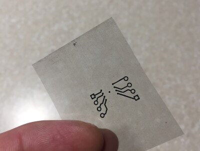

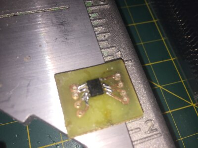

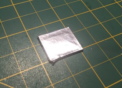

Before sending a PCB design off to get fabricated, it's always good to prototype it first to ensure it will work.  This will require a breadboard which uses through hole components.  My BOM from Webench can be replicated with through hole components I had on hand, but the main switching regulator, the TPS54336ADDATPS54336ADDA step down converter has a surface mount package.  So, I first need to make a little custom breakout board to convert its package for use with a breadboard.  I use the Ferric Chloride etching approach as shown below:
1.  Laser Print the Etchant Mask for the Circuit on Transparency Paper
2. Wire Brush off the Oxide Layer
3.  Stick It Down with Aluminum Tape (like you find on ductwork)

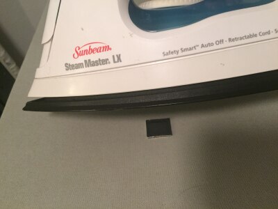

4.  Iron on Max Temp for 30 seconds
5.  Fill in Any Discontinuities with a Circuit Marker.  Use a razor knife to remove any shorts.

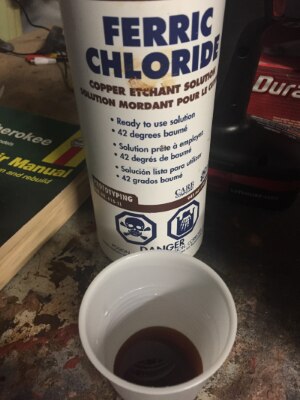

6.  Drop it into Ferric Chloride for 1 Hour (warm it and swirl for faster results)
7.  Wire Brush off the mask and use a blade to remove any shorts
8.  Drill and Solder (hot air or a small point iron)

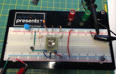

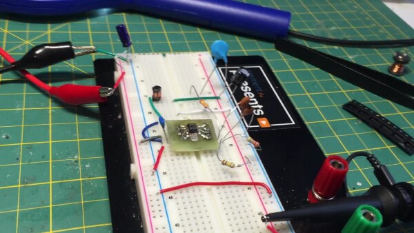

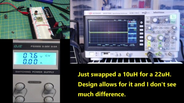

Digging through my parts bin, we had ourselves a prototype:
Our Breadboarded Power Supply Prototype
EXPERIMENTS

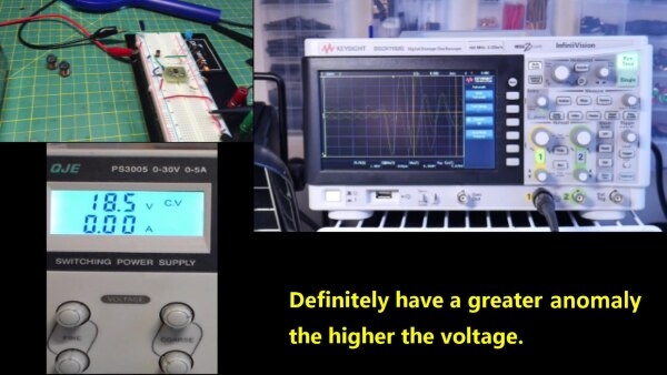

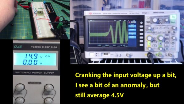

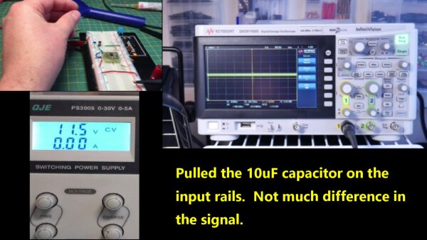

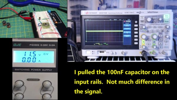

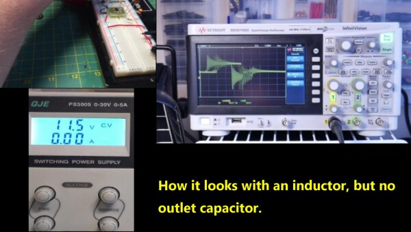

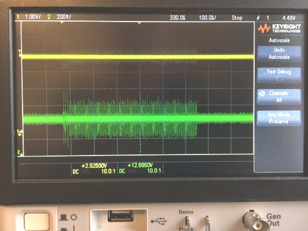

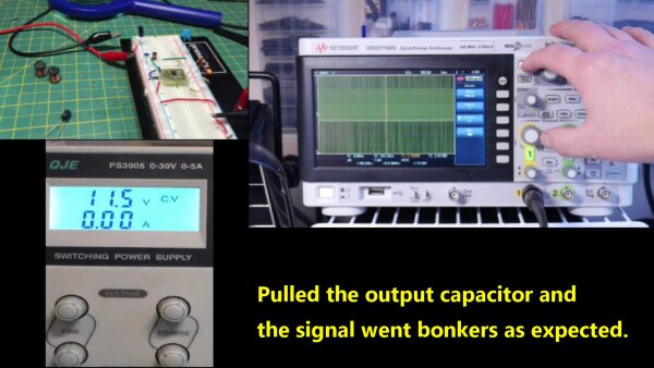

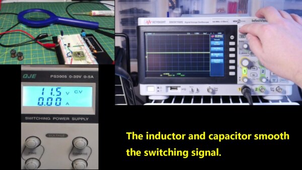

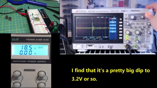

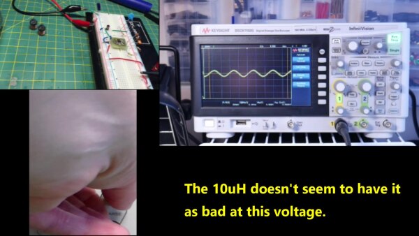

To experiment, I hooked up the oscilloscope so I could study the signal.  For the prototype, I didn't have the exact resistors on hand, so my Voltage was ~4.5V instead of 5V.  However, it did prove steady regardless of the power supply voltage setting.  For fun, I poke, pushed, and pulled out components to see their effect.  Here are some pictures of interest:
Green is Input, Yellow is Output
Appears the Anomaly is seen at the Power Supply to my Regulator, too
To see all the action in real time, here is the video:
The blip I was seeing was even seen at the power supply side.  However, when I took my regulator out and probed just the power supply, I did not see the blip.  However, it did have significant ripple.  The jumper wires, where they were connected on the board, and even me just touching the resistor would change the amplitude of the ripple by 10's of mV.  So, I suspect the "blip" is a reaction to switching of the regulator and it would be much less significant on a PCB where there isn't additional resistance and inductance involved with jumper wires and extra copper as on a bread board.

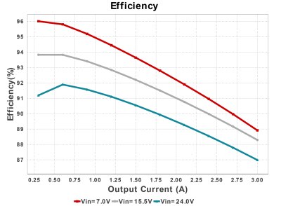

CIRCUIT EFFICIENCY

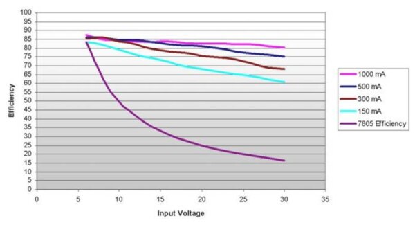

The efficiency of the circuit is provided with the Webench tool.  As you can see below, the higher the input voltage, the more loss you have to achieve 5V.  Also, as more load is pulled by the auxillary devices, it becomes less efficient.  For my dataloggers, I'll be in the 90% range with no more than 1A load.  This chart does show how I'm best to run my 12V batteries in parallel versus series (24V) to get maximum battery life.  Let's see how our designs compare to a linear (non-switching) regulator:
Our 5V Switching Regulator Design Efficiency Curves
Old School 7805 Linear 5V Regulator (non-switching) Compared to Switching Regulator4
The Lowest Curve is the 7805
As you can see above, a non-switching, linear regulator never achieves the efficiency of our switching regulator design.  In addition, most 7805 regulators are rated for less than 2 amps and give off a lot of heat.  This requires a bulky heat sink.  So, definitely, the switching regulator circuit using some additional tiny capacitors, resistors, and KEMET inductor is a much preferred approach.

    Hi Sean, This is great to see the prototyping pre-PCB! The TI tool is awesome. One small point (it doesn't detract from your conclusions which are right), the chart from the Oki part although it has the…
  • Sean_Miller
    Sean_Miller over 6 years ago in reply to shabaz +2
    Thanks for pointing that chart out, shabaz . Their product name and it's performance definitely tricked me. I searched on "efficiency versus current" and found a good chart on the 7805 compared to switching…
    shabaz over 6 years ago in reply to Sean_Miller
    I'm not sure to be honest (I still need to watch the video, hopefully tonight). It could be wiring length related, since all the paths are naturally longer on the breadboard, or the difference in components (since I'm guessing you're going for the recommended surface-mount parts for the PCB layout). It could also be power-supply related. Some bench supplies produce glitches at start-up : (
  • Sean_Miller
    shabaz, I'd like your thoughts on that blip I was getting.  It was a good 1/2V up and down.  I found things like jumper length, connection locations (rail versus row), and squeezing capacitors would change its profile.
    I imagine the blip would be less than 50mV's if I was on a PCB without long jumpers introducing their own resistance and inductance.
    What kind of swing in the output is considered a problem:  50 mv?, 100mv? 500 mv?
    Hi Sean,
    One small point (it doesn't detract from your conclusions which are right), the chart from the Oki part although it has the 78.. prefix, is a switching regulator, so easy to miss - I only know it because I've used that part previously and recognised the number.
    The chart for linear regulators will look worse the higher the input voltage, since more power is being dissipated in the regulator versus the load. In other words, it will be high efficiency when the input voltage is close to the output voltage (there's the dropout voltage as the minimum difference), but will drop loads as the input voltage gets higher. Sometimes it's not bad (e.g. if the overall power consumption is low anyway, then efficiency might be less of a requirement, even though it is still inefficient, i.e. depends on the use-case) but often it's bad!
