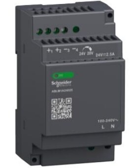

SCHNEIDER ELECTRIC ABLM1A24025 POWER SUPPLY
The power supply with DC 24V is required to power the PLC and other devices available in the kit. It is rated as 60W power. It accepts 100-240VAC as input and has 24V 2.5Amps output. There are two output connections meaning two devices can be connected easily and more can be added by multiplying the connections. Only condition is that we do not increase the rated power requirements.
To conclude in short about this power supply from Schneider electric it can be used to power PLC, Harmony Hub ZBRN2, HMI display and other components such as relay. So perfectly suitable for my application and given other components in the kit.

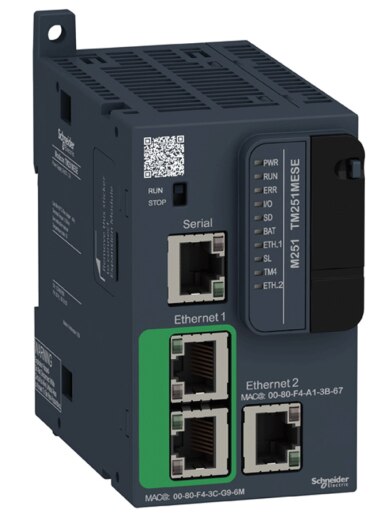

MODICON PLC M251 TM251MESE
Modicon M251 is a Schneider electric PLC series with following key features
  • 64 Mbytes RAM, of which 8 Mbytes available for the application
  • 24VDC power supply
  • 128 Mbytes of flash memory
  • 1 serial line port
  • 1 USB mini-B programming port
  • 1 dual port Ethernet switch
  • 1 Ethernet port for fieldbus
  • SD card slot
  • Expansion module
The M251 Logic controller is programmed with EcoStructure Machine Expert Software that supports coding in following IEC-61131-3 programming languages

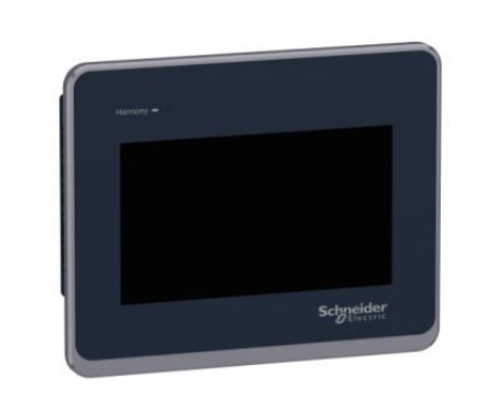

HMIST6200 HMI MODULE
HMIST6200 HMI module from Schneider electric is HMI module with 4" LCD. It can be programmed using EcoStructure terminal expert GUI design software and various variable can also be transferred through PLC program running on EcoStructure machine expert. For example, sensor values can be transferred through PLC using software and can be displayed on screen.  It has following features.
  • Ethernet interface for transferring code
  • Serial interface with RJ-45 connector
  • USB type-A and type-B interface support
  • 480 x 272 pixels resolution
  • 16 million colours
A program can be uploaded to the device through the Ethernet port or through the USB interface.

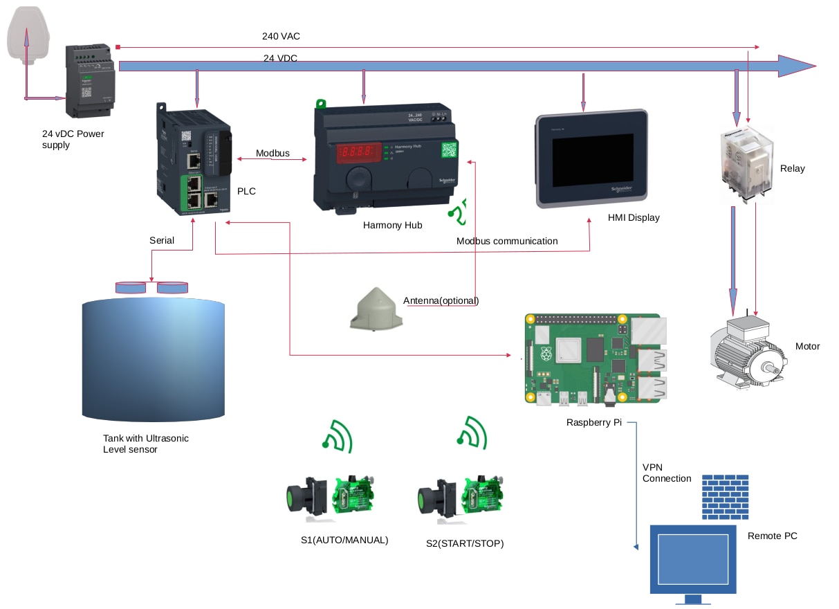

As I have mentioned all the parts and devices that are included in this package, now it is time to explain how I plan to used these devices in my project. The idea is that PLC will act as central controller that acts as a brain of the system. It will first connected to ultrasound sensor through some form of communication interface such as RS-485 or Modbus communication. The same PLC will communicate with Harmony hub to get the data received tirelessly from the push buttons and dynamo switches. PLC will also communicate with HMI to pass on correct sensor readings so that it can be displayed on LCD and users can provide some input through this display unit.
As the above diagram one can see two switches (S1 and S2). Both of these are used for user to have some control over the functionality of the project. First switch S1 will decide weather to use AUTO or MANUAL mode. In AUTO mode PLC will take care of when to start and stop the motor to keep the desired water level in the tank. HMI display can be used in this case to control the desired levels of water. The second switch(S2) can be used to start or stop the motor manually by user. User can start the motor whenever he/she want and stop as accordingly to fill the water tank. In this case HMI input is ignored or not required. The relay must be control with some form of excitation from the PLC.
Every major module in the diagram above is provided 24 VDC through the power supply connected to the mains supply. Motor and relay are provided power from the 240 VAC power supply.
Finally, A raspberry pi can be used to remotely monitor or access some of the PLC functionalities. This is not a mandatory requirement but will add some extra features on top of PLC functions.
