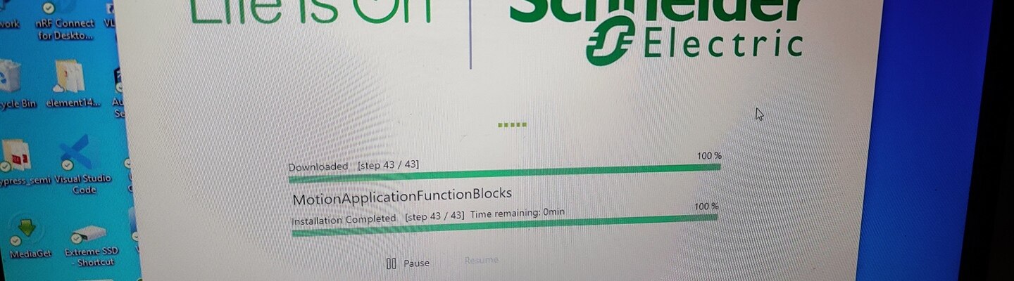

Installing EcoStructure Machine Expert
Schneider Electric has provided with software installer to manage installation of different software tools. Below image galaxy has some screen shoot about installation process.
{gallery}Installation software
IMAGE TITLE: Software installer
IMAGE TITLE: Components
IMAGE TITLE: Individual components
