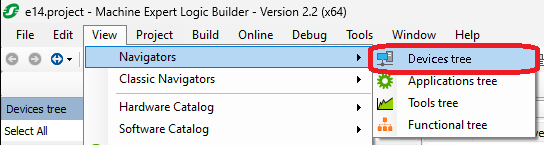

Step #1 of getting this system to exchange data is to start in the PLC Device Tree.  (View -> Navigators -> Device tree)

Back on the Device Tree, click on your newly added Modbus_IOScanner (Modbus IOScanner) line.  Right click.  Add Device.
You can add the ZBRN2 from the Harmony folder.  I chose to add the Generic Modbus Slave.  Both work.  Click on Add Device button in the lower right of the window.
