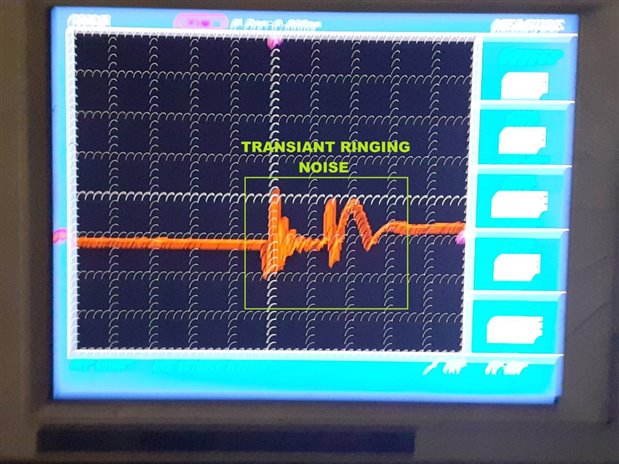

Ringing noise:-
what is it ?
“Transients”, a term used for simplicity, are “Transient Voltages” or more commonly referred to as “surges” or “spikes”. Transients are momentary changes in voltage or current that occur over a short period of time. In the context of power supplies, noise is any undesirable voltage impulse which appears at the output. In electronics, ringing is the oscillation of a signal, particularly in the step response to a sudden change in input. Ringing is often undesirable, but not always, as in the case of resonant inductive coupling. It is sometimes described as a “ringing transient”. This type of transients is characterized by swings above and below the normal line voltage.
what causes it.?
· Transient ringing. This type of oscillation looks like ripple from power conversion, but it is fundamentally different. This arises from the parasitic capacitance and inductance in the PDN. As an IC switches states or output levels, it draws a burst of current that produces a transient oscillation, which is sometimes called a ripple voltage. This transient response can appear on the power rails even if the supply voltage is regulated.

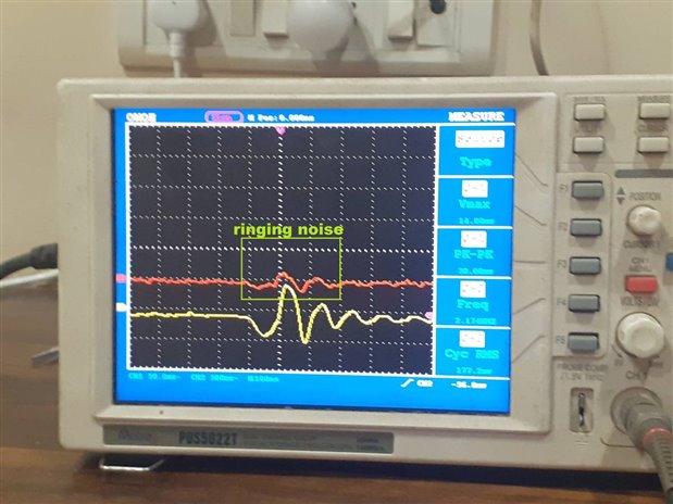

ringing noise:-
We can bypass the ringing noise of the 5 volt charger by either using a large bypass capacitor for that ringing frequency or we can use Inductor to attenuate the noise.

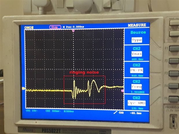

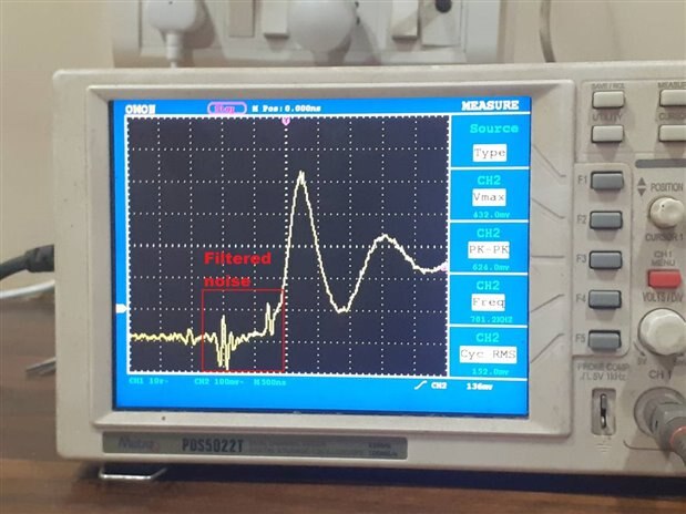

Using capacitor to filter the ringing noise to ground.
Figure 1
Figure 1 shows the original ringing noise. frequency of ringing noise is 1.96 MHz. Maximum voltage is 460 mili volt. peak to peak is 940 mili volt. We have set the probe of the oscilloscope to 1X so
it can give 10x magnification. So the orginal Maximum voltage is 46 mili volt. peak to peak is 94 mili volt respectively.

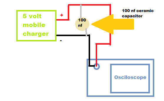

Bench setup for the experiment:-
we have use 100nf ceramic capacitor to filter the noise.
Figure 2

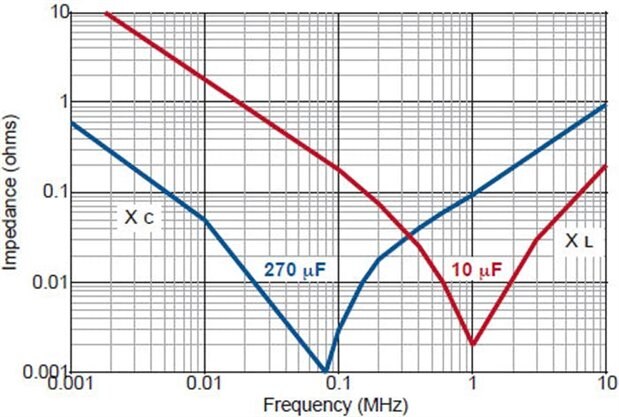

Figure 2 shows attenuation of ringing noise using 0.1 uf capacitor. The noise signature on the scope is around 200 milivolt peak to peak that comes down to around 20 milivolt beacuse of 10X amplification used in the oscilloscope probe. The problem with using ceramic capacitor for attenuation of the noise is that, they provide best impedance at center frequency. if we change capacitance value to any higher the center frequency will change so as the impedance of attenuation for that frequency. you can see it in the graph bellow.

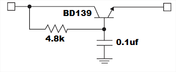

We can use multiple capacitor with same value in parellel to increase attenuation but that will not imapct it largely. We can replace single capacitor using capacitance multiplier circuit for the highest effect.

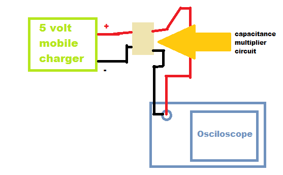

Figure 4
Figure 4 shows capcitance multiplier circuit that is used for attenuting ringing noise of 1.96 MHZ.
Bench setup for capacitance multiplier circuit
Figure 5
In Figure 5 you can see the attenuation of ringing noise that has come down from 94 milivolt peak to peak to 30 milivolt peak to peak i.e approximately equal to 3 milivolt because of using 10X amplification of probe.

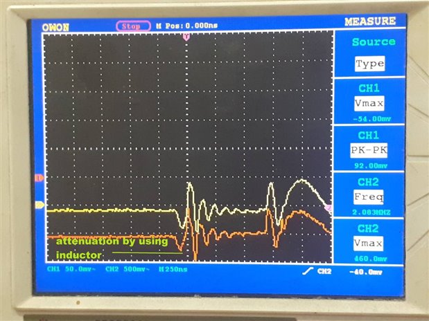

Using Inductor for attenuating signal.
Inductor not only attenuates the ringing noise but also many other noises as well. The problem with inductor is that it introduces winding resistance which causes voltage drop accross the DC line.
Figure 6
Figure 6 shows attenuation of ringing noise using inductor.
The red scope line indicates the attenuation done by inductor. The noise amplitude is aproximatrely 92 milivolt which comes down to around 9.2 milivolt because of using probe at 10X amplification. We have use 100 milihenry inductor provided by newark. component RL181S-104J-RC.

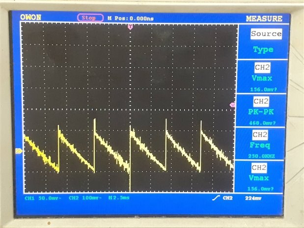

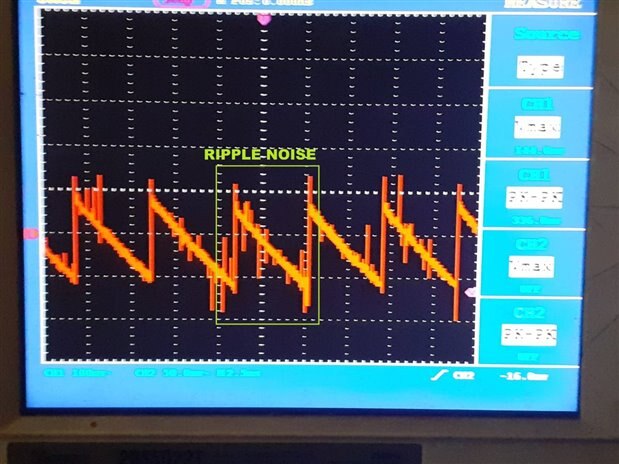

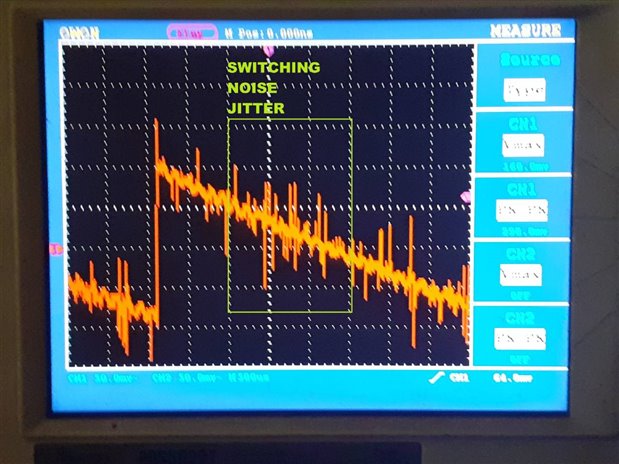

Ripple noise:-
the main wave form is shown in the bellow figure7 and the FFT spectrum of it in figure 8
Figure 7
Figure 7 shows the orginal ripple from the output of the 5 volt mobile charger. Which is a swatooth ripple along with switching noise jitter on the ripple waveform and transiant ringing noise.

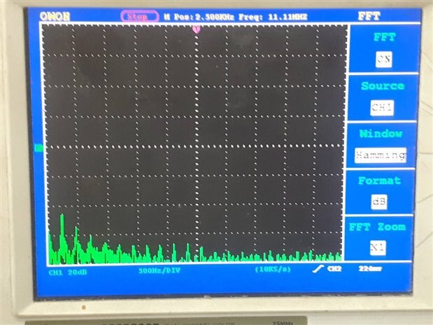

Figure 8

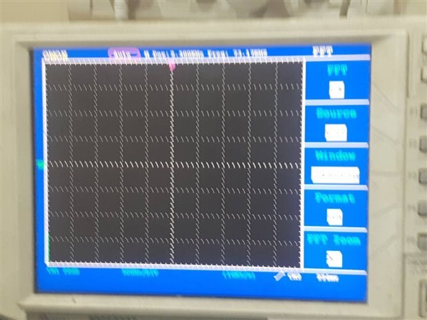

Figure 8 shows the FFT spectrum graph of the swatooth waveform. From the FFT graph you can understand that swatooth ripple is made up of multiple low frequency sine wave harmonics from 1 hz to 5 khz range. Figure 9 shows the waveform after filtering the ripple noise and and it’s FFT graph at Figure 10.

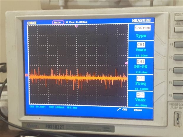

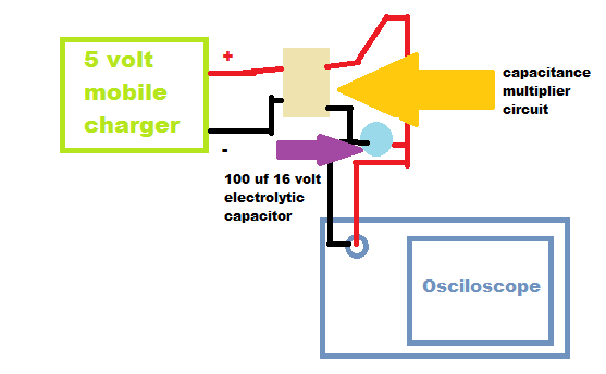

Bench setup for filtering ripple noise
Figure 9
Figure 9 shows a straight line that is achieved after filtering all the low frequency noise from the swatooth wave. The FFT spectrum graph in Figure 10 shows that there is not low frequency ripple left to attenuate.
Figure 10
Figure 10 FFT spectrum graph. In which all the low frequency spectrum has been attenuated.
