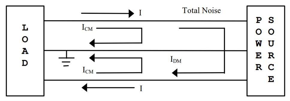

The conduction may be in one of two modes:
  • Common mode:   This type of EMI coupling occurs when the noise appears in the same phase on the two conductors, e.g. out and return for signals, or +ve and -ve for power cables.
  • Differential mode:   This occurs when the noise is out of phase on the two conductors.

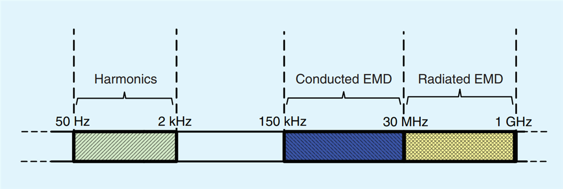

When testing for EMC, the regulator will test conducted and radiated electromagnetic emissions separately. Each has its own limits and frequency range along with its own suppression method. Radiated emissions cover a higher frequency range (typically 30 MHz to 1,000 MHz) and as the noise travels through space it is limited in how it can be controlled. Besides using proper layout and circuit design techniques to attenuate the noise at the source, shielding can be used to contain the radiated noise. On the other hand, conducted emissions cover a lower frequency range (typically 0.15 MHz to 30 MHz), and, because they travel through conductors, can be controlled using electrical filtering components. The designer, when adding EMI filtering may choose to design it discretely or choose to go with an off-the-shelf EMI filter.

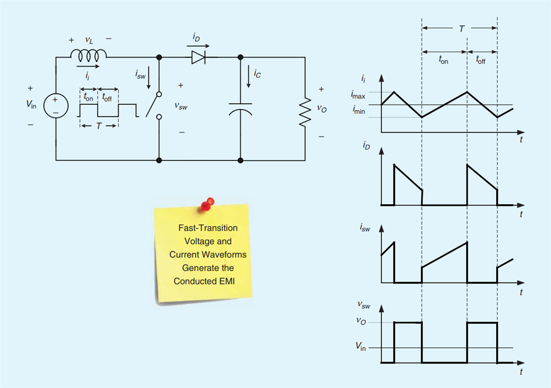

Conducted EMI Generation
Switched-Mode Power Supplies (SMPS) -also known as Switching Power Supplies (SPS) or Isolated DC-DC converters- are of widespread use in modern days because there are significant benefits in reduction of the physical sizes and high efficiency compared to the linear power supplies. Although there are several types of SMPS, all of them can be derived from the three basic DC-DC converters namely buck converter, boost converter, and buck-boost converter. In order to obtain the required DC output voltage, the semiconductor switch e.g. Metal-Oxide-Semiconductor Field-Effect Transistor (MOSFET) of the boost converter must be switched “ON” and “OFF” by varying its duty-cycle at the switching frequency. Since the boost converter operates under extremely high switching frequency, the fast-transition voltage and current waveforms at the switching devices are resulted, as shown in the figure below. These fast-transition voltage and current waveforms are the main noise sources and generate a wide spectrum of electromagnetic disturbance (EMD). Such electromagnetic noise propagates through the power cord connected to it and can also radiate in open space.

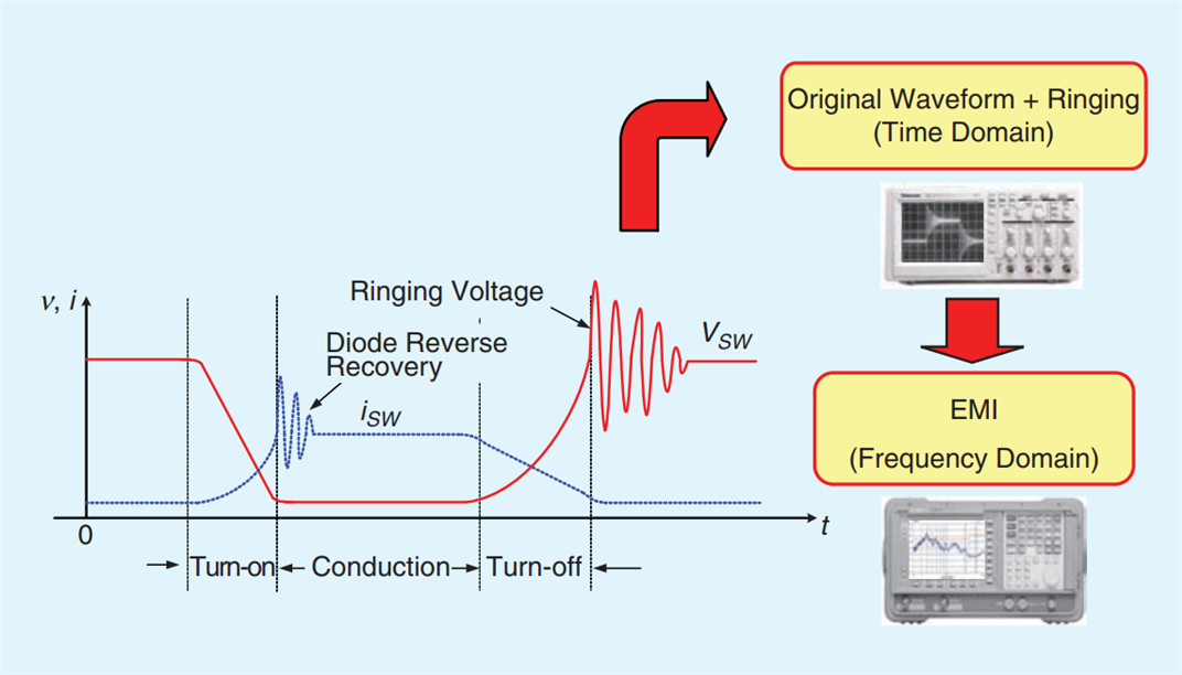

Moreover, the cause of EMD is not only the switching operation of SMPS but also the parasitic elements of the passive components such as a capacitor, resistor, inductor, transformer, and power cord as shown in the figure below. In addition, the parasitic elements also come from the device leads, printed circuit board (PCB) traces, and device installations. For example, a heat sink is usually connected to the body of the MOSFET, which introduces a parasitic capacitance between the MOSFET and the heat sink. Those parasitic elements can cause a ringing voltage and current superimposed on the original switching waveforms which tend to enhance the certain regions of the original EMD.

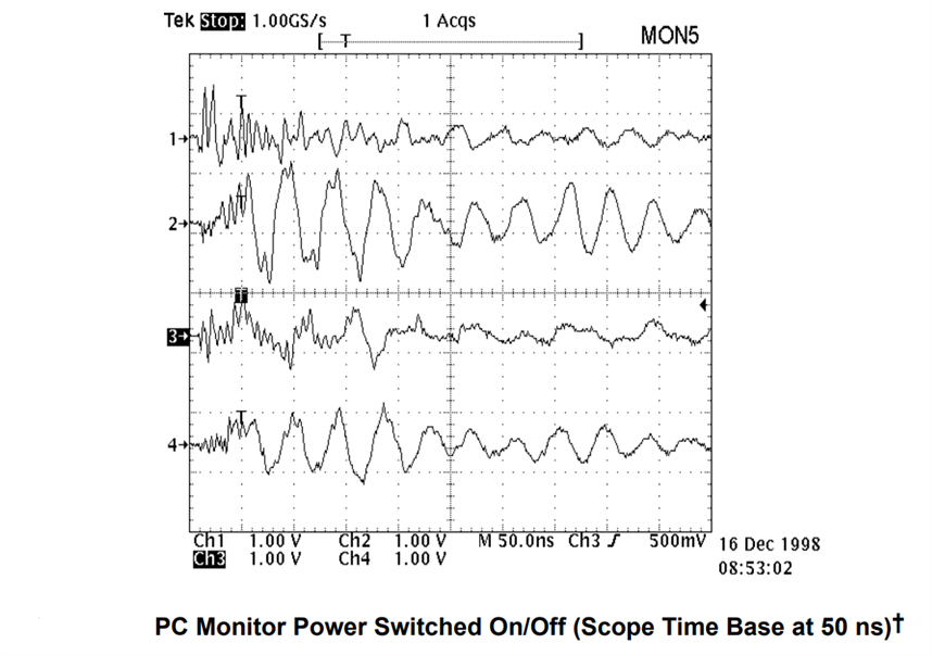

The parasitic elements cause a ringing voltage across the switching device, during turn-off periods, while the diode reverse recovery causes a ringing current passing through the switching device during turn-on periods, as shown in the figure below. Therefore, it can be concluded that it is not only high dv ⁄dt and di ⁄dt during turn-off and turn-on periods having a great influence on EMD problems, but the ringing voltage and current too.
The generated EMD might degrade the performance at the device, equipment, or system level, either because the apparatus is powered by the same commercial power system and/or its location is very close to the power supply. If the performance of a device, equipment, or system is degraded by EMD, we commonly talk of electromagnetic interference (EMI). EMI produced by electrical and electronic appliances can be minimized if EMC principles are taken into account at the design stage. However, to ensure that the products can comply with the conducted EMI limits, the filtering techniques (passive filtering and/or active filtering) are normally used to suppress the conducted EMI.
Conducted EMI Noise

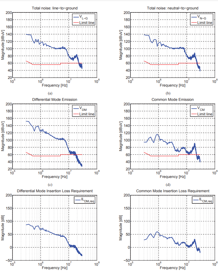

Generally, the conducted EMI can be categorized into two conduction modes: the differential mode (DM) emission and common-mode (CM) emission (we will explain in detail later). The DM current flows out of the live wire and returns via the neutral wire. The CM current takes the live and neutral wires as one outgoing conductor and returns via the ground wire. Hence, the DM currents in the live and neutral wires are equal in magnitude but opposite in phase, while the CM currents are equal in both magnitude and phase.

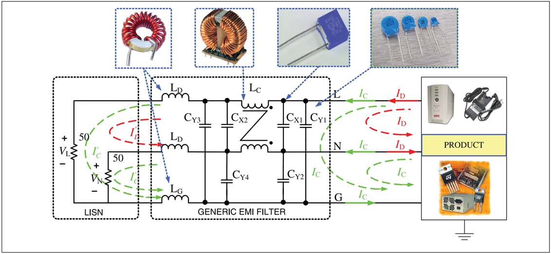

EMI filters are generally designed as passive filters composed of resistors, capacitors, and inductors, without active components like transistors. According to the characteristics of EMI at the power port, the EMI line filter is a passive low-pass filter, which transmits AC to the power supply without attenuation and greatly attenuates the EMI noise incoming with AC. In the meantime, it effectively suppresses EMI noise generated by power equipment, to prevent them from entering the AC power grid to interfere with other electronic devices.

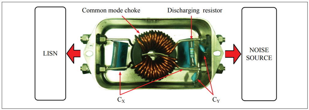

The Figure below shows a typical power line filter schematic and it is easy to figure out its structure. This is a passive network, suitable for both AC and DC power with bidirectional suppression performance. It is placed between the AC power grid and power supply, which is equivalent to shielding EMI noise between them. Such a simple passive filter plays the role of two-way noise suppression that it is widely applied in various electronic devices.
Power Line Filter Structure Schematic
The structure of a typical generic filter topology of a power supply filter is composed of common mode choke (CM choke), differential mode choke (DM choke), X-capacitors, and Y-capacitors. As the above figure shows, C1 & C2 is the differential-mode capacitor, usually called X capacitor with suitable capacitance selection from 0.01μF to 2.22μF; C3 & C4 is the common-mode capacitor, called Y capacitor with a capacitance of about several nanofarad (nF) to dozens. C3 & C4 capacitance should not be chosen too large; otherwise, it will easily lead to danger like current leakage from the filter or even the case. L is a common-mode choke, which is a pair of coils twined in the same direction around the same ferrite ring, with the inductance of about several millihenries (mH). For the common-mode interference current, the magnetic fields generated by the two coils are in the same direction, and the common mode choke shows a larger impedance and thus attenuates the interference signal. For the differential-mode signal (here, it is the low-frequency supply current), the magnetic fields generated by the two coils cancel out, so the power transfer function of the circuit is not affected. Please note that this is a single-stage filter circuit. If you want a better filter effect, a two-stage filter can be used.
It should be noted that the most common power supply filter topology is some version of the generic filter topology. The main objective of an EMI filter is to suppress the conducted DM and CM emissions generated by the SMPS and denoted as currents ID and IC. The noise currents measured at LISN and denoted as I′ D and I′ C should be lower than the conducted EMI limit line. Like other passive filter circuits, the passive EMI filters are made from passive components; specific types of resistor, inductor, and capacitor are used.

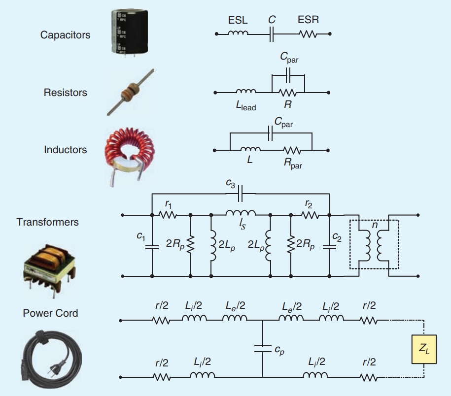

There are many factors that can deteriorate the designed EMI filter performance e.g. the termination impedances, the layout of the EMI filter components, and the connection between the EMI filter and a LISN. In addition, the use of an EMI filter with an SMPS might perturb the overall system stability, if a DM input impedance of SMPS is larger than a DM impedance of an EMI filter connected to it. Conventional filter design procedure used in communication systems and microwave applications is well developed by assuming that the terminated source and load impedances are 50 W matched. This assumption cannot directly apply to the design of SMPS EMI filters, where the actual noise source and terminated load impedances are far from 50 W. In practice, EMI filters are influenced by the noise source impedance and by the terminated load impedance, and the filter design by assuming 50 W noise source and termination impedances leads to deviation of EMI filter performance from the actual operating conditions.
Additionally, the power cable between the LISN and the EMI filter can also degrade the EMI filter performance at high frequency. Moreover, the filter resonances and the interaction between the filter capacitor and the noise source impedance can not only degrade the EMI filter performance at high frequency but can also cause a stability problem in the SMPS. In such a case, the filters must be damped.

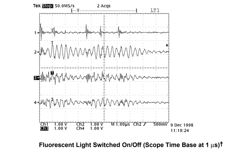

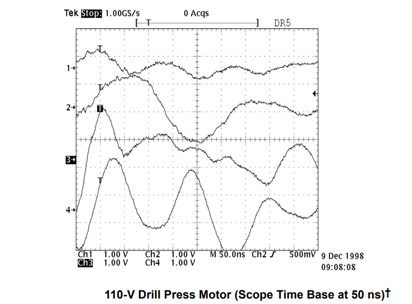

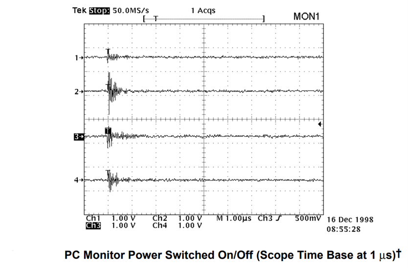

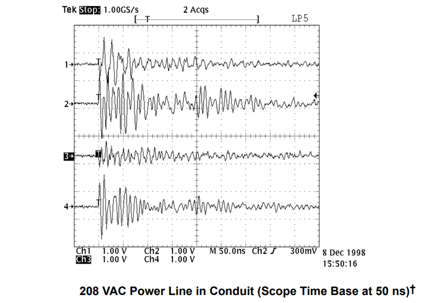

The amount of noise present on the power line can be surprising at any given time. The source of this noise is from the electrical distribution system external to the building and from the one within the building. It is the result of the power line’s dynamic nature due to the ever-changing loads. The figure below shows typical noise found on a power line. This was taken from unconditioned house power inside an IC characterization lab. Some of the signals occur at a regular repetition rate related to the 60-Hz power frequency. This type of noise is common-mode signal found on the power line. Some type of motor-driven device generally causes this type of noise. An oscilloscope left in infinite persistence mode would show random or asynchronous noise that is the result of loads being switched on and off, power utility switching, or some natural phenomena. Conventional power transformers and isolation transformers will not block normal-mode noise impulses, but if the secondary of these transformers has the neutral bonded to ground, then they serve to convert normal-mode noise to common-mode noise. From the standpoint of microelectronic circuits, common-mode noise is more potentially harmful than normal-mode noise. Common mode noise is often referred to as common-mode voltage (CMV) which is present at both input leads of an analog circuit with respect to analog ground.
The biggest source of common-mode noise is the difference in potential between two physically remote grounds. This is often the case when dealing with networked computer equipment where ground loops can occur. Typical effects of this can be intermittent reboots, lockups, and bad data transfer. Network interface cards, serial ports, parallel ports, and modems are prime targets for some form of failure due to CMV. If the CMV is high enough, component failure is possible. The second most significant common-mode noise source is ungrounded sources. This can occur when a separate power supply is used to power the field device remotely, and the remote power supply is left ungrounded. The radio frequency noise sources are common sources of common-mode noise. A poor ground system or an ungrounded analog signal cable can literally act as an antenna, gathering the induced voltage and applying it to the analog input. The most common methods of treating common-mode noise lose their effectiveness as the frequency of the common-mode noise increases.

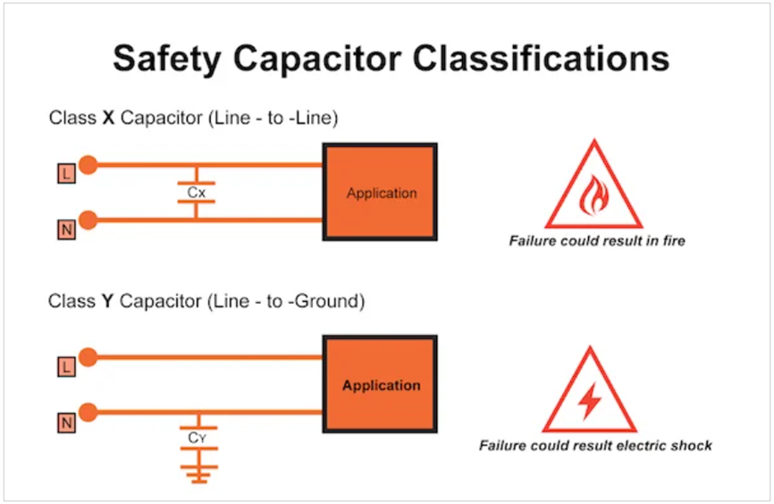

Using X- and Y-Capacitors for Safety and Suppressing EMI Noise
Class-X and Class-Y capacitors are commonly designed for filtering noise from the AC power line (mains) that supplies electric and electronic equipment. They are identified as X-capacitors (CX) or Y-capacitors (CY) depending on the type of noise they help to filter.  CX, located between line and neutral, inhibits the SMPS from introducing differential mode interference. CY-capacitors are connected between the power line and the main ground plane, or chassis of the SMPS, and filter out common-mode noise.  X- and Y-capacitors are located in the EMI filter before the rectifying stage in the SMPS. Protecting the SMPS from the AC mains and vice-versa adds both EMI filtering and safety.
X-capacitors commonly referred to as “line to line” or “across the line” capacitors, Class-X capacitors are used to minimize EMI/RFI that may be caused by differential mode noise in an AC power supply. Class-X capacitors are placed across the line and neutral connections to mitigate negative effects that may be caused by conducted interference, overvoltage surges, and voltage transients. But in order to provide a clean AC signal to the circuit they serve, Class-X capacitors are subject to all of the AC line variations which can create a hazardous situation if the voltage or power threshold of the capacitor’s capabilities are exceeded. In an over-stress situation, Class-X capacitors are designed to fail short-circuit, in order to trigger the circuit breaker or fuse to break the supply circuit. However, if the overcurrent protection devices are not fitted or fail to react, a Class-X capacitor presents a significant fire risk.
Y-capacitors are typically constructed of metalized polypropylene film, impregnated paper, or ceramic dielectric technology. Metalized film and paper capacitors have excellent self-healing properties and can recover from short circuit events and avoid more critical catastrophic failures by typically failing as an open-mode circuit. On the contrary, ceramic capacitors can become unstable with temperatures and time and have no self-healing properties. Ceramic capacitors also tend to short circuit. Since EMI has been always a fundamental difficulty when converting power or integrating different systems, filtering is a primary tool in a designer’s toolbox.
Class-Y Capacitors are commonly referred to as “line to the ground” or “line bypass” capacitors. Class-Y capacitors are typically placed in between the AC supply and ground, to handle EMI/RF noise caused by common-mode noise. Class-Y capacitors are also subject to AC line variations via conducted interference, overvoltage surges, and voltage transients, which can also lead to hazardous situations if the threshold of the capacitor’s capabilities is exceeded and the capacitor fails. Class-Y capacitors are designed to fail open-circuit which, different from Class-X capacitors, results in subjecting the circuit to an unfiltered AC power source. However, the risk of fire is reduced.

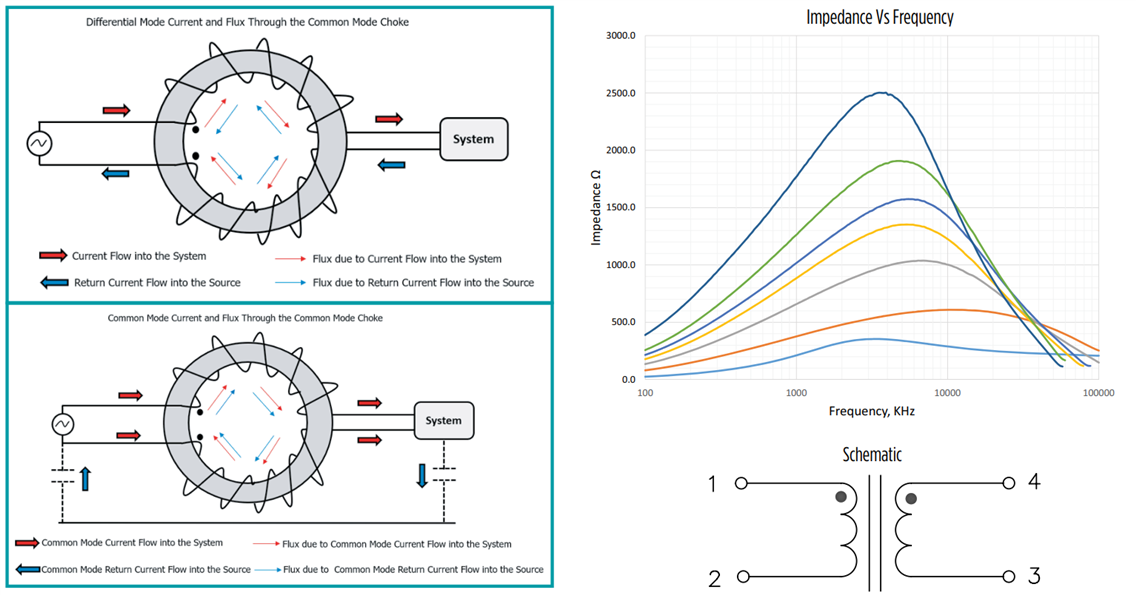

Characteristics & Measuring of common-mode chokes
An ideal common-mode choke eliminates all the common-mode noise (infinite common impedance) and will let all the differential signals pass through it (null differential impedance). In the real world, there are limitations with both characteristics, so it is important to know the application and its frequency characteristics to choose the right choke. As introduced before, the impedance presented to common-mode signals is known as common impedance, while the one presented to differential signals is known as differential impedance. The measure of both parameters can be done using a network analyzer. For each of the frequency response measurements, inputs and outputs of common-mode chokes need to be short-circuited as follows shown in the picture below.
Left: common-mode measurement.              Right: Differential-mode measurement.
Datasheets usually include curves with both common-mode and differential-mode impedances and they are normally indicated in logarithmic scale [dB], providing information about the attenuation they produce to common-mode and differential-mode signals circulating through chokes.
Fig: Common- vs. differential-mode attenuation of a common-mode choke.

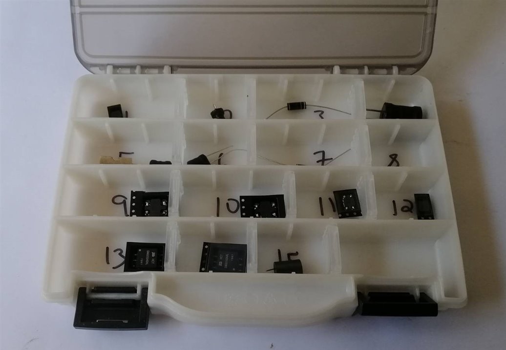

Common Mode Chokes in the Bourns Magnetic Components Kit

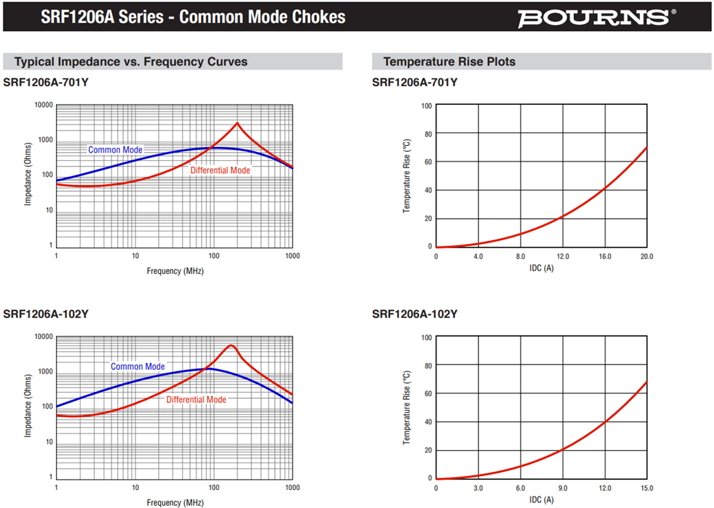

The free Magnetic Components Kit from Bourns contains several Bourns Common Mode Chokes. I choose the 12.5uH and 9uH, 8A chokes for the EMI filter I am going to design. The general specifications and frequency response for the Common Mode Chokes are well explained in the datasheet. I added a screenshot below from the datasheet. These shielded chokes are well suited for power line noise and EMI suppression.
Measuring Bourns Common Mode Chokes
The Bourns free Kit contains 4 common mode choke with different values. I am going to use two for my two-stage EMI filters.
List of the common mode choke I am going to use:
1. SRF1206A-701Y (Choke, Common Mode, AEC-Q200, 9 µH, 8A, 700 ohm, 12 mm L x 11 mm W x 6 mm H)
Technical Datasheet (here)
2. SRF1206A-102Y (Choke, Common Mode, AEC-Q200, 12.5 µH, 6A, 1 Kohm, 12 mm L x 11 mm W x 6 mm H)

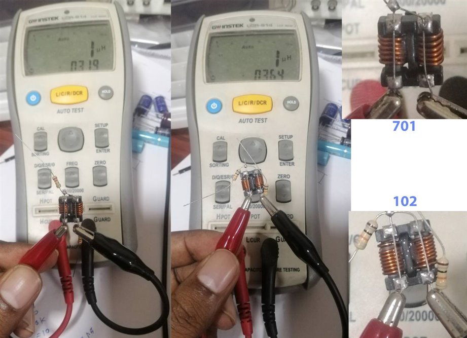

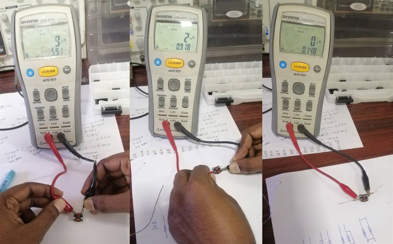

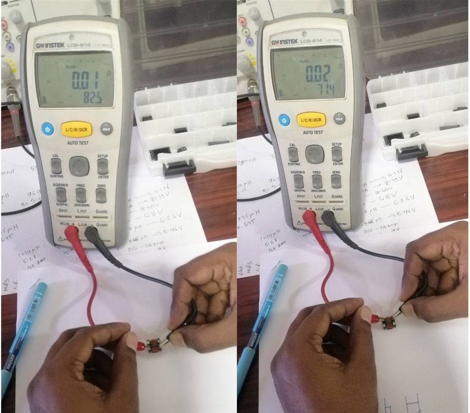

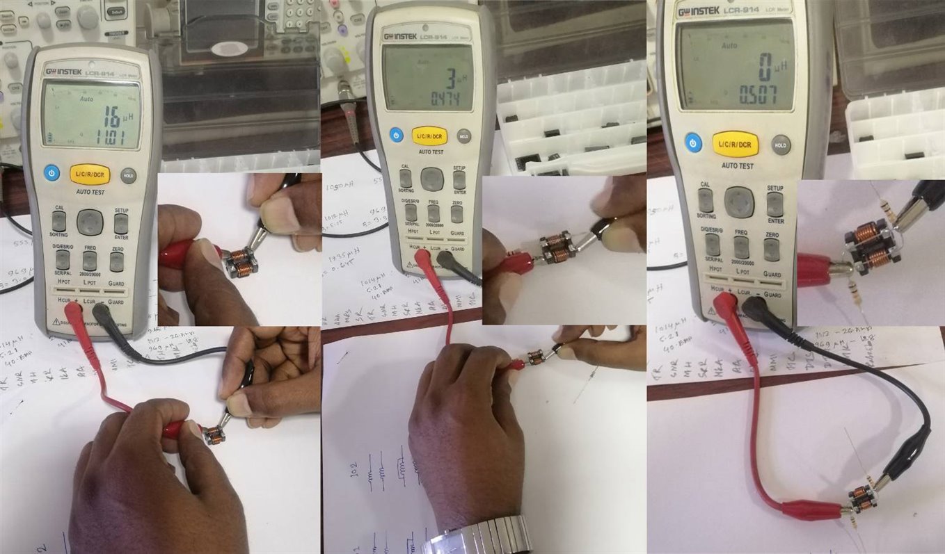

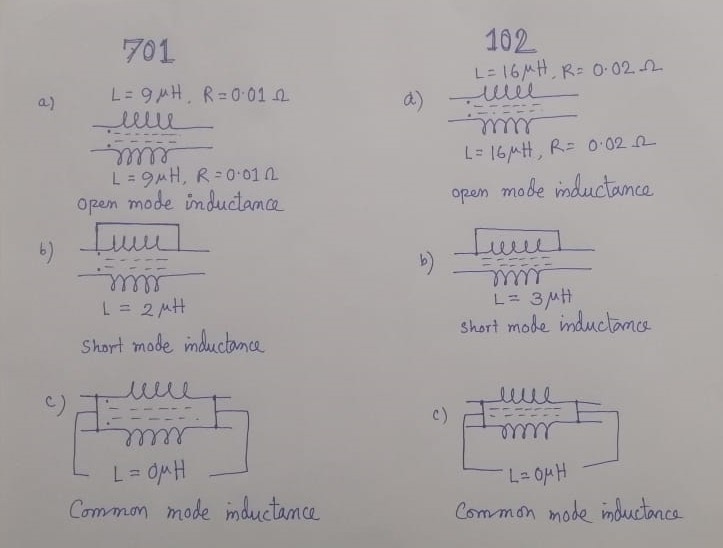

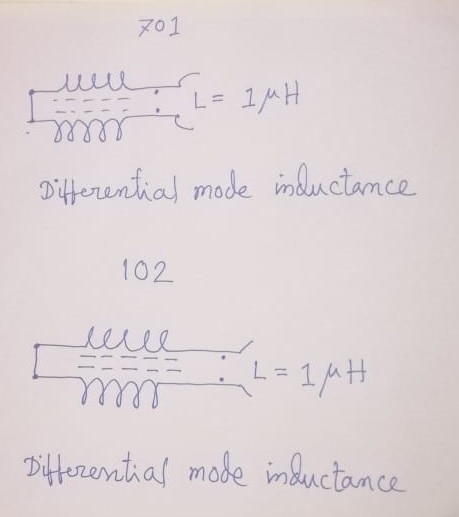

I used an LCR meter to measure the actual inductance and resistance of the chokes. For shorting the inductor I soldered a resistor's lead.
701
102
Chokes resistance measurement
The measurement result:
Though the performance of a common mode choke depends on several factors, from our simple measurement it is clear that Bourns Common Mode Chokes are very accurate and perfect for common-mode noise reduction.

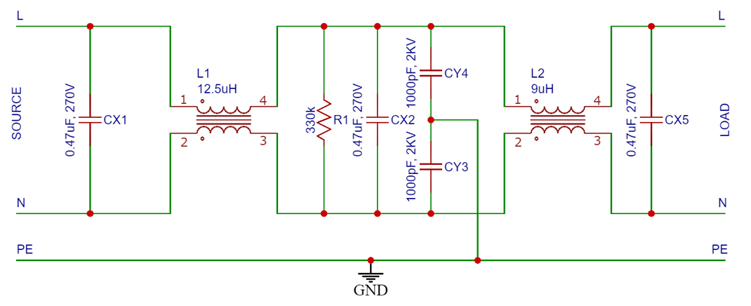

The circuit I made is a dual-stage EMI filter. EMI Filters are widely used in applications such as Appliances, Military systems, Aerospace systems, SMPS, VFD drives, AC Servo drives,  Energy Management Systems, Computers, Factory Automation Equipment, Industrial Equipment, Medical Equipment, Automotive Battery Charger. As already explained EMI circuit normally consists of passive components, including capacitors and common mode inductors, connected together to form LC circuits.
The common-mode inductor(s) allow DC or low-frequency currents to pass through while blocking the harmful unwanted high-frequency currents.   The capacitors provide a low impedance path to divert the high-frequency noise away from the input of the filter, either back into the device, or into the ground connection. In addition to assisting to meet EMI regulations, the filter also has to meet safety standards.
The inductor temperature rise is measured and for mains operation, the minimum electrical spacing between line, neutral, and ground are controlled.  This reduces the risk of fire and electrical shock.
The value of inductors and capacitors can be selected as per power requirements. The following figure represents the circuit diagram of my custom EMI filter where,
  • The source AC 100V to 250V AC Input Single Phase
  • Maximum Load current up to 8 Amps
This is a dual-stage EMI filter. For some special occasion like the EMI noise is serious, the performance of EMI filter is usually poor and the value of inductance or capacitance is usually large and performance may not meet the requirements by increasing the inductance or capacitance value. Because the obtainment of large inductance and capacitance is very difficult, the multi-stage EMI filter is widely used in this condition.
Components
  • Capacitor CY4, CY3: 1K PF 2KV ( 2000V)
  • Capacitor CX1, CX2, CX5: 0.47uF 270V AC X2
  • R1: 330K for Inrush Current Protection
  • Common Mode Inductor ( Choke): L1, L2: 12.5uH and 9uH 8Amps  (SRF1206A Series - Common Mode Chokes)
The across-the-line capacitors CX1, CX2, and CX3 (X-capacitor) suppress differential mode noise. Line bypass capacitors CY3 and CY4 (Y-capacitor) suppress common-mode noise.

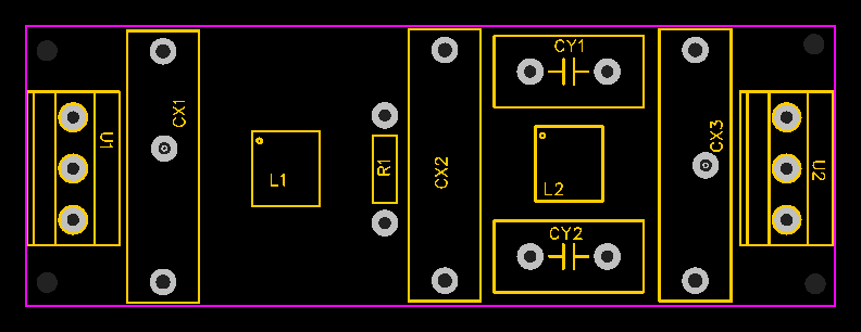

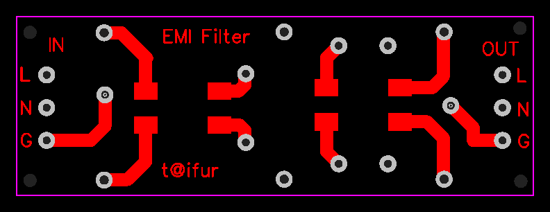

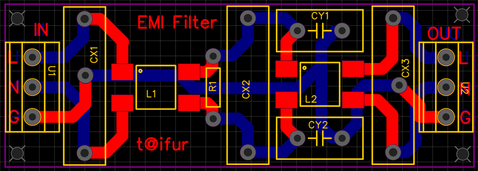

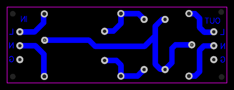

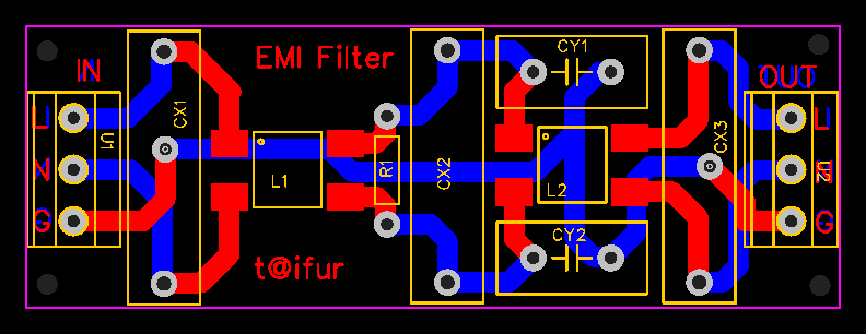

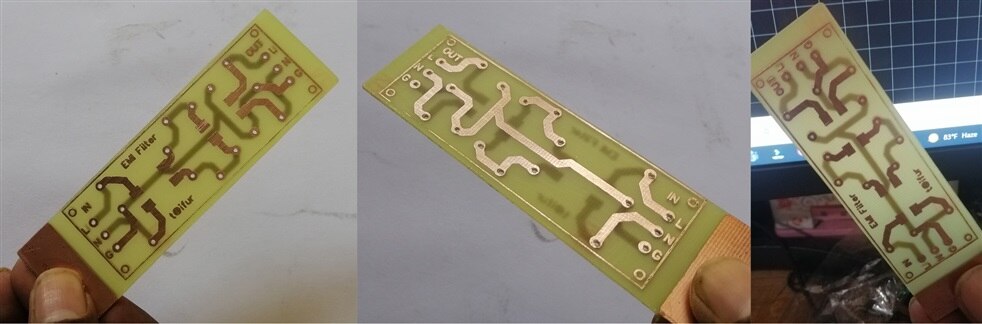

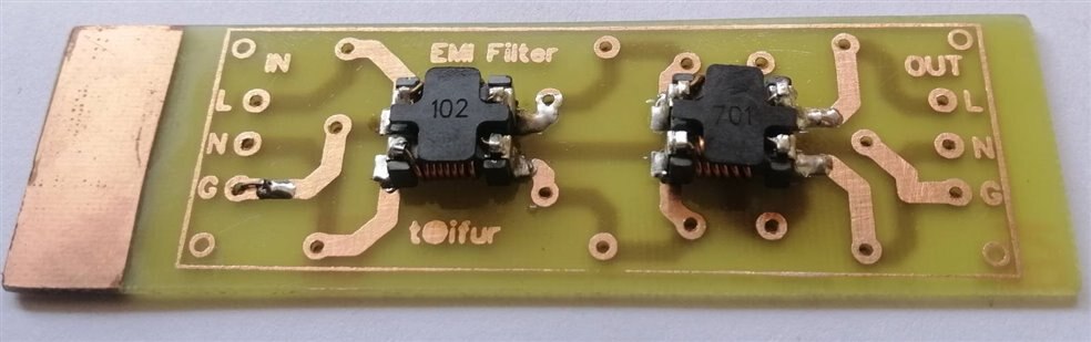

The PCB layout generated by EasyEDA for my EMI filter is given below.

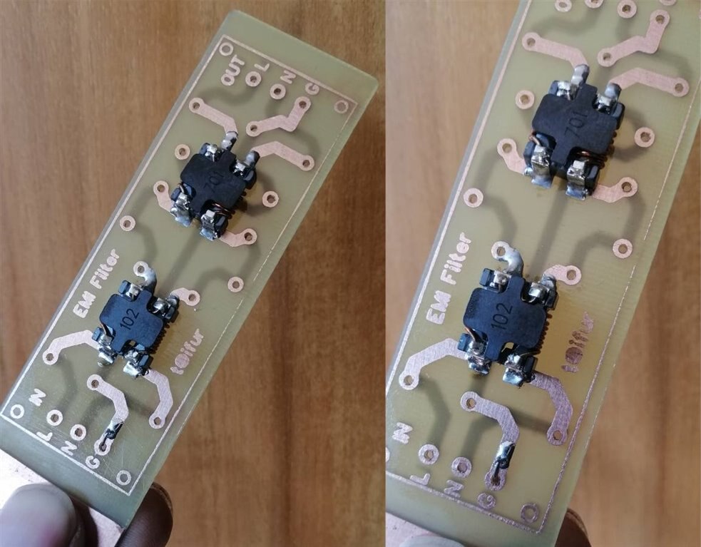

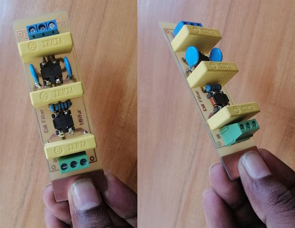

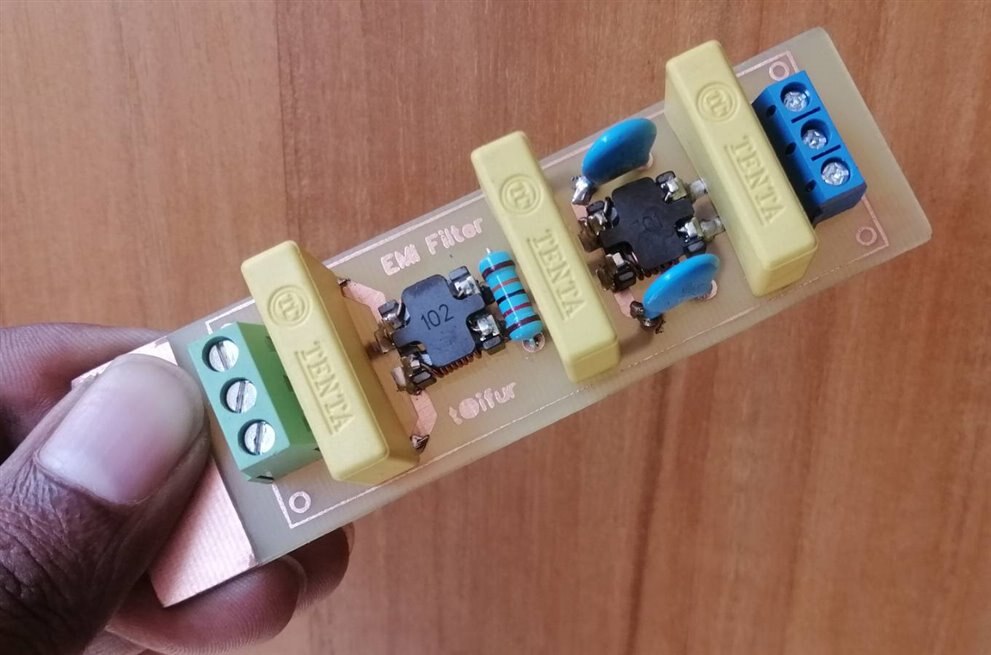

As the time is short and professional PCB ordering takes time I made a copy of the PCB by toner transfer method. This is a double-layer PCB made of fiberglass.
After making the PCB first I soldered two SMD common mode chokes I choose from the kit. It is always a good idea to solder smaller and SMD components first.

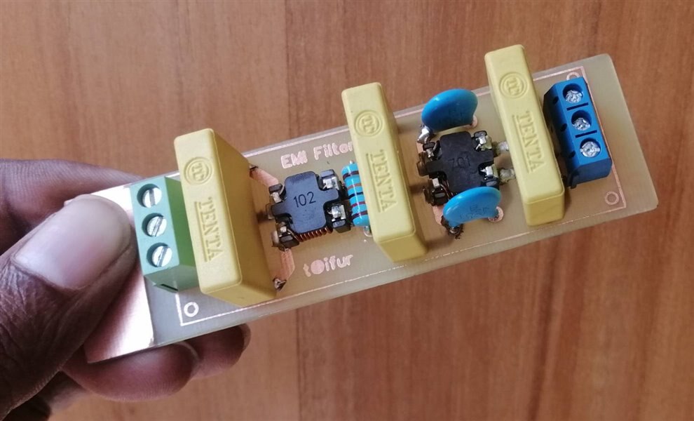

Then, I soldered other components like X-capacitors, Y-capacitors, and screw terminals. Images of the top view and side view are attached below.
In the circuit, a 1 W high value resistor is connected to the parallel to the X-capacitor. In high voltage power supplies, often very high value resistors are connected across energy storage capacitors to make very sure they discharge after the power is off for a while. Even if you short such a cap briefly, dangerous voltages can reappear after a few minutes due to capacitor chemistry. So, this resistor can protect from any accidental shock.

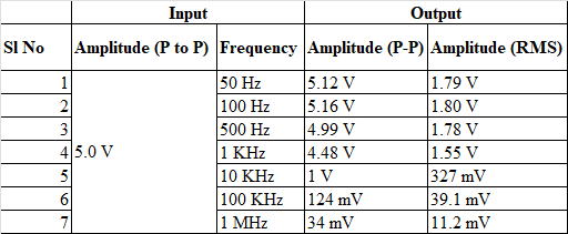

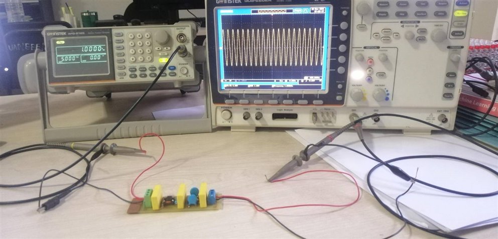

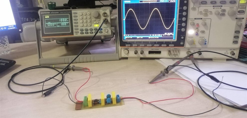

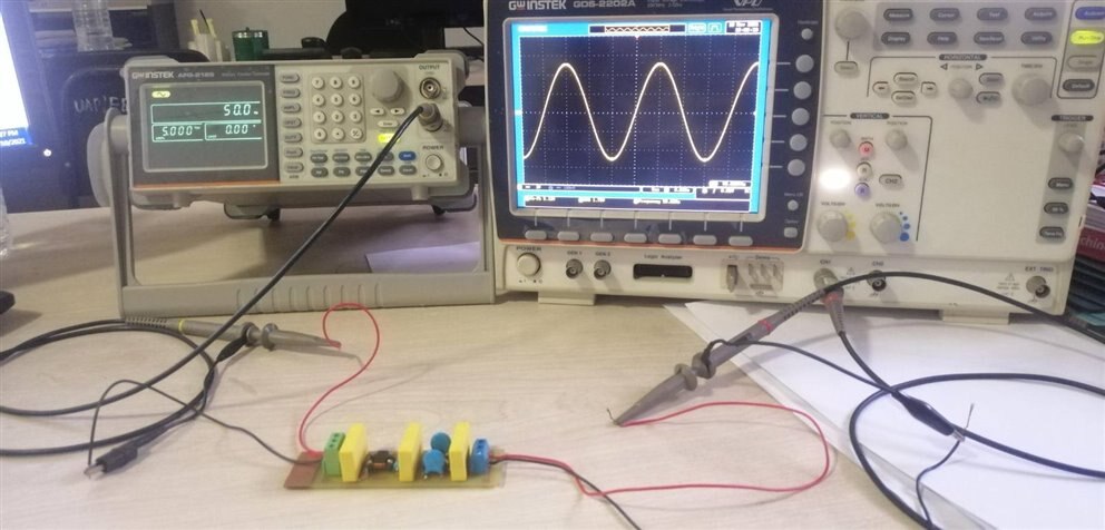

Now, it is the phase of testing. I used a function generator and oscilloscope to test and observe the filter response at different frequency signals. I started from the common line frequency of 50 Hz and set the amplitude of 5V peak to peak. For 50 and 60 Hz signals, the output signal amplitude is exactly the same as the input signal amplitude. So there is no attenuation of the power frequency signal.

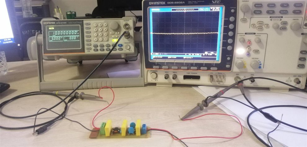

For a 1KHz signal, the input is reduced by 10%. For a 10KHz signal output is very low. It's around 1V. So, it is reduced by 80%. The cutoff frequency is in between these 2 frequencies which is very expected.
For a 100KHz or 0.1MHz signal, the output is almost diminished. So, it is perfectly suppressing the EMI noise.
Oscilloscope graphs for all the frequencies are attached below.
This is the filter output for the square wave. The figure shows the wave with the FFT.
Output for the DC input is shown below with the FFT.
The findings for different frequencies are added in the table below.
This is a sample demo video of the experiment.

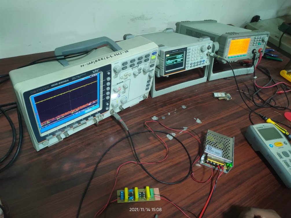

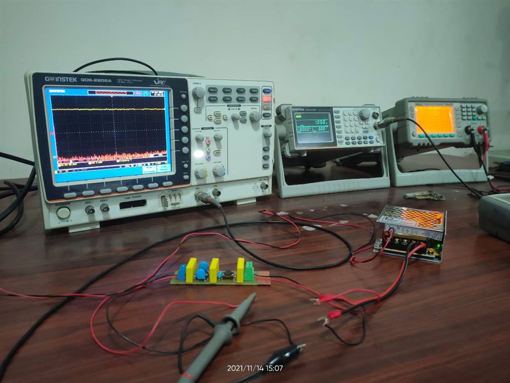

Testing With SMPS
This EMI filter can be used in both AC and DC systems. I tested the filter with a 5V low price Switch Mode Power Supply. I experimented the filter by connecting it to the input side as well as the output side of the power supply. The following two images show the power supply output when the filter was connected to the 5V output of the power supply. We see there is still some noise in the output but it is very nominal.
The following snapshot was recorded without connecting the EMI filter to the power supply.  From the oscilloscope FFT analysis, a big spike at high frequency was observed which is marked as a blue rectangle in the following image. I am not sure from where this noise is coming but interestingly it was removed after connecting the EMI filter to the output of the power supply.
The following image was taken when the filter was connected to the power supply and it is clear that the high-frequency noise is suppressed to a great extent. In this image, the FFT signal is zoomed so that it can be observed clearly.
Observation
  • I found better results by connecting the EMI filter to the output of the power supply.
  • I did not observe any big improvement when connecting the filter to the input of the power supply. Maybe this is for the reason that, the power supply already has a built-in EMI filter in the input.
  • A two-stage EMI filter shows better results than a single-stage filter.
  • In the case of a two-stage EMI filter, two identical common mode chokes can show better results than two different common-mode chokes. I could not test it because the Kit includes only one inductor per type.
  • Maybe an EMI filter is not capable to reduce all noise to zero. (It is only my understanding, I may be wrong!)
  • A switching power supply should have an EMI filter built-in.
