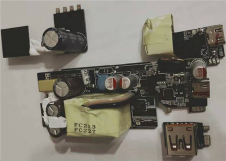

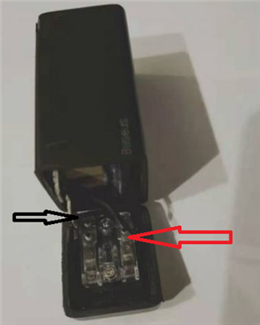

First, cut from one end with hand saw carefully since it is hot-welded without any screw.

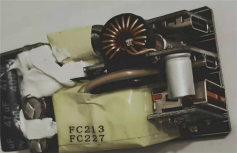

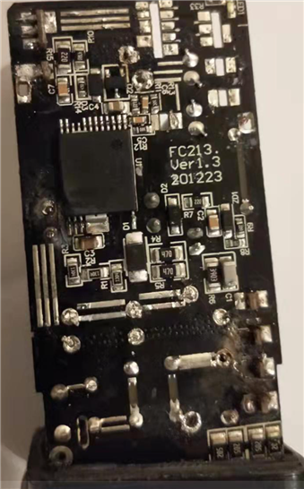

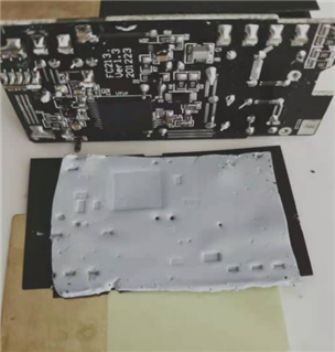

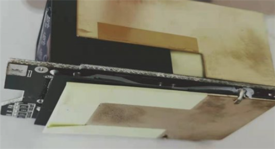

Take out the fully copper covered PCB. Higher DC power frequency means more challenges on EMC and heat dissipation. With natural cooling, silicon-gel plays important roles.
I have remove every parts with hot wind gun to study the circuit. I need to put them back for this experiment.

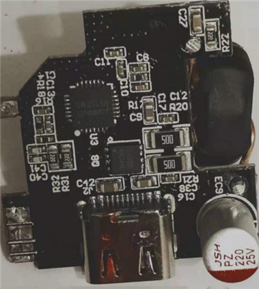

This is daughter board for fast charging control, with SW3518 from Ismartware, refer to http://www.ismartware.com/
Max power delivery PD for 45W with 18W for normal charging port.

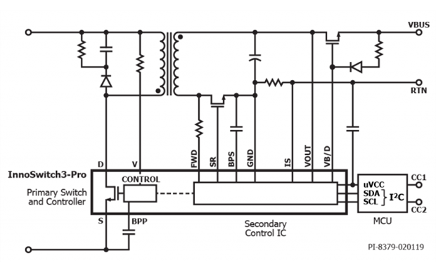

Power conversion part from AC to DC is PI SC1933, unfortunately, this is off-book from the official web. I have checked and assumed that new innoswitch3-pro series is new brand. refer to https://www.powerint.cn/products/innoswitch/innoswitch3-pro for more detail introduction. This is one GaN power delivery control chip integrated Power electronics and microchip to control with I2C. It takes more time, I can find how the I2C work with analyser, that would be perfect to make one smart DC Power bench with this retro-GaN charger. Here is the application diagram for PI Innoswith3-pro.

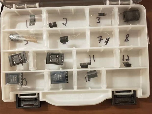

Here is the type of Choke, Inductor and CMC as listed. Except that Item 8 is missing.
Item 9-12,

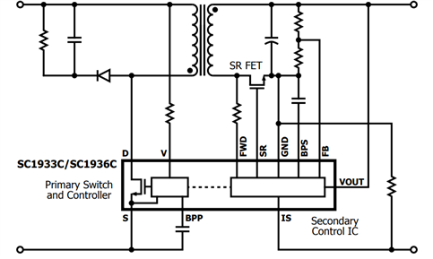

Here is the circuit to be used , the GaN charger main board.
This is the proposed circuit for PI SC1933, similar to inno-switch3-pro,

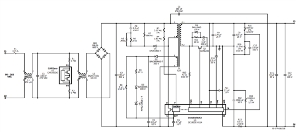

typical design for notebook power shall be,
we can see there are two stage CMC used. But this circuit uses only one CMC.

Unfortunately, during the experiment, the secondary winding of pulse transformer was short-circuited by probe of oscilloscope, the PCB is damaged.
This could have been avoided if test point was set in advanced in compact commercial products.

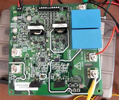

The experiment on CMC is not completed. I shall experiment this component in platform much better like Rohm SiC MOSFET"P02SCT3040KR-EVK-001
That is half bridge evaluation board, need peripherals circuit to make experiments.

Proper selection of CMC can reduce the EMI, balancing the performance and cost is common in mass production. In this GaN charger, only one stage of CMC is used just before pulse transformer with primary voltage of AC 220V.
