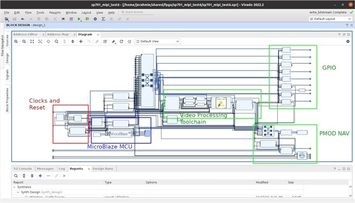

Logic Design, IP Layout, and Custom Logic Overview
At the top level, this is a microcontroller-based system with supporting digital logic to interface with the PCAM 5C and the PMOD NAV IMU peripherals. The system state, the VLAM algorithms, as well as all external communications will be controlled by the, soft microcontroller. A combination of Xilinx IP as well as custom logic collect, filter, and process raw sensor module data to minimize the amount of work required of the microcontroller.
The SP701 has ample resources to implement a soft CPU core with required subsystems. I initially wanted to use an Arm Cortex M1 or M4 soft microcontroller as the basis for this project since I have more experience using Arm architecture from Zynq 7000 projects. The Arm Cortex M1 and M4 IP is available free of charge through Arm DesignStart FPGA program with access provided directly by Arm. While my early impressions of using the Arm core were promising, I ultimately decided to use a Xilinx MicroBlaze Soft Processor core. While this was my was my fist experience using a MicroBlaze core, I was able to get up and running up and running quickly thanks to a wide selection of documentation and examples provided by Xilinx.
Since the PMOD 5C camera implements the MIPI CSI-2 standard, I was able to leverage Xilinx IP to capture and process image data. The MIPI CSI-2 Receiver Subsystem module consists of a MIPI PHY module for interfacing to the camera module. And the output is an AXI-stream video data signal that undergoes further signal processing. A custom logic block to perform the visual odometry is still under development. The is a custom Verilog block that will take the AXI-stream video signal as input and the output is an estimated distance (dx, dy).
The final custom logic block is the PMOD NAV IMU module. This is another Verilog module that implements the SPI interface to provide orientation data for the sensor fusion algorithm. Digilent provides an IP module for the PMOD NAV IMU, however, the documentation states that it is for pre-Vitis versions of Vivado. I had concerns that I would not be able to use the IP as-is, and since the module supports a straight-forward SPI interface, I felt comfortable creating my own implementation.
My preference for RTL development is to use open source tools whenever possible. I use Icarus Verilog for module and testbench development. I then import the custom RTL components into the hardware design. After the Verilog components are finalized, the Verilog hardware can be exported to Vitis for software development.
