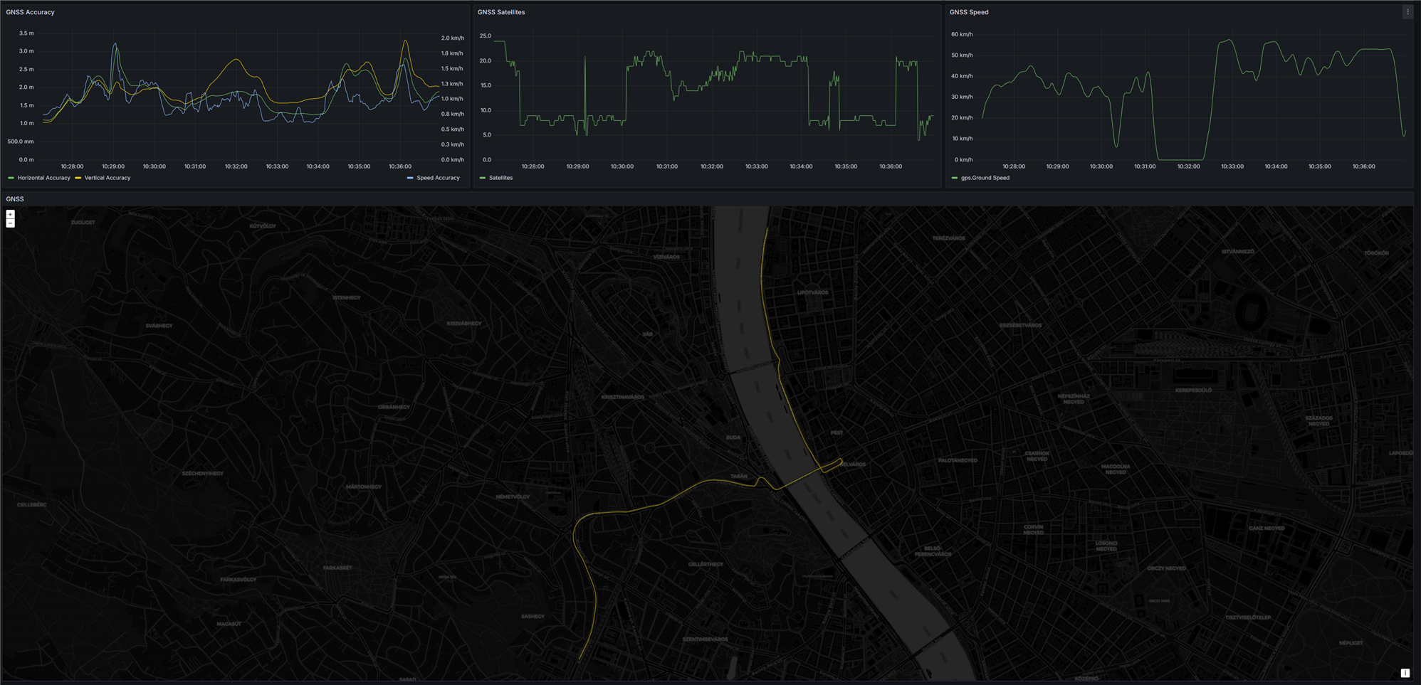

Various other monitoring systems are also provided, including GPS tracking and vehicle CAN bus sniffing.

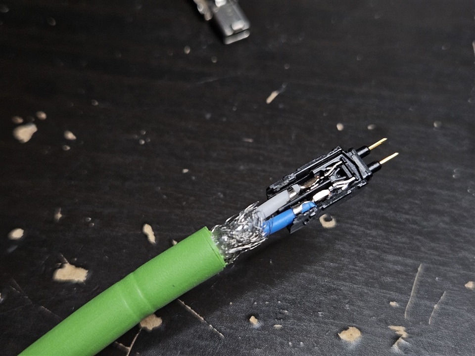

For such applications, there are a few important features needed in the communication link:
  • Isolation – while the entire setup will be sharing a common ground, it is still a good idea to have an isolated interface. Stray currents in sensitive, low noise data connections can mess things up and cause headaches. Pulling significant amps would also result in a ground offset, potentially destroying the signal. Isolation is technically overkill, but it is cheap insurance to make sure everything works perfectly.
  • Resiliency – the cable run between the Linux system and the power management module could be as long as 4 meters depending on where I end up positioning things, and the cables will be running alongside super noisy, high current wires. It is crucial that the link is robust, tolerates noise, and supports (relatively) long cable runs.
  • Simplicity – running gigabit ethernet over a fiber link would certainly meet both of the requirements above, but it’s not exactly simple, cheap, or designed for this purpose.
There are 3 reasonable options in my opinion, that fit the bill:
  • RS485: a full-duplex RS485 link would need two twisted pairs, and could be hooked up to a regular UART interface on a microcontroller. This option can essentially be thought of as making a regular UART/Serial interface reliable for long ranges and in high noise environments.
  • CAN bus: ubiquitous for exactly this sort of application. Requires only a single pair, fixes the downsides mentioned for RS485. The protocol itself is higher level, instead of sending individual bits, data is sent in messages, with a priority system, error detection, automatic retransmission, etc.
  • Single Pair Ethernet: even more advanced and faster than CAN bus. Still requires a single pair only, and can be used with an entire Ethernet stack. That means things like IP addressing, QoS, VLANs, flow control, etc.
SPE has the following upsides compared to CAN bus for my project:
  • Way more bandwidth available: 10x faster than classic CAN.
  • Competitive price: while a regular, non-isolated CAN PHY is cheaper, once isolation is required, a Single Pair Ethernet PHY and magnetics end up being roughly in the same price range as an isolated CAN transceiver and controller.
  • Much more features and options for high level protocols.
One disadvantage that could be a dealbreaker in some use cases: SPE (or, to be more precise, 10BASE-T1L, the version used in this challenge) is NOT a multi-drop bus. This means that a single physical bus can only connect two devices together, much like ‘regular’ Ethernet, and a switch is required to connect more than 2 devices together.
However, there is another SPE standard, 10BASE-T1S, which solves this exact problem, making SPE work just like CAN bus in this regard: multiple devices can be connected to a single, one pair bus, without any switches or other active devices.

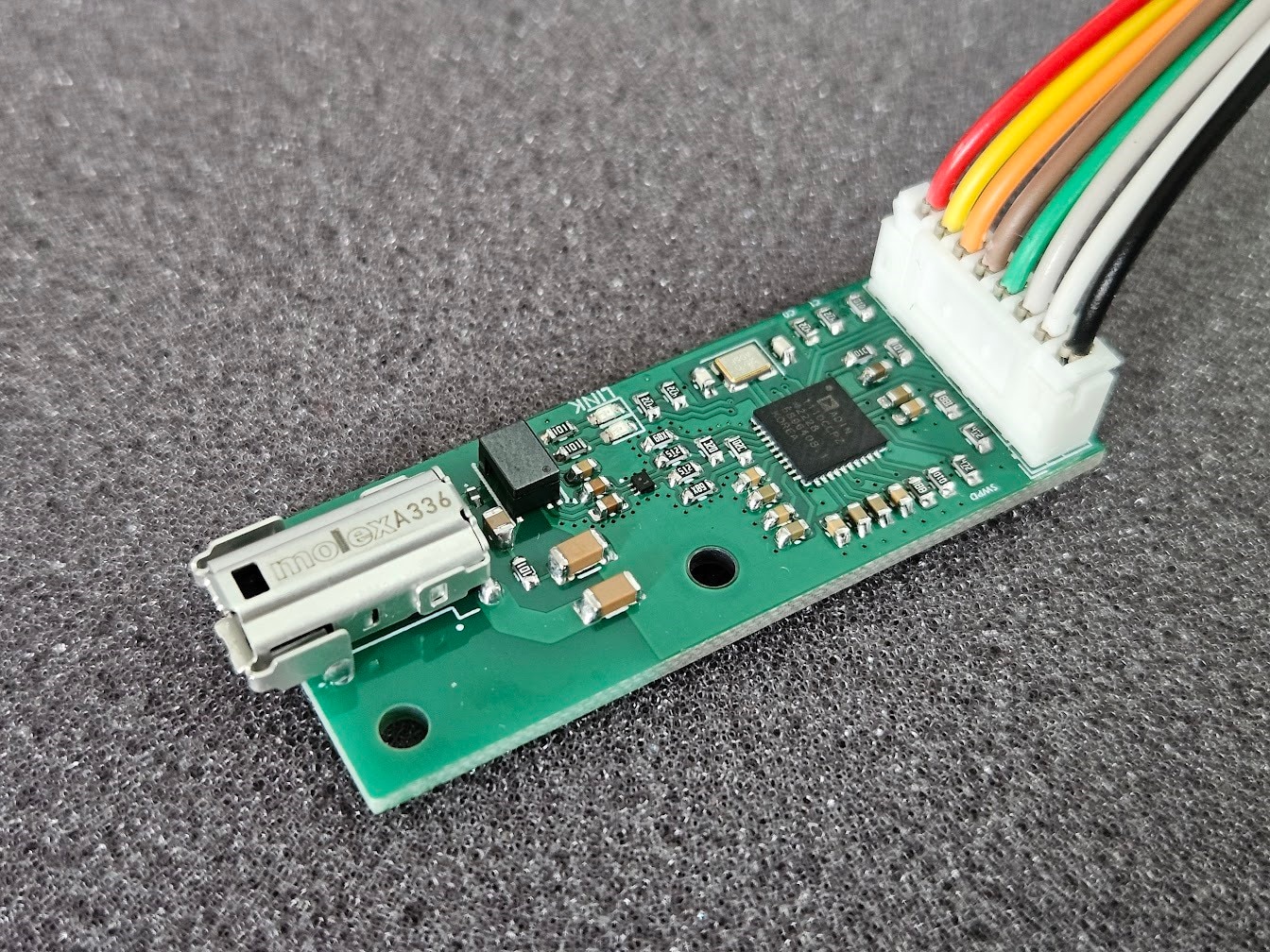

Cameras
The current setup uses four cameras.
  • The front camera is an ISX031 based, USB3.2 Gen 1 camera module
  • The left, right, and rear cameras are IMX662 based, USB2.0 camera modules
This setup provides a near 360 degree view of the vehicle.
The ISX031 sensor was chosen for the front camera for its extremely high dynamic range and low light sensitivity, along with the Sony tuned built-in ISP.
The IMX662 sensors are a clear downgrade from the ISX031, but the modules cost around 6 times less. They still have extreme low light sensitivity, but lack the subpixel HDR capability of the ISX031.

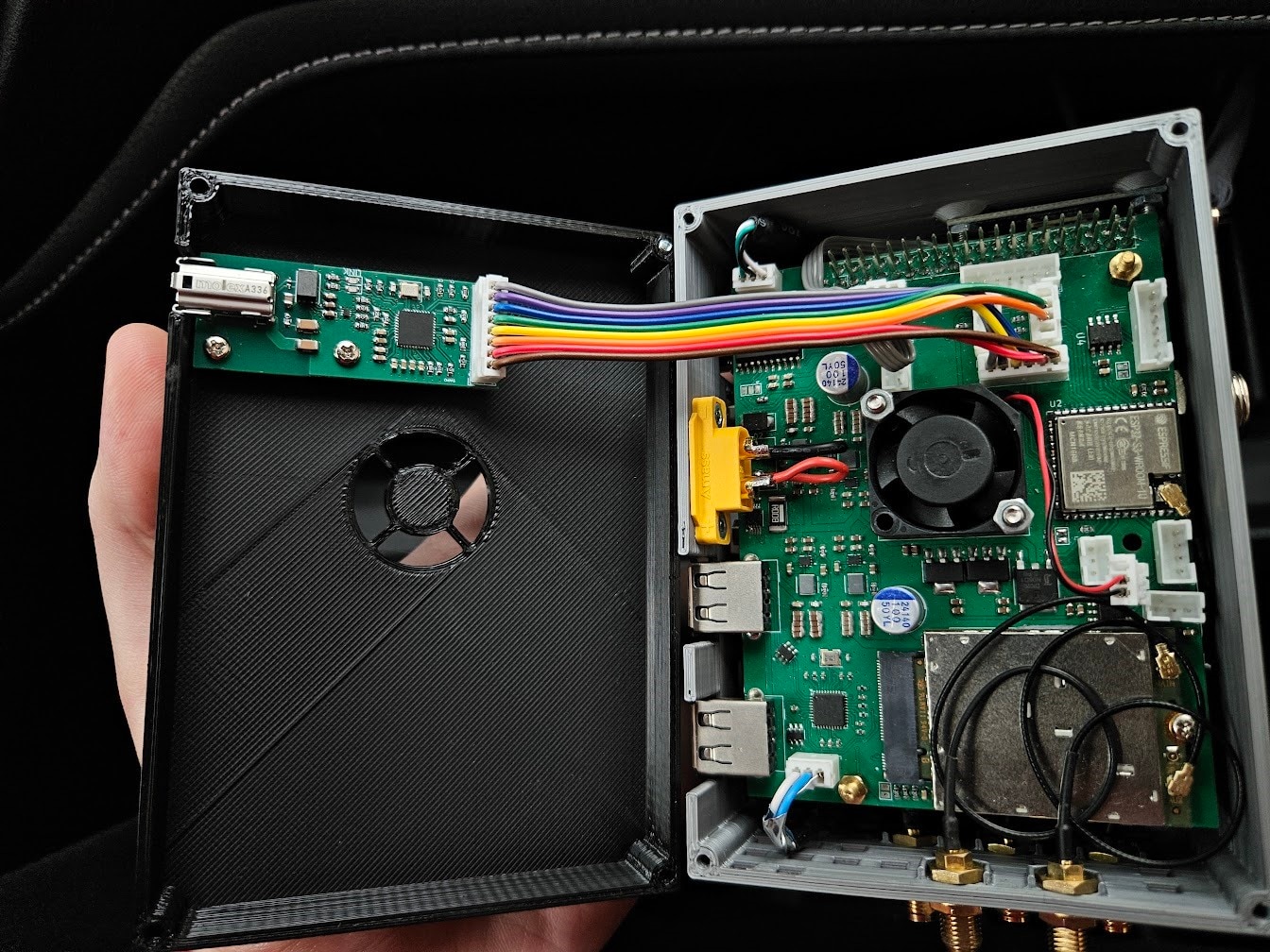

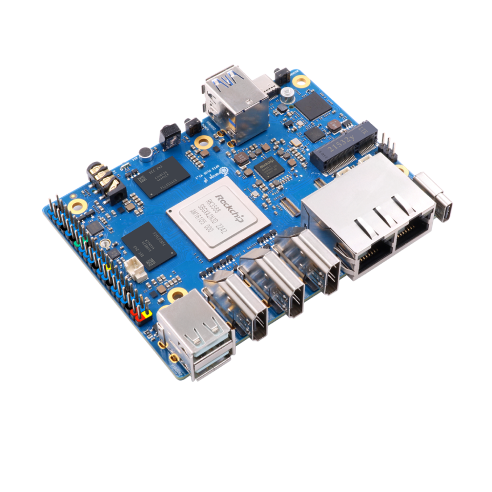

The heart of the system is the Compute Unit, located in the glovebox. At its core, it contains a Linux SBC and 4G modem, to ingest and process the video from the cameras, do H264/H265 compression, and send the resulting stream to the remote server over 4G.
The SoC choice was narrowed down to the Rockchip RK3588, for the following reasons:
  • It has 4x Cortex-A76 cores and 4x Cortex-A55 cores, powerful yet low power
  • An integrated hardware video encoder supports both H264 and H265
  • There is an NPU available for neural network acceleration

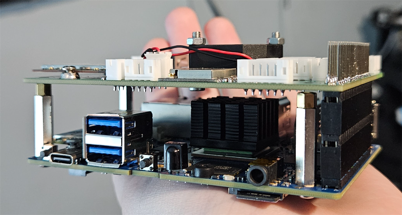

My final choice ended up being the Orange Pi 5 Plus, instead of using a SoM/Compute Module. The GPIO provides almost all interfaces required, and vastly simplifies PCB design.

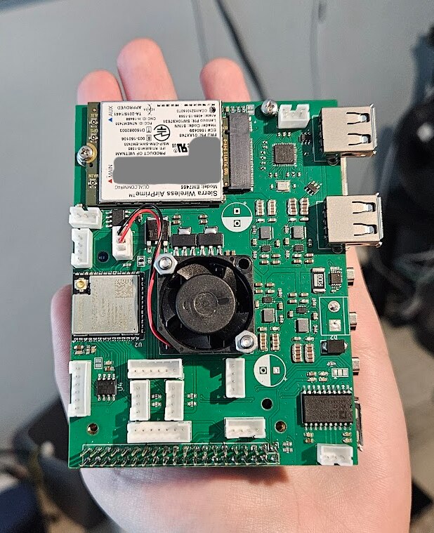

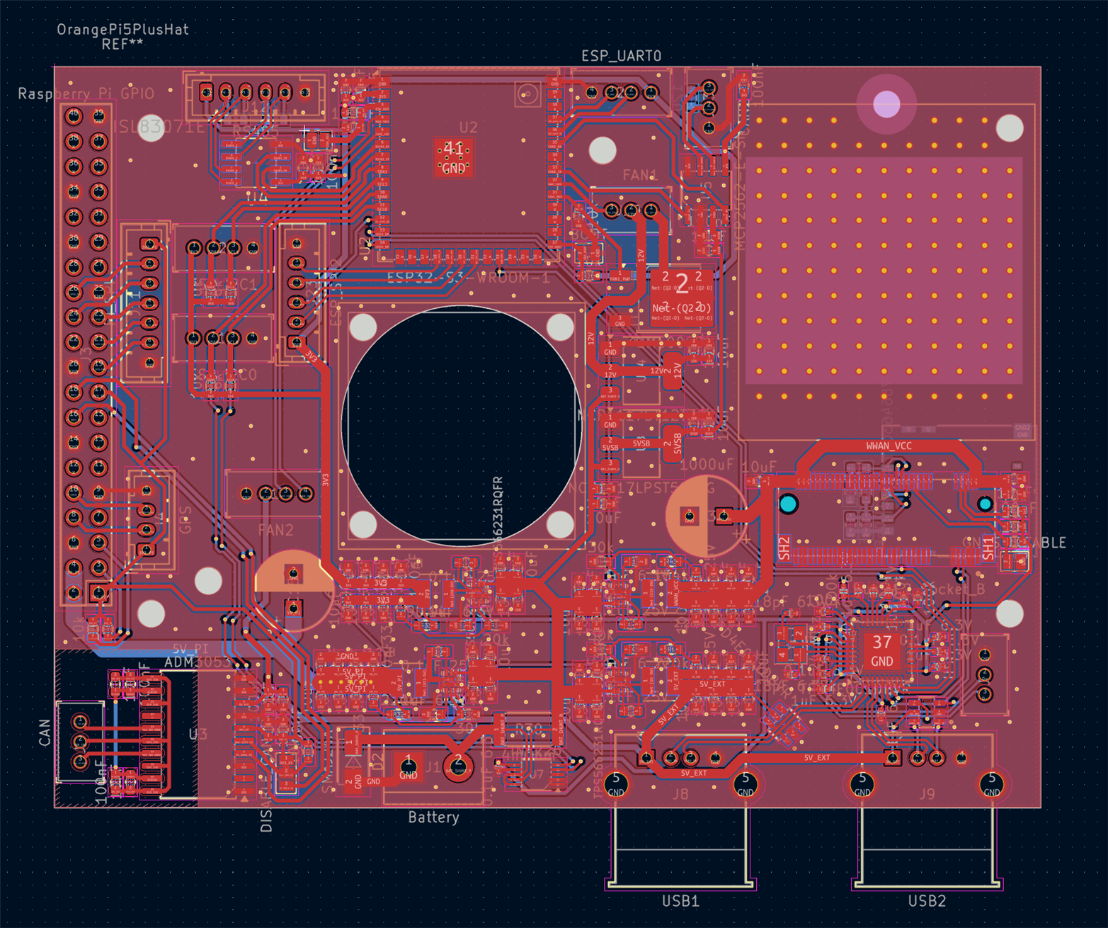

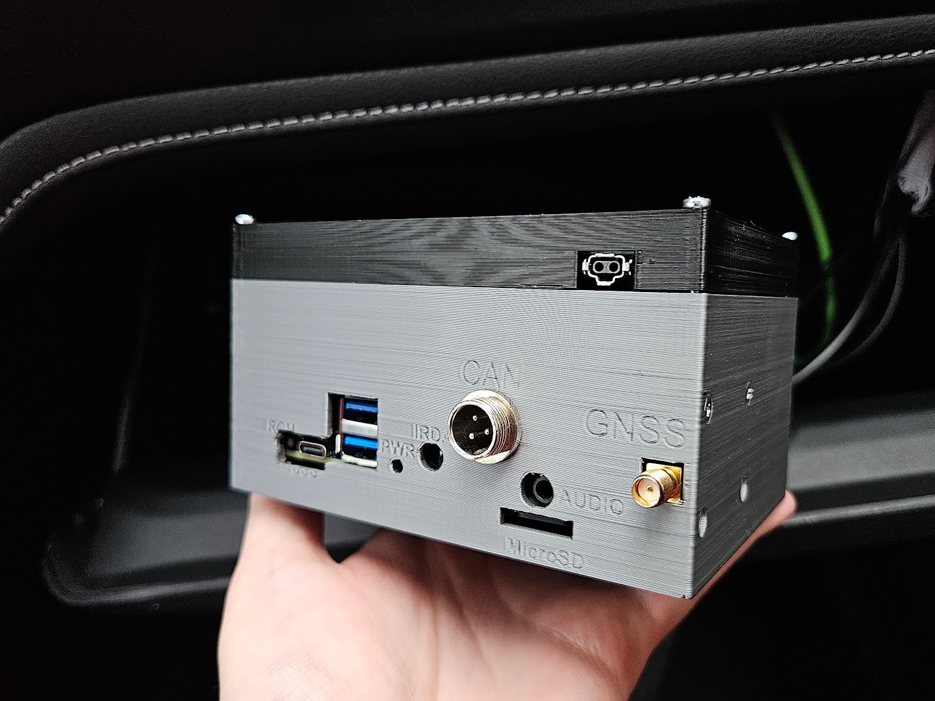

The custom HAT
The main responsibilities of the custom PCB on top of the Orange Pi 5 Plus are the following:
  • Accept a 12-15V input source
  • Generate voltage rails to power the Orange Pi 5 Plus, 4G modem, and various electronics on the HAT itself
  • Include a microcontroller to manage power and handle low level communication
  • Integrate the 4G modem

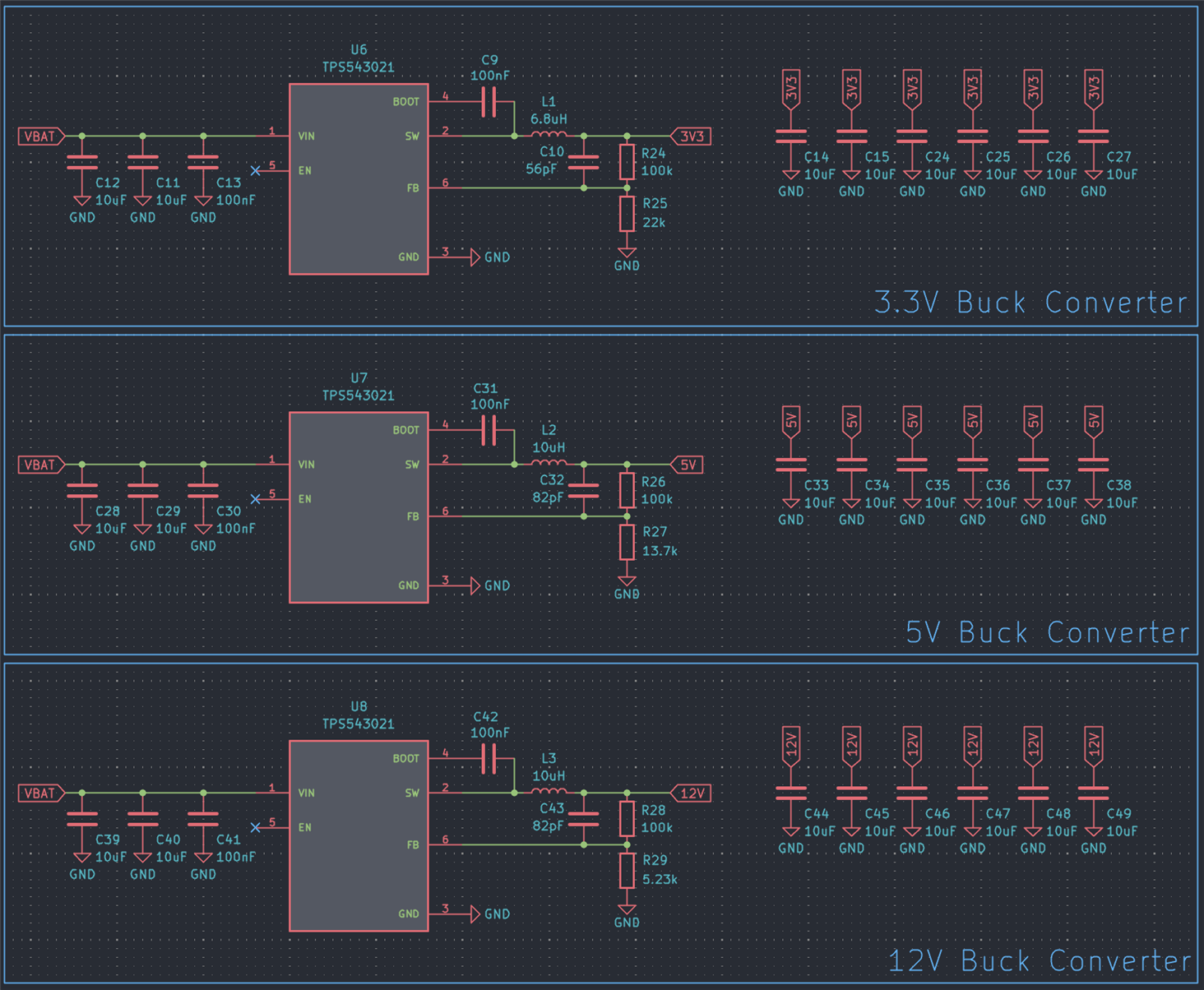

Four TPS566231 buck converter ICs are used to provide the voltage rails:

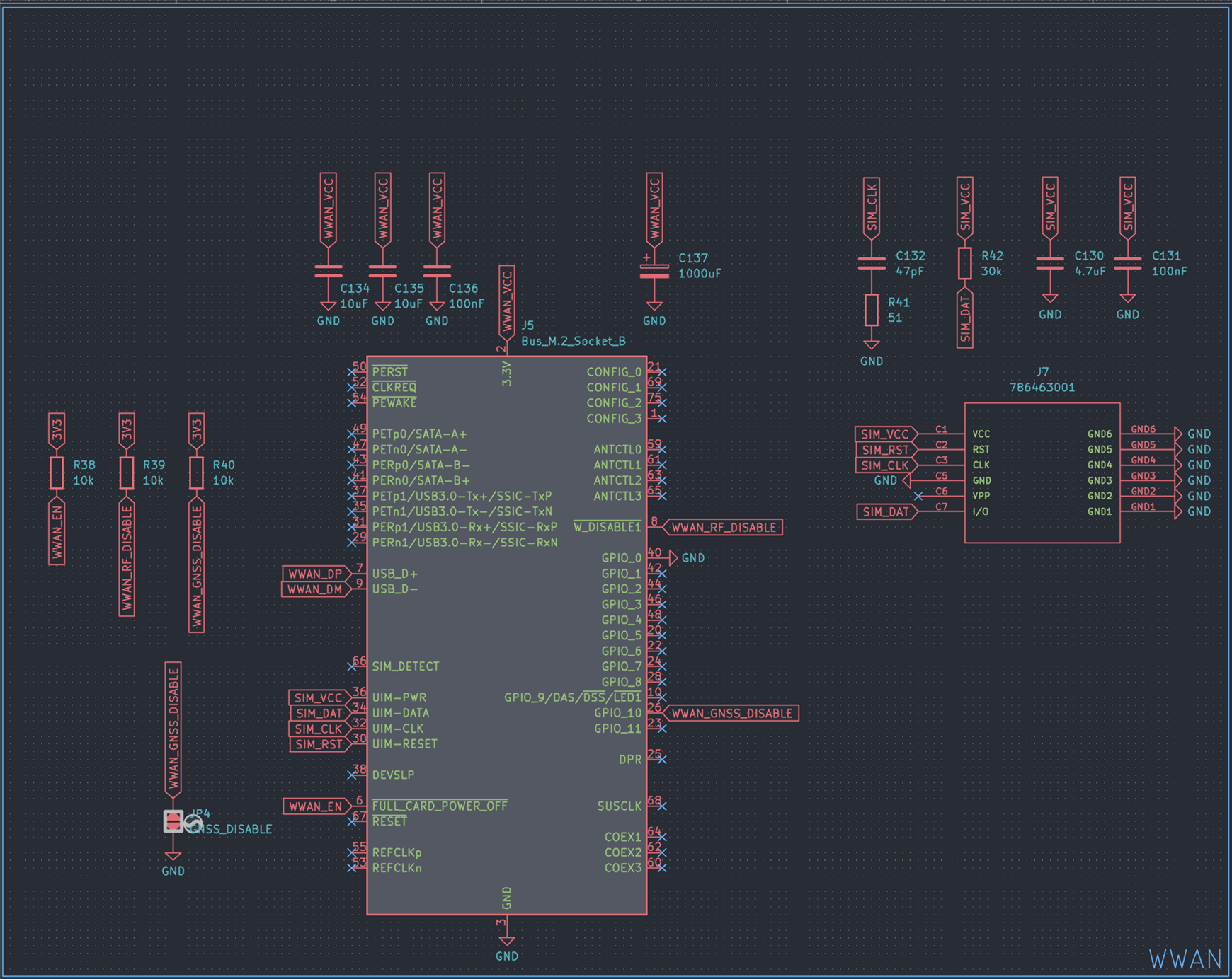

An EM7455 4G modem is used for network connectivity, as there are no reasonably priced better alternatives for the moment. The next meaningful step-up would be a 5G modem, but they are around 200USD, need PCIe, and 4 well matched antennas. The modem itself uses an M.2 B-key connector, but a SIM card slot is also needed. The modem supports USB3, but USB2 is sufficient for this use case, and avoids the USB3 routing and interference issues.

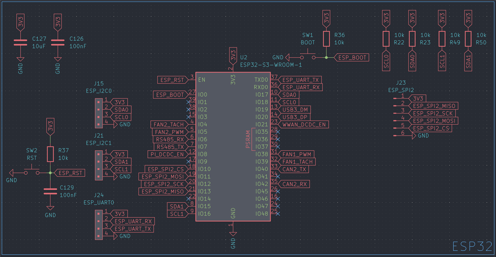

An ESP32-S3 was chosen to control power management and handle communication with various subsystems.

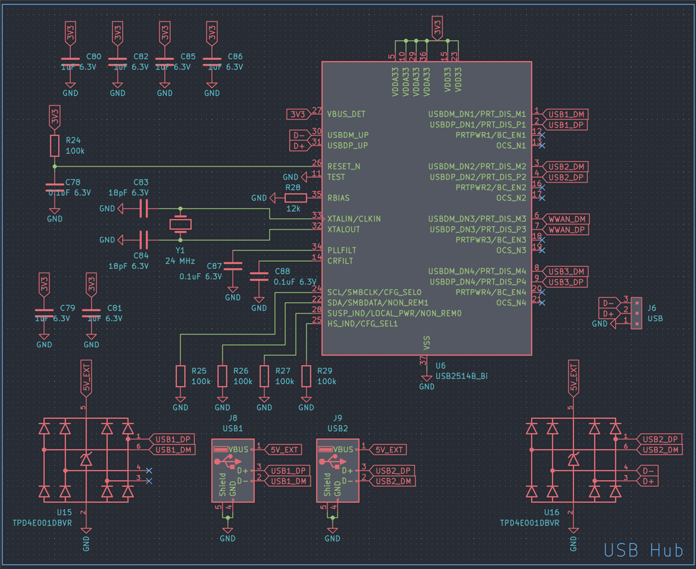

An onboard USB hub, specifically a USB2514B was added, so the entire HAT only needs a single USB2 uplink to the Orange Pi 5 Plus.

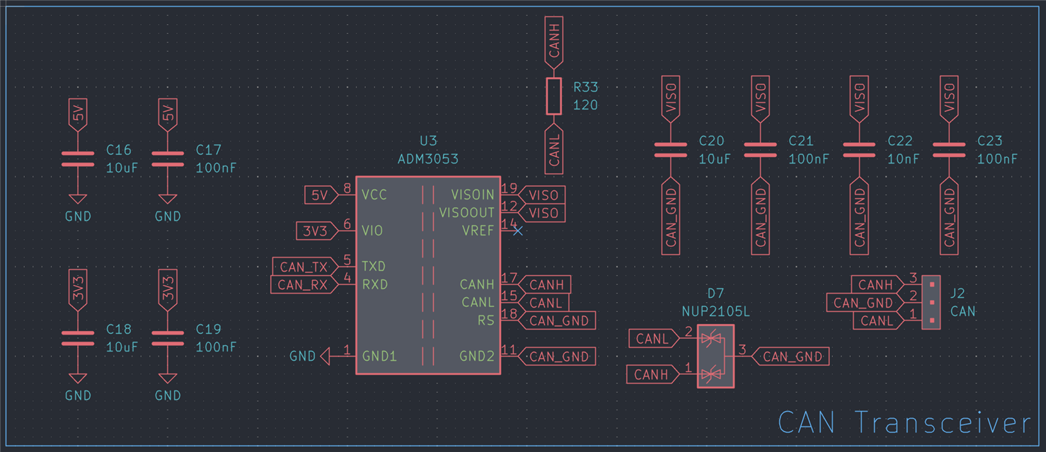

Various interfacing options were added, including RS485, dual CAN transceivers, and a header to connect an ADIN1110 Single Pair Ethernet MAC + transceiver.

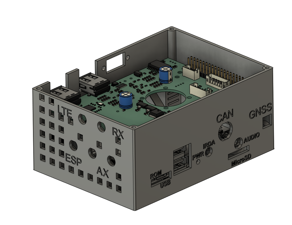

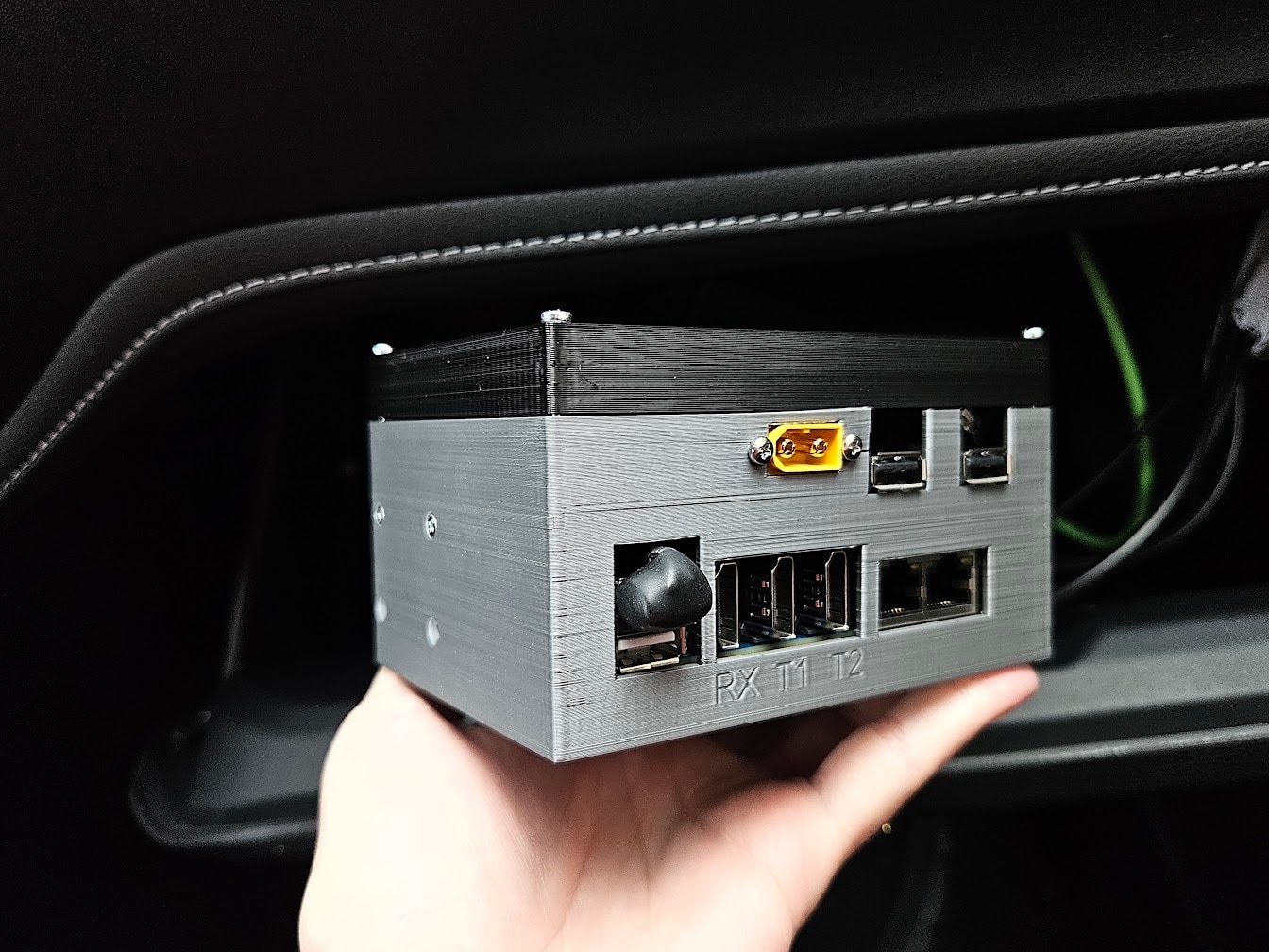

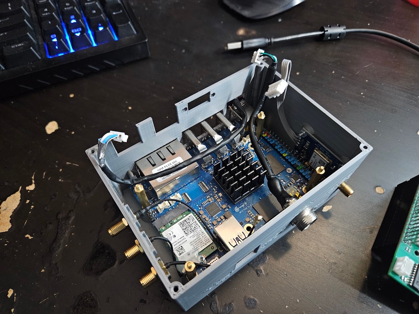

The whole setup was squeezed into a rectangle matching the dimensions of the Orange Pi 5 Plus.

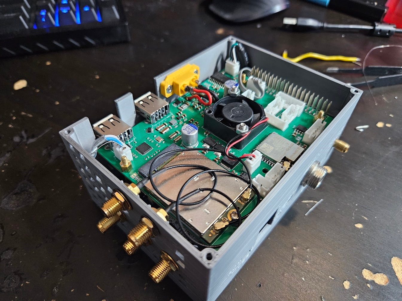

An Intel AX200 WiFi + Bluetooth card was added to the Orange Pi 5 Plus, along with a u-blox Neo M8N GNSS module.

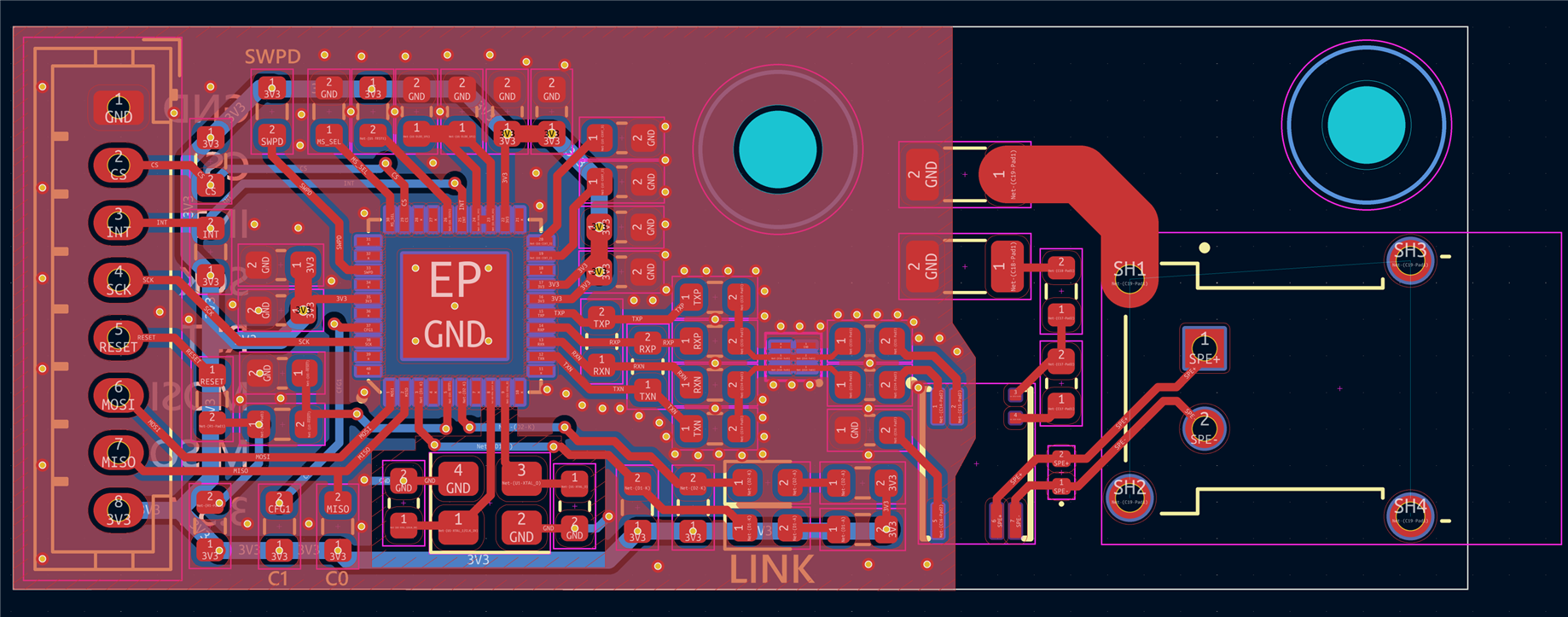

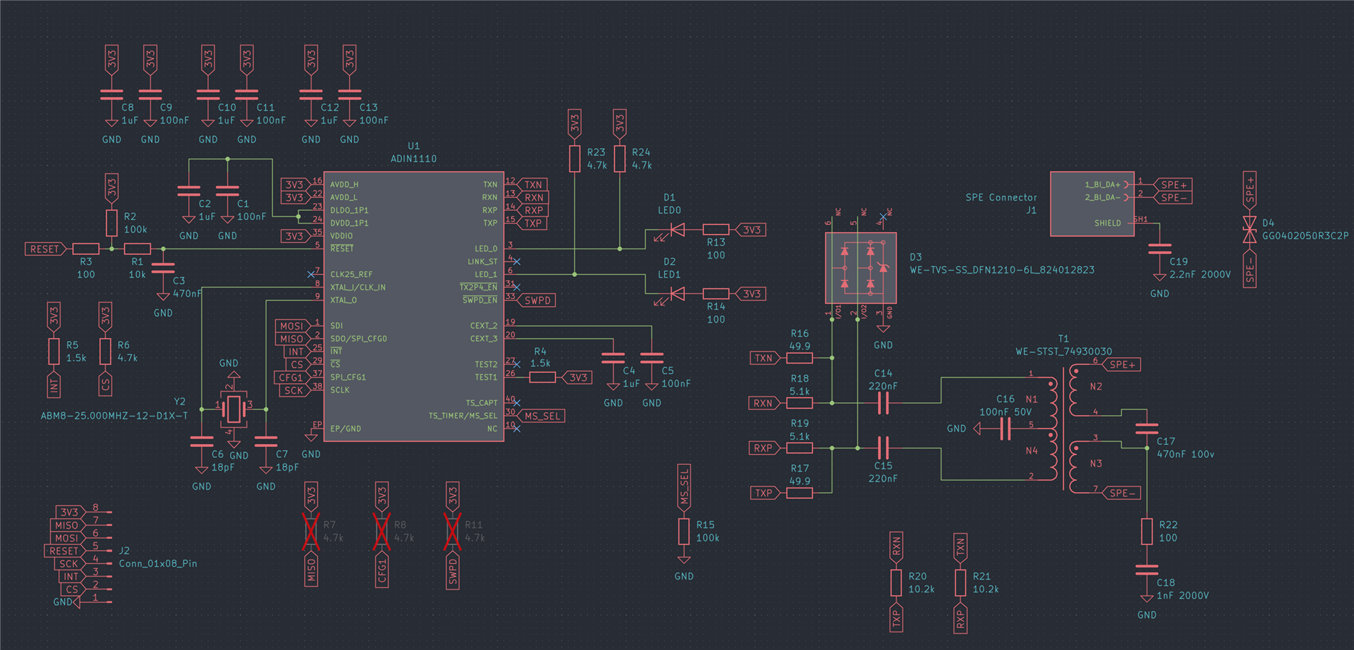

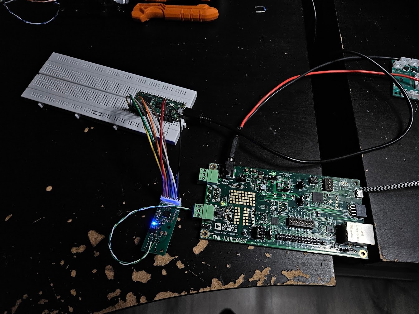

Then I made a custom, minimal ADIN1110 module.
After confirming my board works, by using the EVAL-ADIN1100 development kit and Wireshark, I designed and 3D printed an enclosure for the Compute Unit.
The ugly blob above the USB connector is a custom short USB2 cable, going into the USB2514 hub IC on the HAT, since the GPIO connector lacks any USB interfaces.

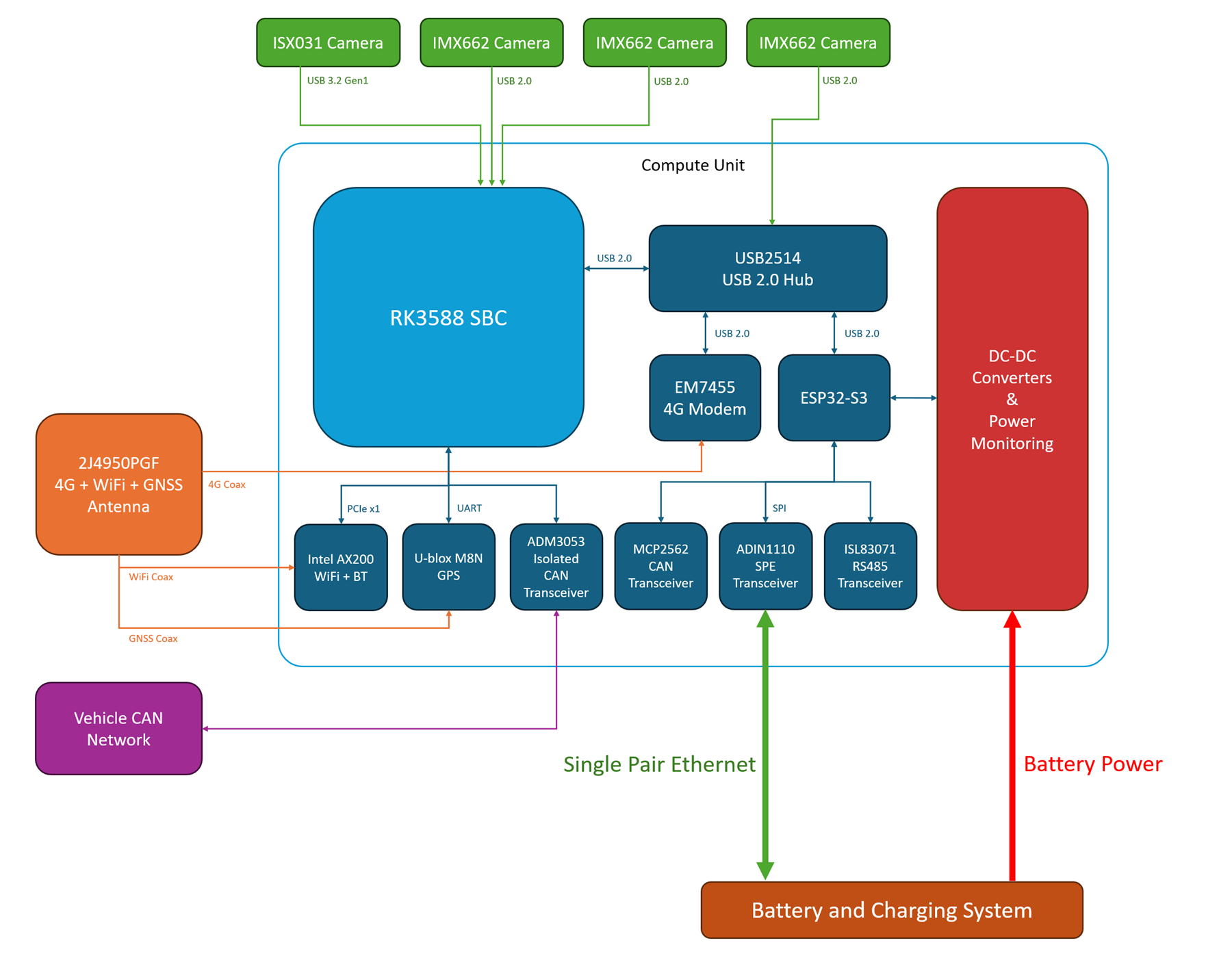

With that, the Compute Unit hardware is ready. Here’s the block diagram of the finished setup:

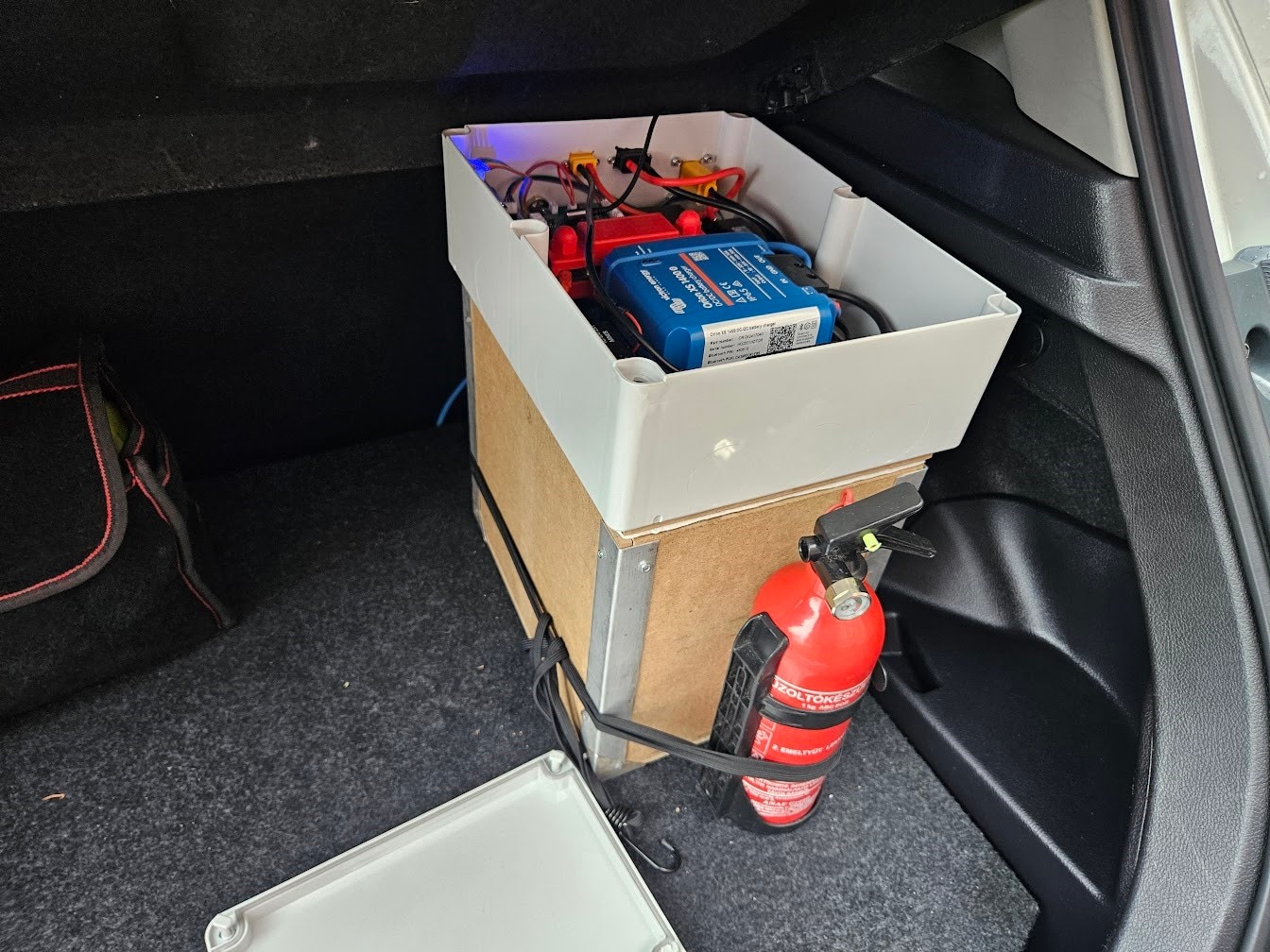

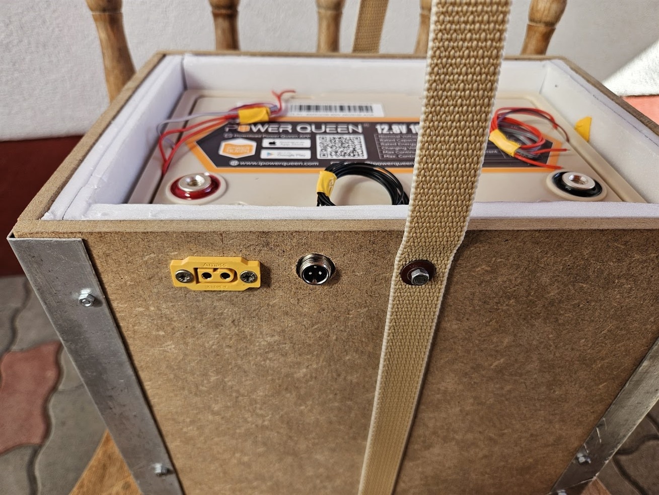

The Battery

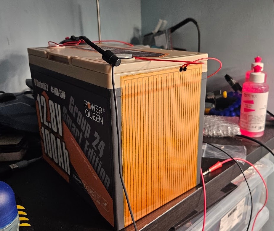

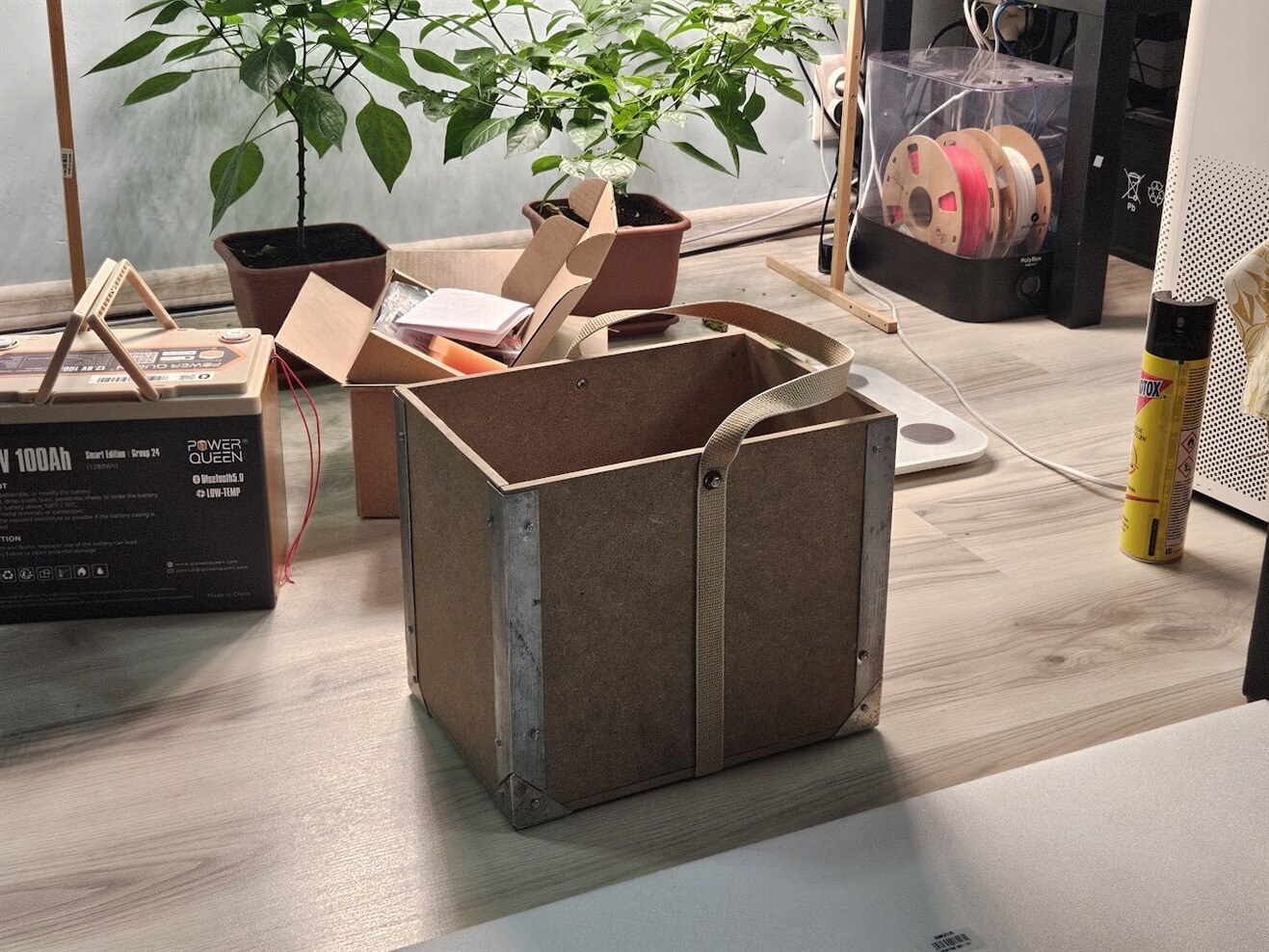

After some research, I got a 1.28kWh, 100Ah LiFePO4 battery. There is one major issue with this chemistry:
LiFePO4 batteries cannot be charged in cold temperatures. Some more expensive battery models include a built-in heater, and in cold weather, the BMS disables charging, and uses the input energy to run the heaters instead.
This seems like a decent solution at first, but it’s a black box system. The BMS controls the heater somehow, with no explicit ability to turn it on, and the temperature sensor is almost certainly just glued to the outside of the cells. When the heater gets the outer shell of the batteries to a few degrees above freezing, I assume the BMS just enables charging immediately, and the battery gets damaged. The LiFePO4 cells are massive, and heating their outer shells to even 10+ degrees means nothing, if their centers are still below freezing. Instead, some logic is needed in the heater control system to account for the heat having to reach the center of the cells, but purely based on temperature readings from the outer shell.
My solution was to add my own external heating. This is significantly worse in the sense that the outer plastic is being heated, which needs to heat the inside air, which needs to heat the cells, instead of just directly heating the cells. However, I get direct control over everything.
Flexible heating films with glue on one side were used, that consist of a long, snaking trace covering the surface. I put two of these on the battery’s outer casing.
For safety, two bimetallic thermal fuses and two DS18B20 temperature sensors were also added.
The next step was to thermally insulate the battery, to minimize energy needed for heating. A relative of mine made a lovely wooden box, that I proceeded to pad with XPS foam.

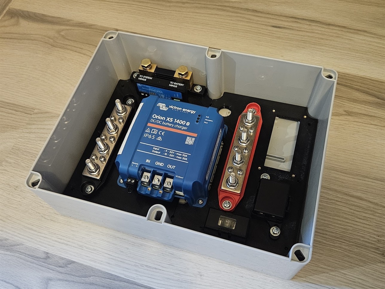

Charging System

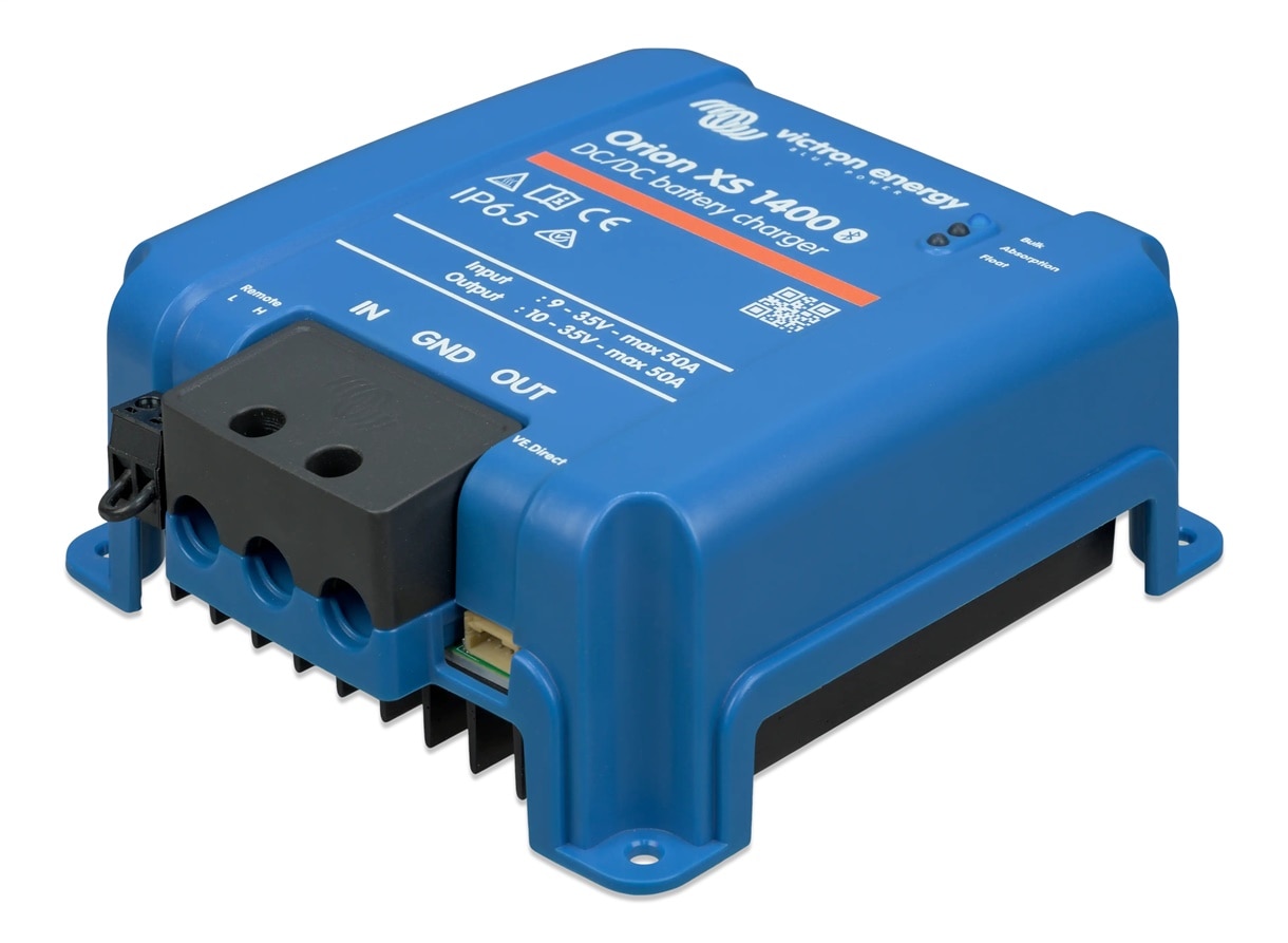

After some quick calculations, I came to the conclusion that a 20A+ charger was needed to keep the battery at a sufficient State of Charge, for indefinite periods of time. I had several attempts at designing a 20A buck-boost charger module, but ultimately decided to pivot.
Instead of a custom module, I went with the Victron Energy Orion XS 1400.
Orion XS is a DC/DC battery charger, designed for the exact purpose I need it for: charging a secondary battery in campers, from a car’s generator or main battery.  It is also insanely efficient, and can do up to 50A. It uses Bluetooth and a smartphone app for management and control, but it also includes a “VE.Direct” port, for more manual control. This interface is essentially just a UART, with a custom command set over it.

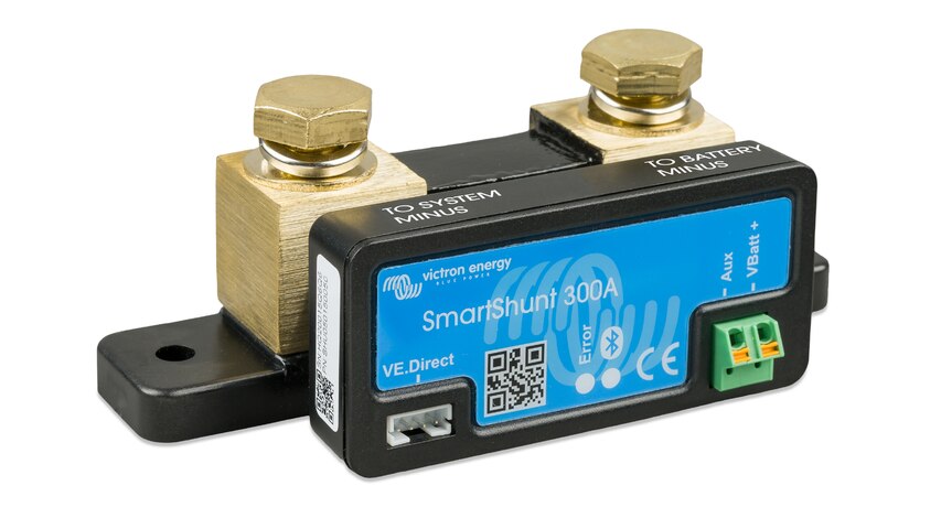

I also used a Victron Energy SmartShunt, to not have to deal with State of Charge calculation and designing another custom PCB. This device also has a VE.Direct port.
I got a large waterproof box to put the entire charging system inside, and 3D printed some mounting hardware. Then I wired up all the charging hardware.

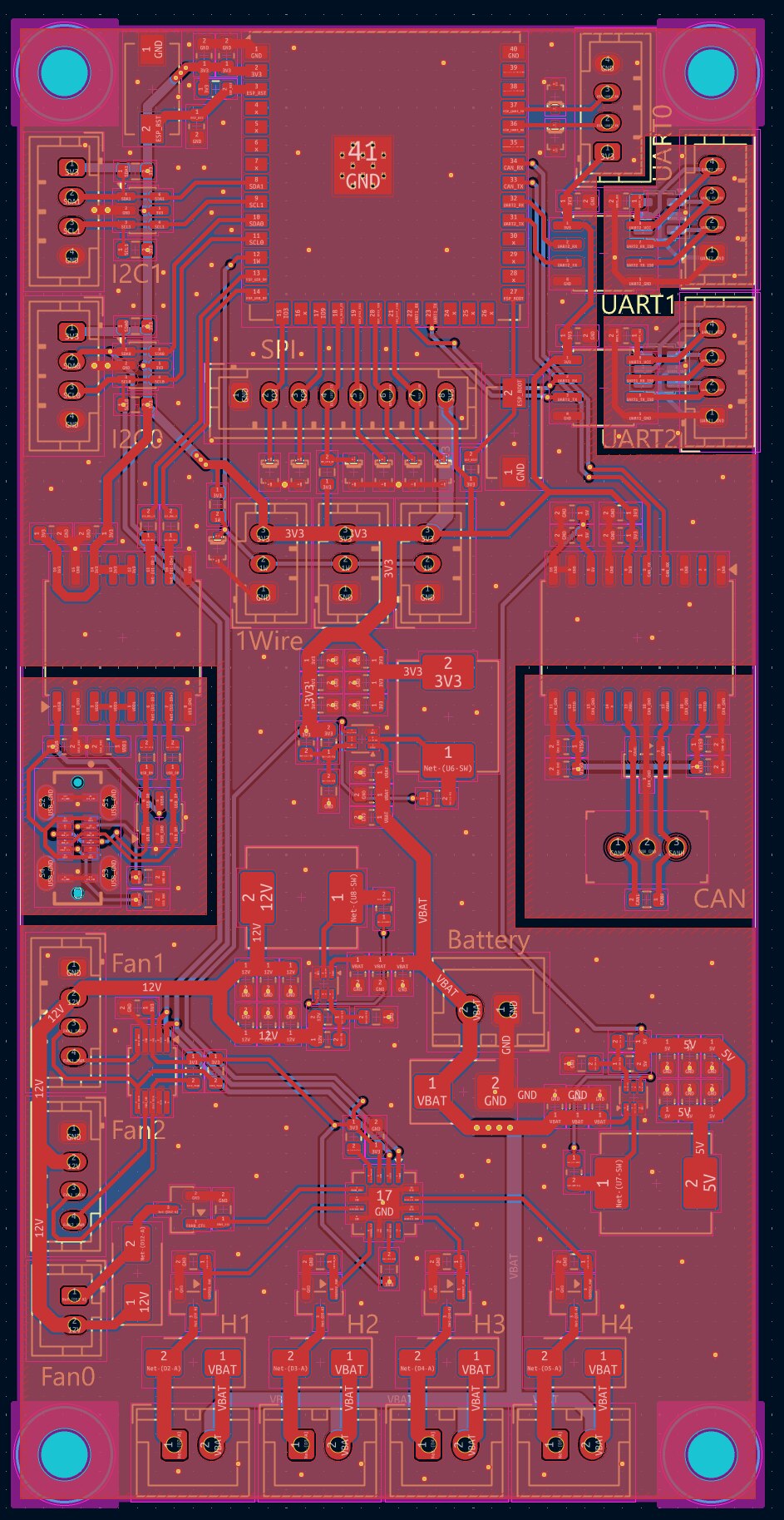

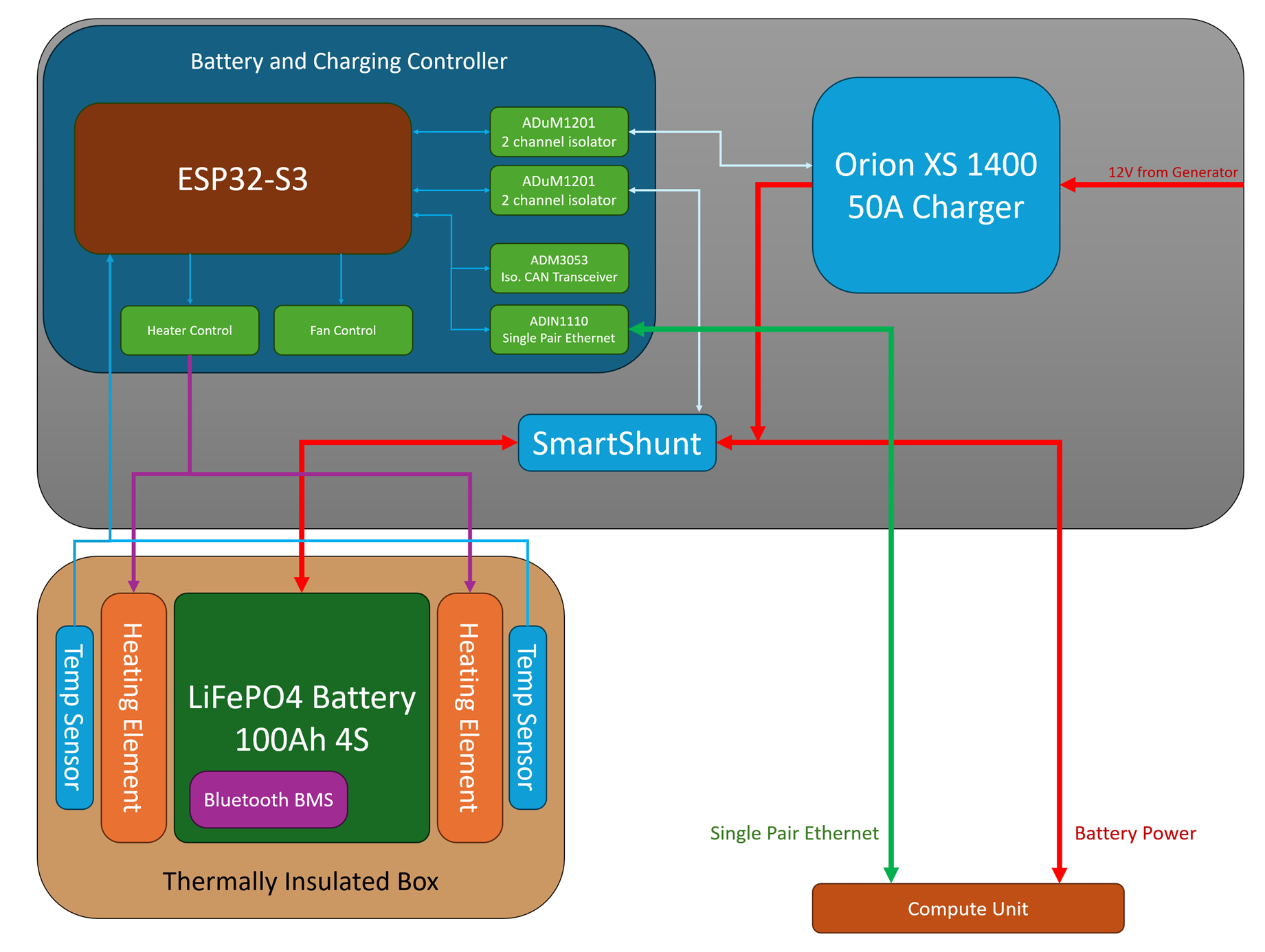

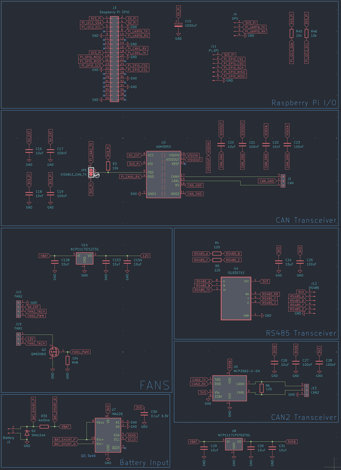

To control everything, I started designing another PCB. Its responsibilities are the following:
  • Communicate over VE.Direct with the Orion XS (50A charger) and SmartShunt

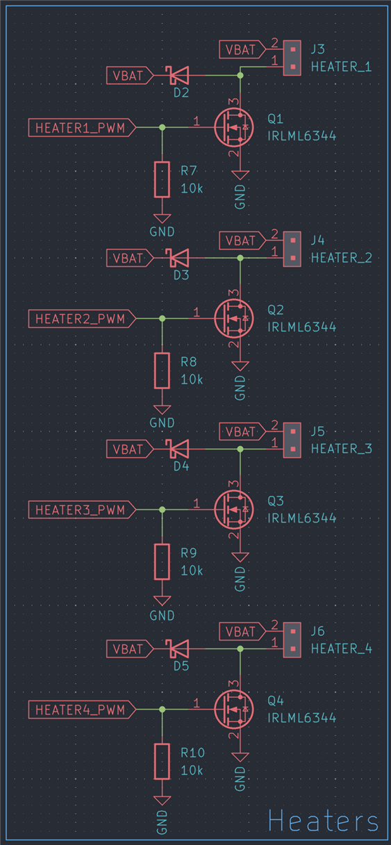

  • Control the heating elements in the battery
  • Control and monitor fans based on temperature of various components
  • Communicate with the Compute Unit over Single Pair Ethernet
  • Communicate with the Bluetooth BMS inside the LiFePO4 battery

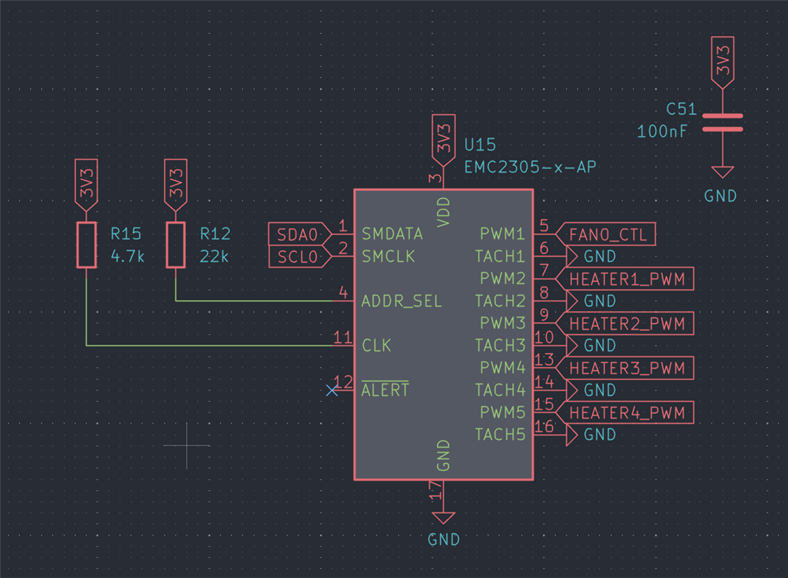

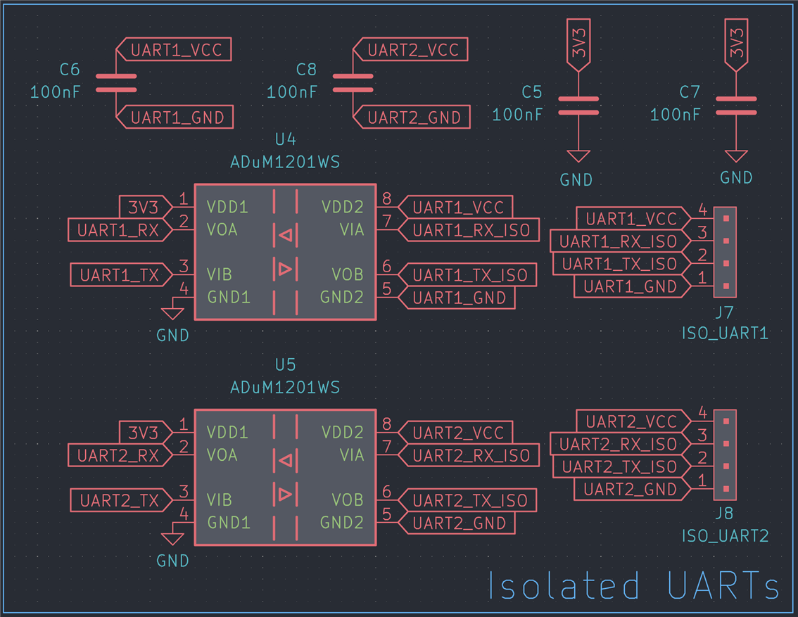

For VE.Direct interfacing, I went with two ADuM1201 dual channel isolator ICs.

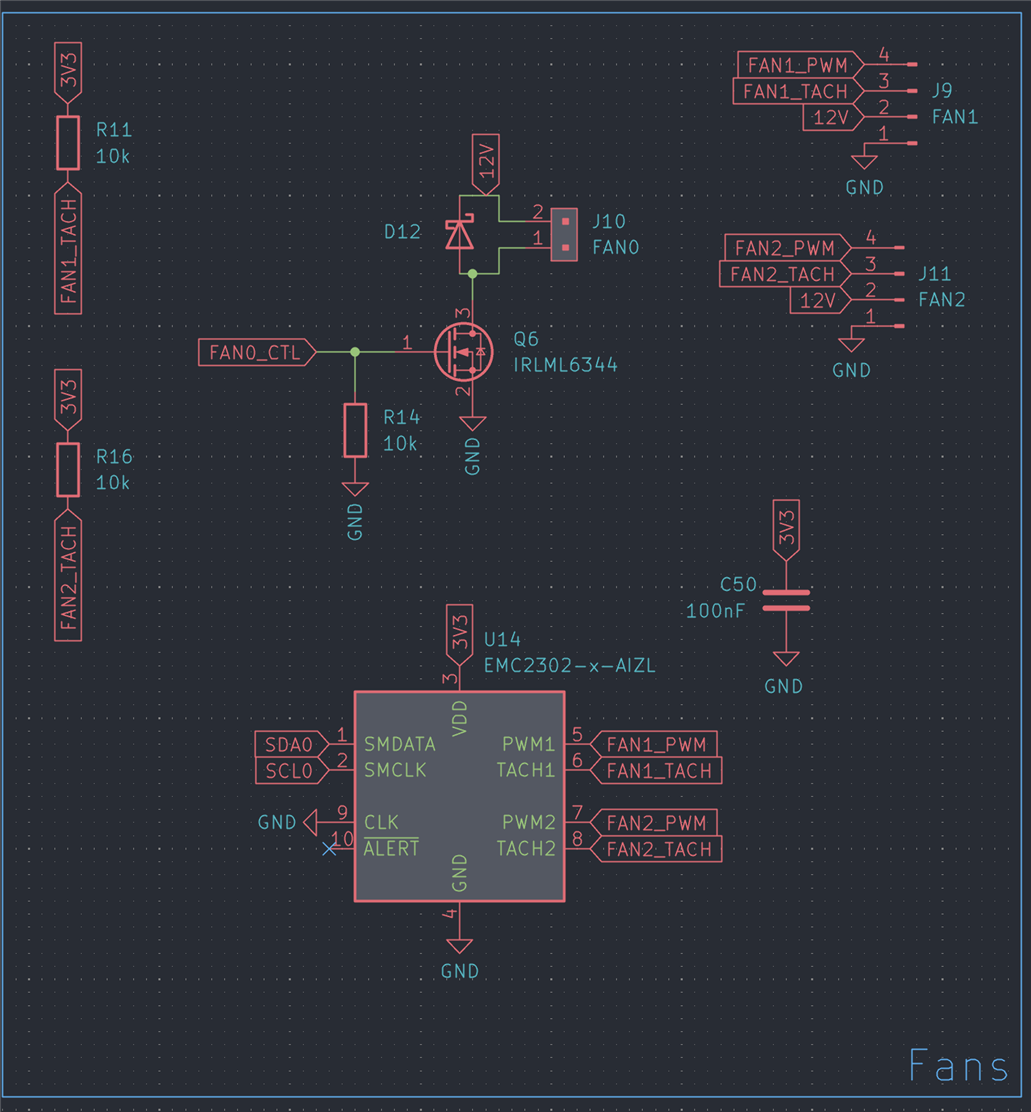

To control the heating elements, an EMC2305 fan controller IC was used, which can provide 5 PWM signals, controlled through I2C. Only four heating elements are supported, with the remaining channel used to low-side switch a 2 pin fan.
The board also supports two 12V, 4-pin fans, using an EMC2302 for control and monitoring. This chip is essentially identical to the EMC2305, except for channel count.
Having a CAN bus interface is always useful, so I added an isolated one for good measure. The choice for this was the ADM3053, which I also used on the Compute Unit, to later hook up to the car’s CAN network.
The power rails are created using three TPS543021 buck converter ICs.

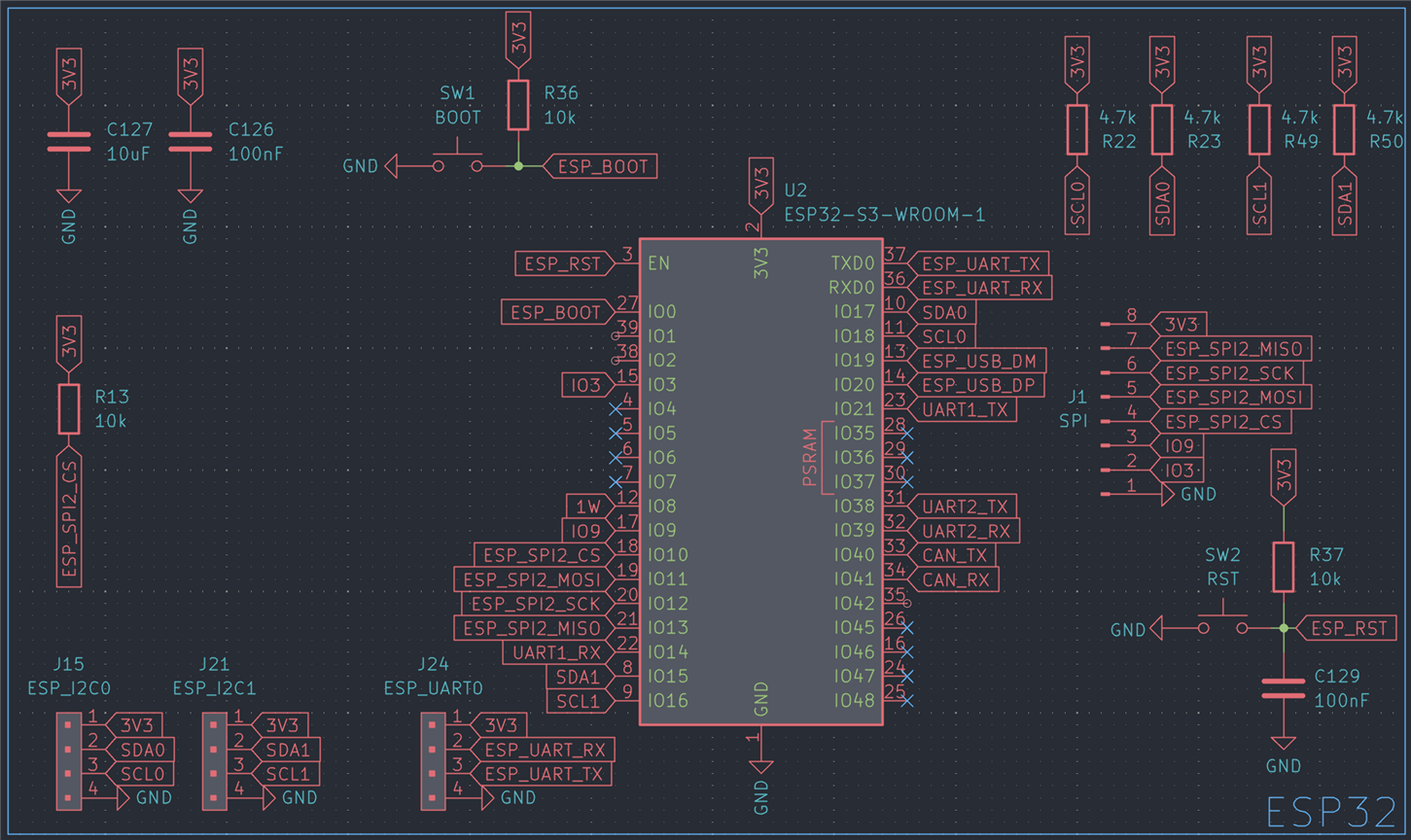

I went with an ESP32-S3 here too. I needed Bluetooth capability to communicate with the BMS inside the LiFePO4 battery, and it makes sense to use the same MCU as in the Compute Unit, to make code reuse easier, and be able to focus on mastering a single device.
For debugging, I added an isolated USB interface to the ESP32-S3’s native USB port, using an ADUM3160, which is a USB1.1 isolator IC.
This is what the layout ended up looking like:
The fan and heater control is in the bottom, power supplies in the middle, MCU at the top. The Single Pair Ethernet transceiver is not on this board, as I didn’t have enough space for it, so I just added an 8 pin JST-PH connector, and a separate PCB will have the ADIN1110 and various other SPE related components, just like with the Compute Unit.

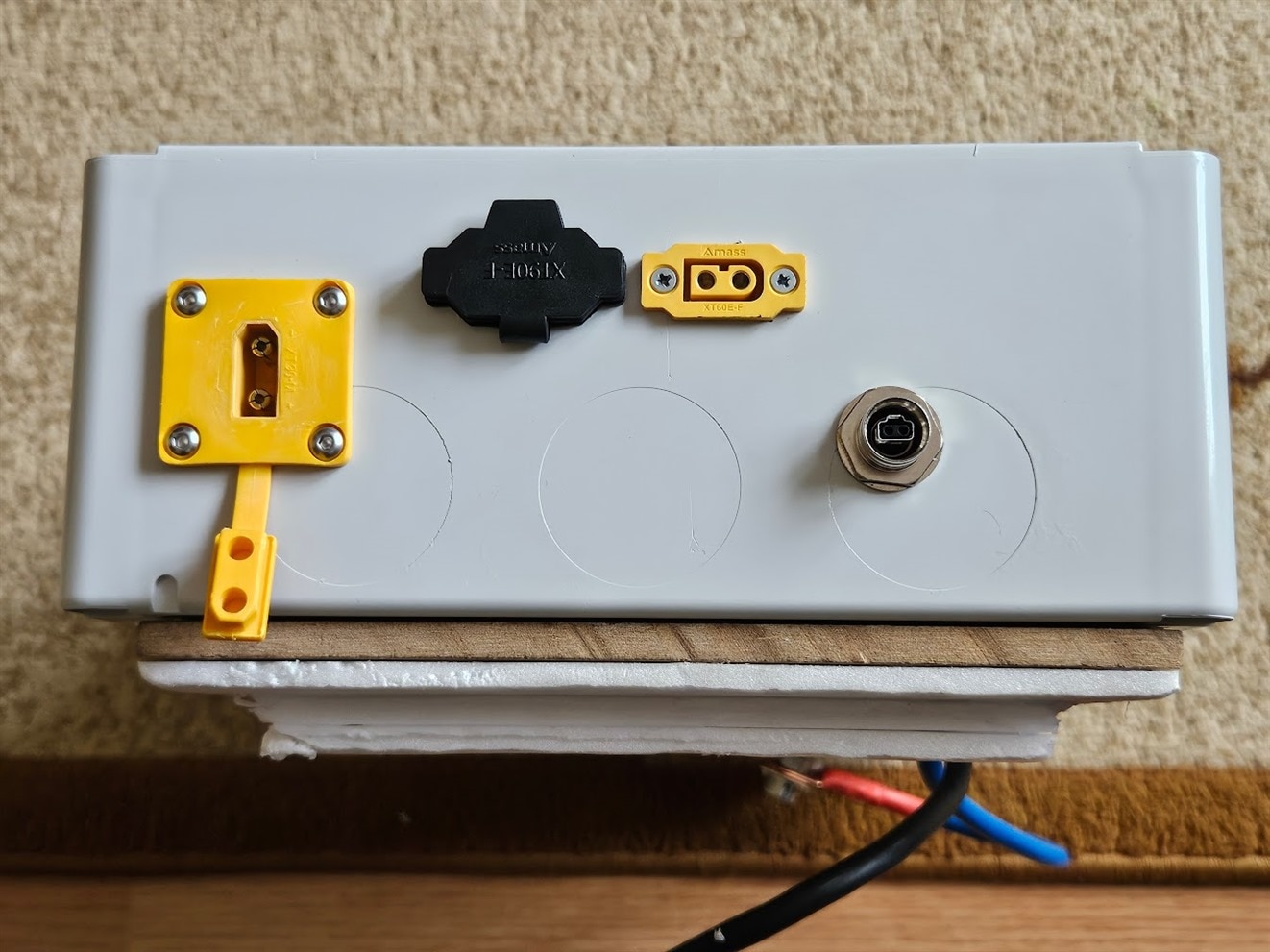

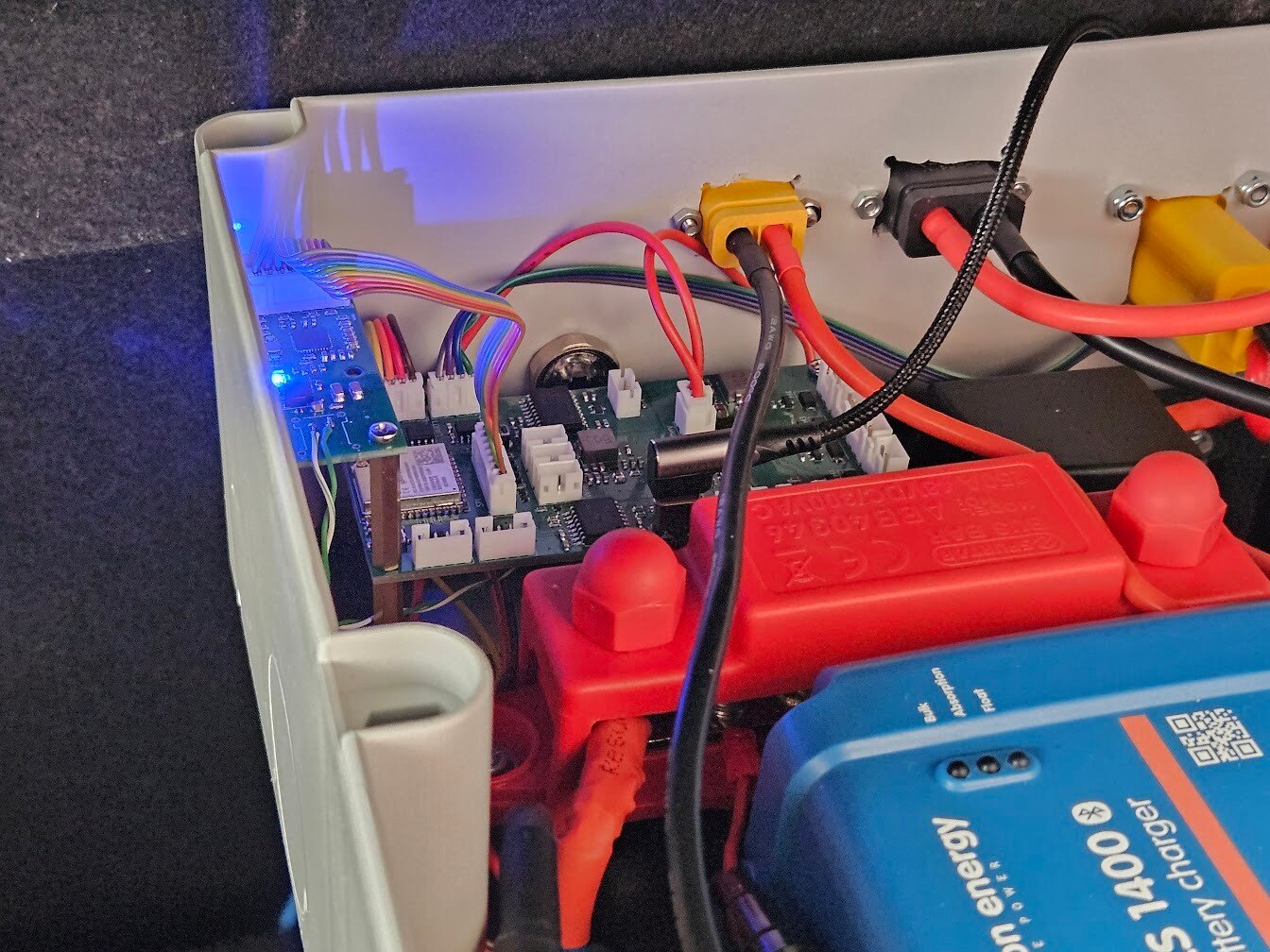

I added the new controller board to the charger box, and also drilled a hole for the Single Pair Ethernet connector.
Here's the block diagram:

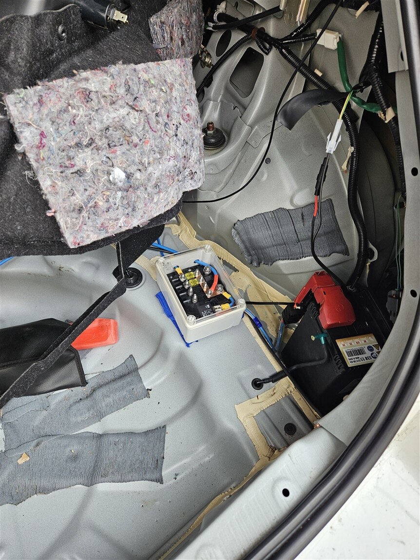

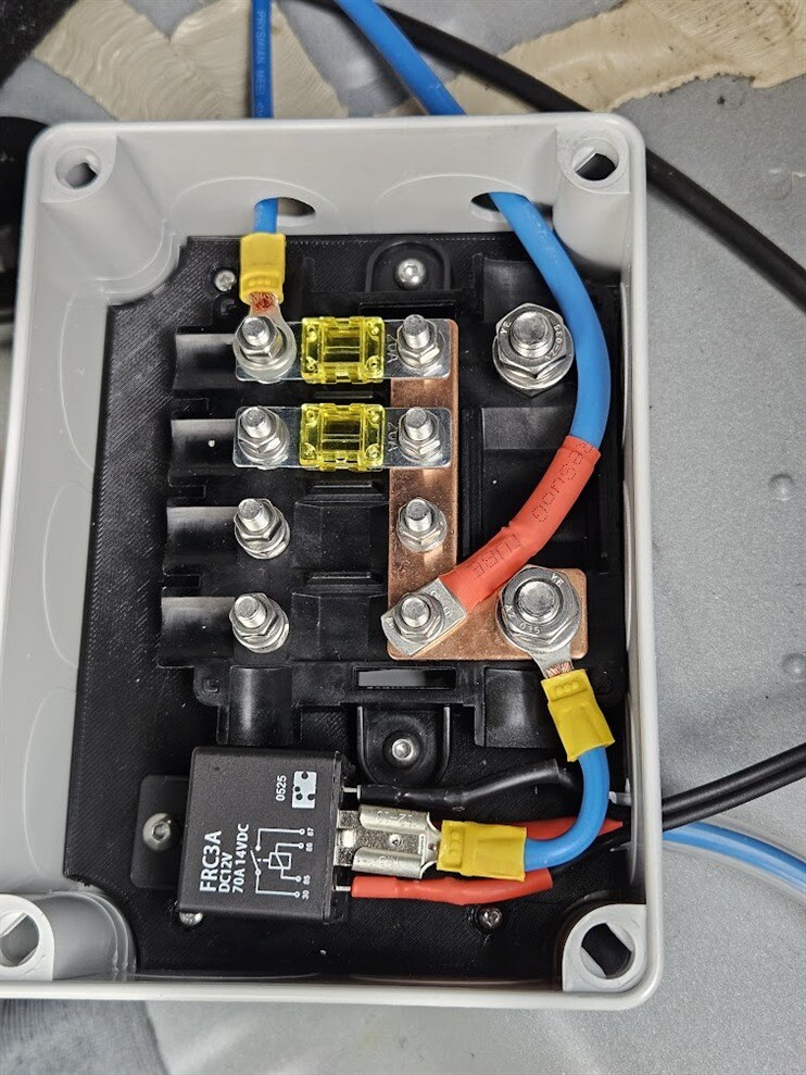

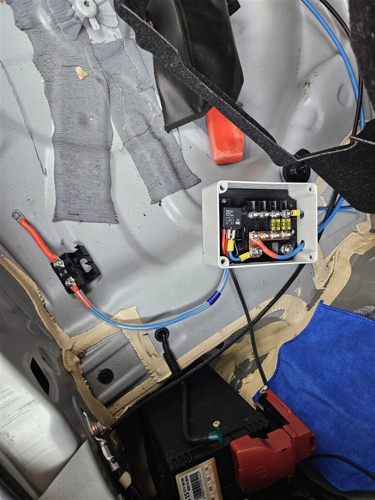

Car Wiring

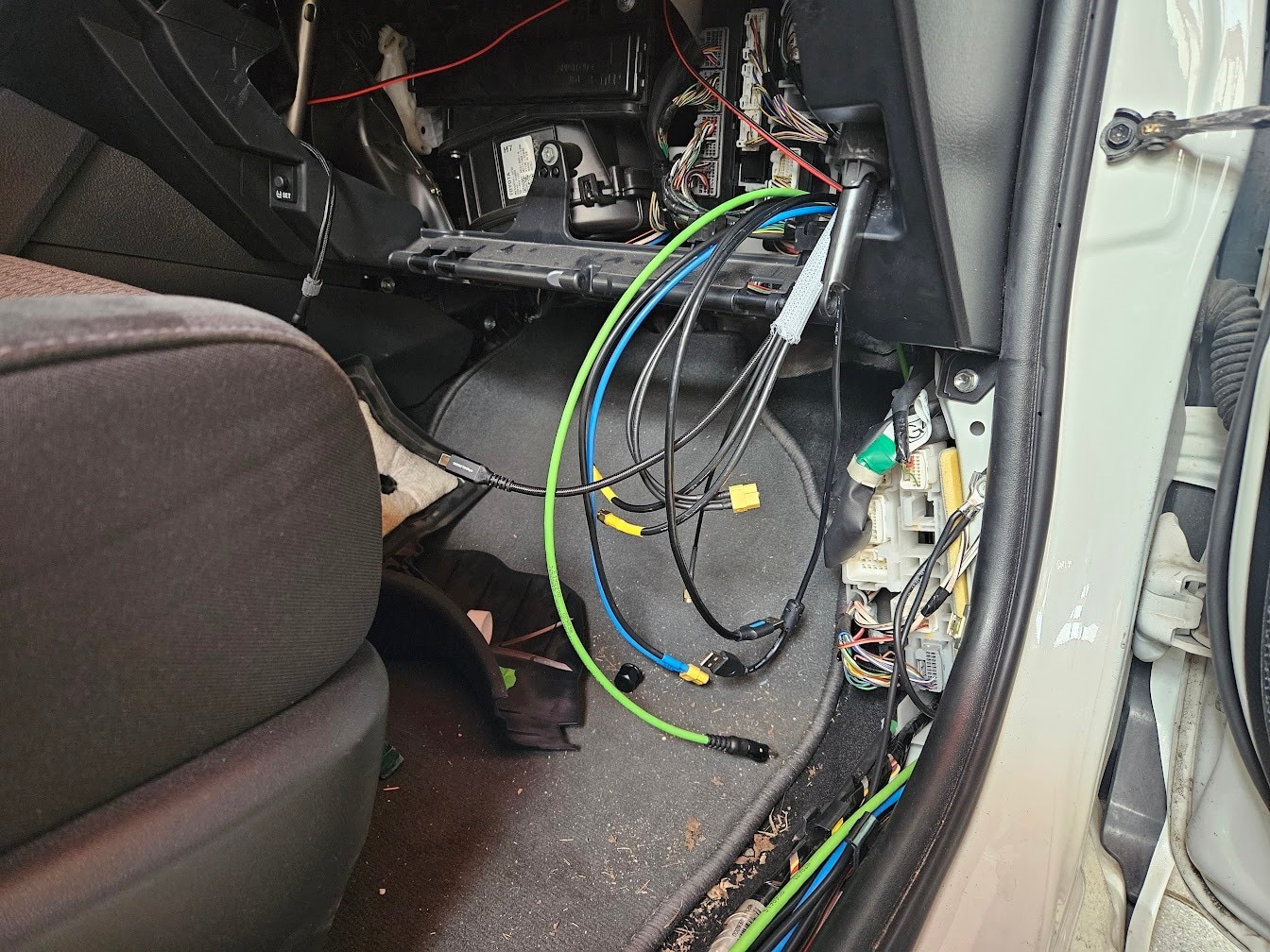

The next step was wiring up everything in the car for the charger. This involved routing the Single Pair Ethernet cable from the trunk to the glovebox in the front, and also installing a robust, 40A capable 12V source for the charger.
To do this properly, another grey box was added, housing a relay and some fuses. The purpose of the relay is to only supply 12V to the charger when the engine is running. Technically, this is not required, as the Orion XS and the Charging Controller board both implement a low voltage cutoff, but better safe than sorry. This also provides a simple way to hook up other loads later, like a high power laptop charger or cabin heater in the winter, if I ever decide to add one.
The thick blue cable exiting at the top is the 12V input to the Orion XS. It is not fused in this box, to prevent unnecessary voltage drop. This is safe, because the entire setup got a 40A fuse, right at the battery terminals.
The smaller blue cable exiting at the top is for a subwoofer, which got a second, 20A fuse.

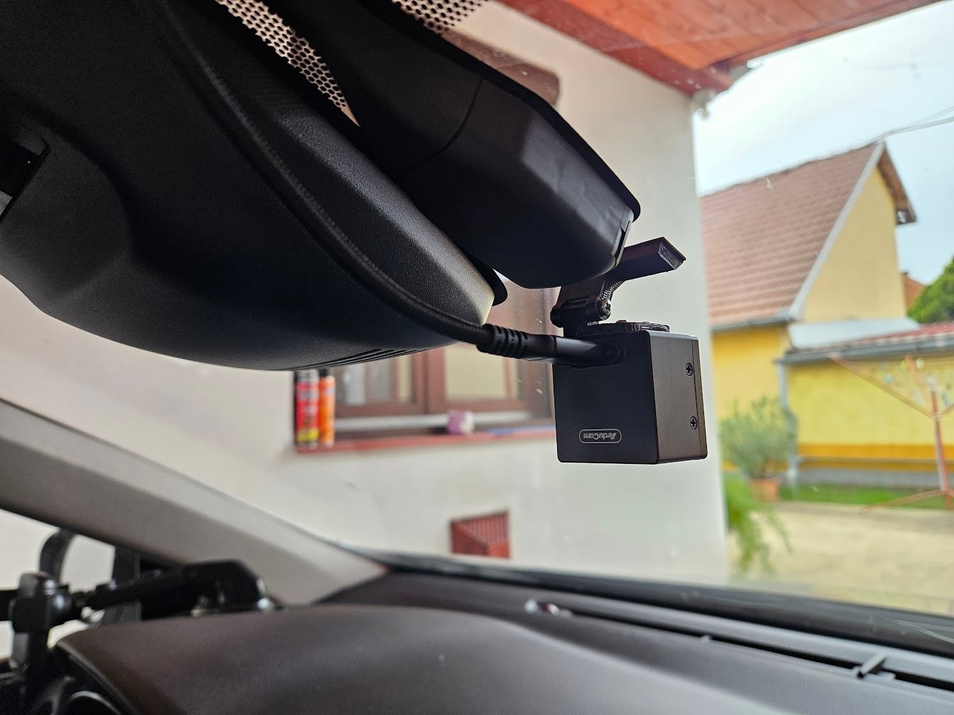

Then, I mounted the cameras. I had quite a lot of trouble with USB3 interference for the front camera, mainly regarding the GPS setup. The solution ended up being a very fancy, USB3.2 Gen2 cable, with USB-C connectors on both ends.
The rear and side cameras are only USB2, so I didn’t have any issues regarding those.
I added a 2J Antennas 2J4950PGF antenna to the windshield, which includes one 4G antenna, one 2.4/5GHz antenna, and an active GNSS antenna.
The cabling for the antennas and front camera were routed down the A pillar, to the glovebox.

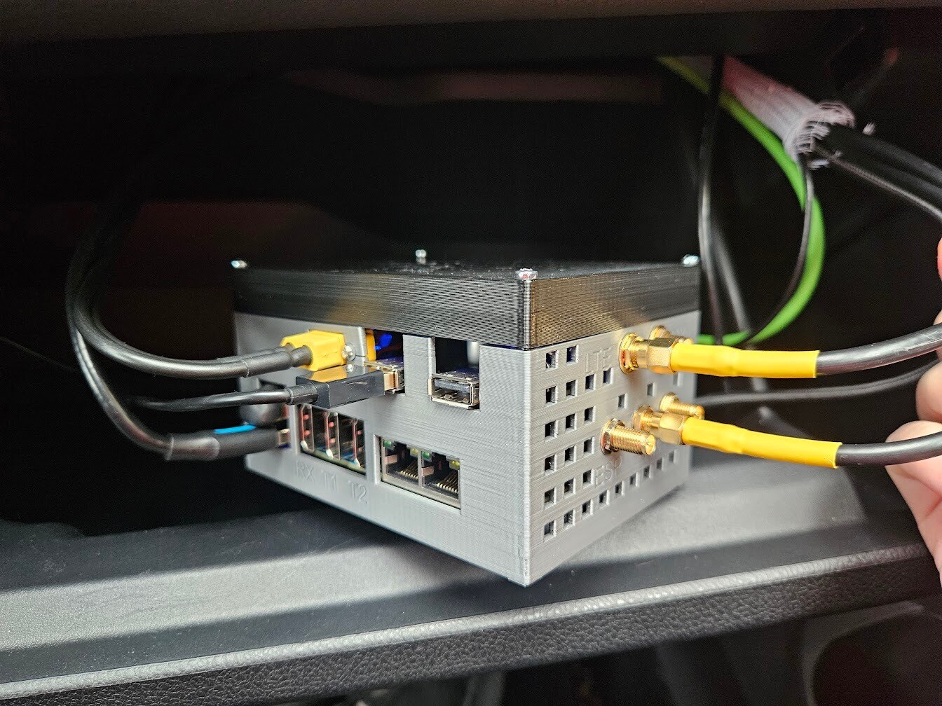

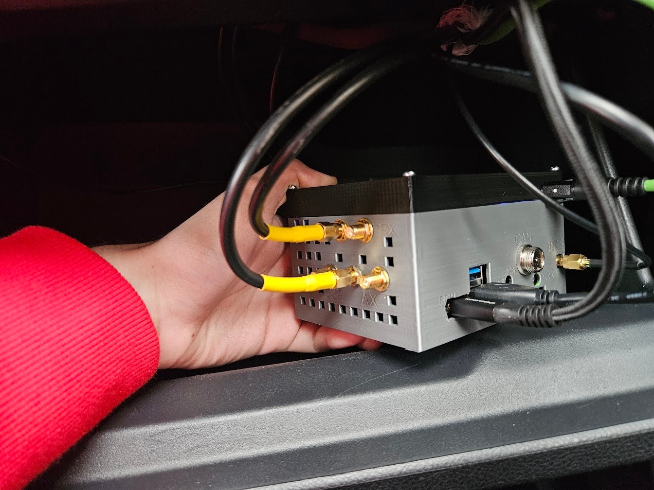

With everything wired, this is what the glovebox looked like.
I temporarily added a USB connection to the Charger Control PCB, so I can debug the ESP32. This will be removed once the firmware is up and running, and all communication will happen over SPE.
Then I wired up the Compute Unit in the glovebox, to finish the hardware.

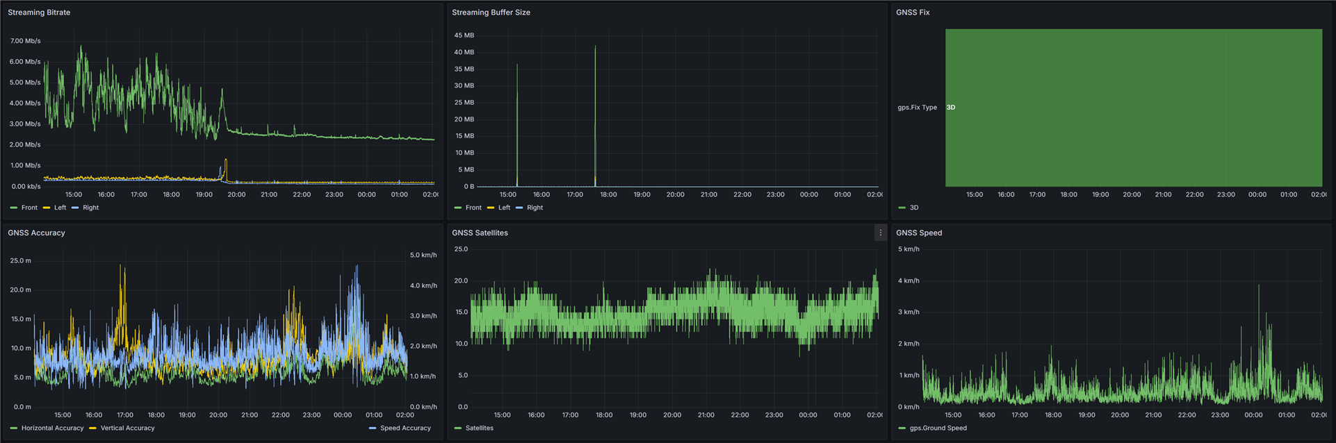

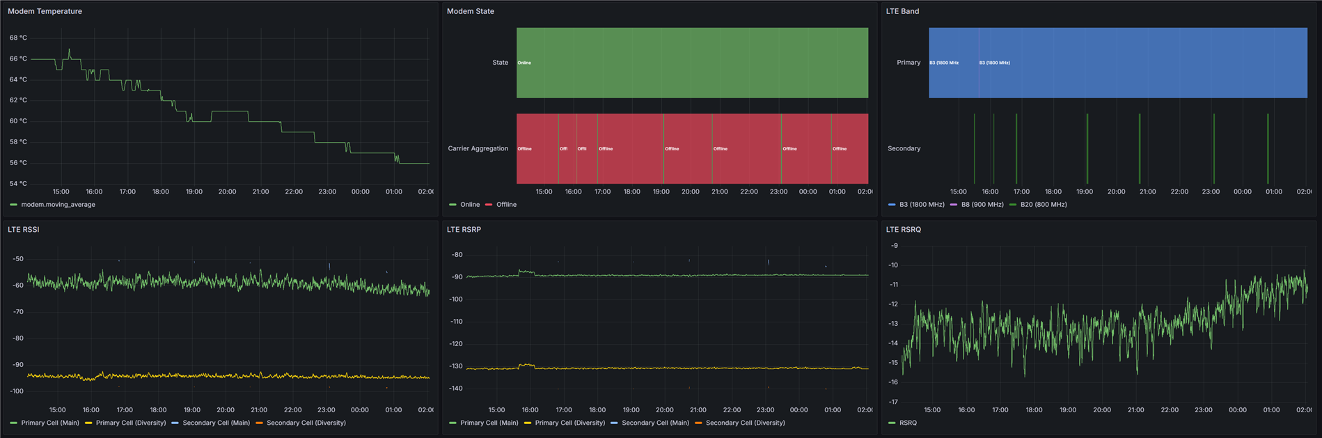

There's also some statistics logging to InfluxDB. Here's the entire front camera code:

        elif msg_type == "charger_smartshunt":
            point = (
                influxdb_client.Point("smartshunt")
                .field("voltage", float(data["battery_v"]))
                .field("current", float(data["current_a"]))
                .field("soc", float(data["soc_percent"]))
            _write_api.write(bucket=INFLUXDB_BUCKET, org=INFLUXDB_ORG, record=point)

I wrote a minimal but modern driver for the ADIN1110, utilizing my framework.
#pragma once
#include <tuple>
#include <functional>
#include <cstdint>
#include <cstring>
#include "esp_log.h"
#include "esp_heap_caps.h"
#include "driver/spi_master.h"
#include "driver/gpio.h"
#include "corestone/TypeCore.hpp"
#include "corestone/Task.hpp"
struct __attribute__((packed)) BasePayload {
    const uint8_t id;
protected:
    BasePayload(uint8_t msg_id) : id(msg_id) {}
template<typename T> struct CbTraits;
template<typename Ret, typename Arg>
struct CbTraits<std::function<Ret(const Arg&)>> { using Type = Arg; };
template <typename RegistryTuple>
class ADIN1110;
template <typename... Ts>
class ADIN1110<std::tuple<Ts...>> : public corestone::PeriodicTask {
private:
    static constexpr const char* TAG = "ADIN1110";

Battery Controller Firmware
The job of this ESP32-S3 is relatively simple at this point, it receives metrics from the charger and SmartShunt, and sends them over Single Pair Ethernet, using the ADIN driver shown above.
I made a VE.Direct library that needs some cleaning up, so I won't show for now, but this is the top level code for this ESP:

I did not implement the heater control code yet, as I won't need it for over half a year, and I had a bunch of other things to focus on.
Compute Unit ESP Firmware
This ESP32 has to receive data over SPE from the Battery Controller, read the INA226 power monitor IC, control the DC-DC converters for the Compute Unit, and package up all data into JSON to send to Linux.
Here's main:

Grafana Data
All of the data logged to InfluxDB is neatly shown in a Grafana dashboard.
Here's the data received from the Battery Controller through Single Pair Ethernet.
I have the charger configured for 30A maximum input and output current, and also to maintain at least 13.1V on the input.
This can be seen in action on the Charger Input Voltage and Charger Input Current graphs, when my car's generator decided to drop the voltage, the Charger Input Current also dropped to 22A to maintain 13.1V on the input.
These are all of the metrics logged from the 4G modem:
And here are video streaming statistics, along with GPS accuracy and speed data:
(I had some trouble with the rear camera, probably related to the 4 meter USB2 extension cable used, so that camera is inoperative at the moment)
GPS positioning data is also logged and visualized:
Video Stream Example
And finally, here's a short segment from one of the front camera streams. The filtering and encoding parameters were not tuned particularly well, so the video looks a bit crunchy, but some work will greatly improve the quality later.

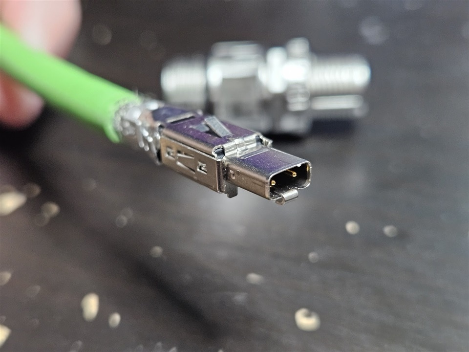

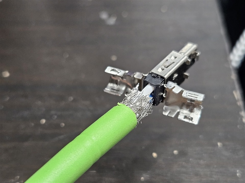

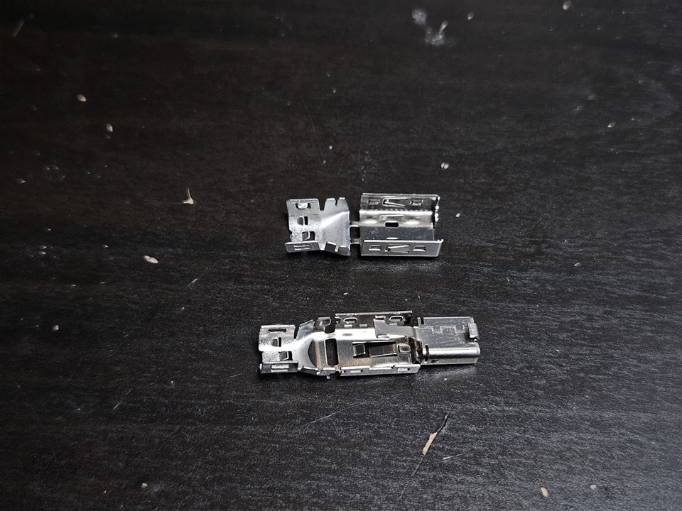

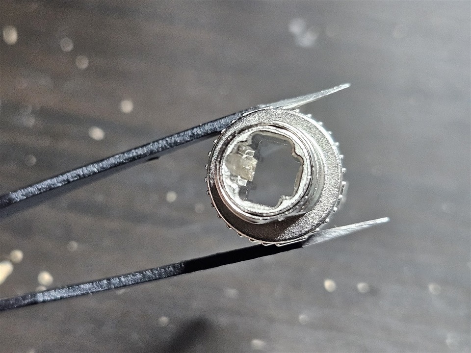

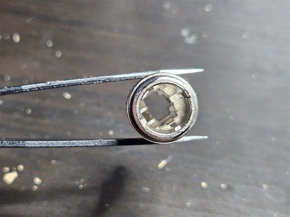

On that note, I just had to take apart one of the M12 SPE connectors, to see what it looks like inside:
{gallery}Molex SPE Connector Teardown
M12 SPE Connector: removed from outer shell
M12 SPE Connector: inner connector
M12 SPE Connector: outer shell
M12 SPE Connector: shield connection bent out of the way
M12 SPE Connector: inner shield removed
M12 SPE Connector: inner connector without shield
M12 SPE Connector: crimped inner connectors
