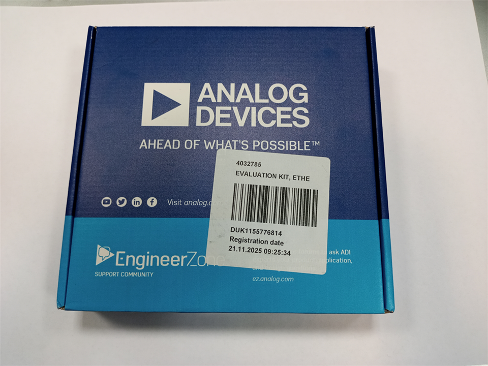

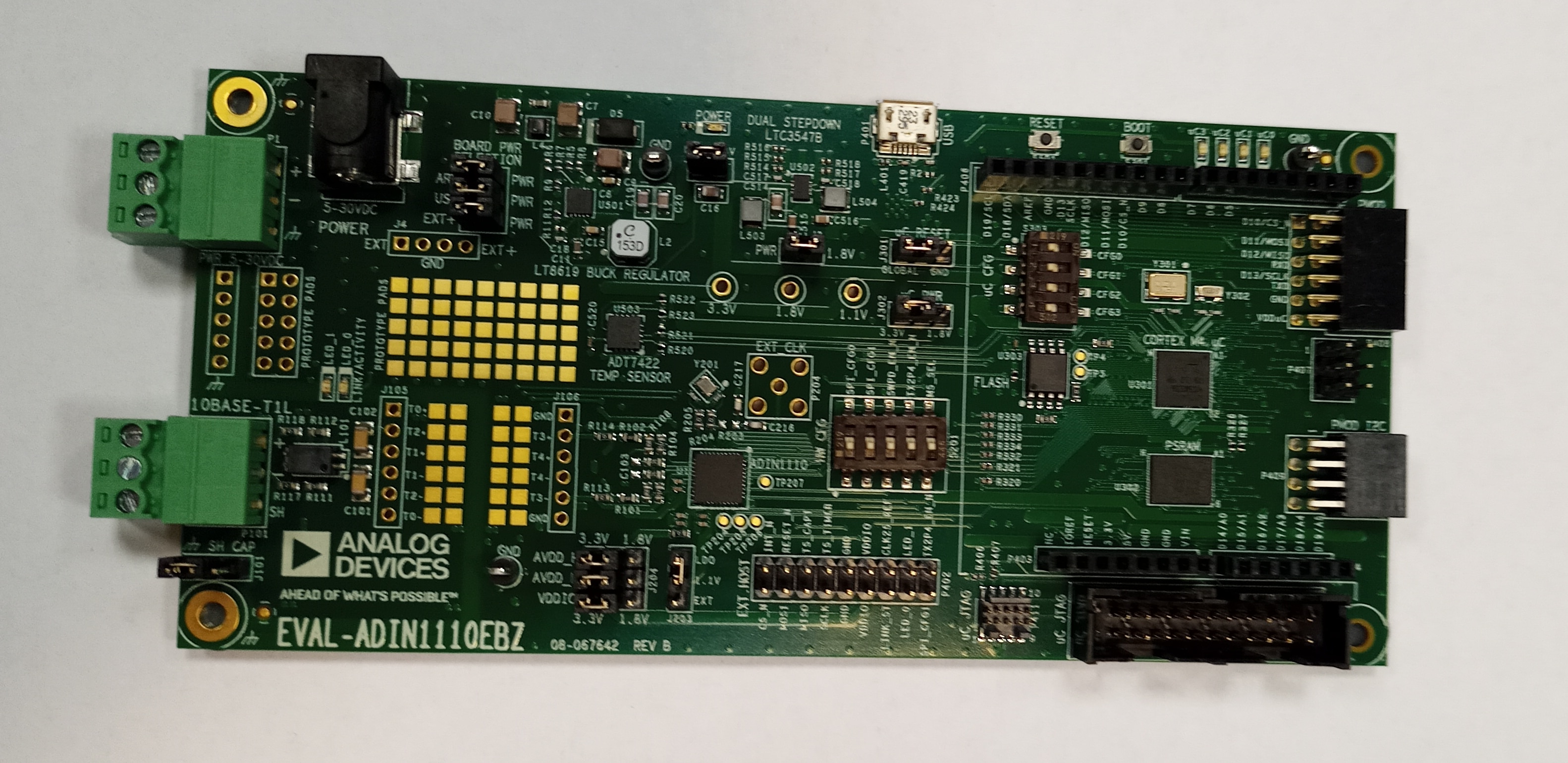

ADIN1110 Evaluation board
Last week my missing ADIN1110  evaluation board has finally arrived (thanks E14Alice for support). It is based on ADIN1110 chip, which - unlike ADIN1100 - integrates both MAC and PHY function, which can be mapped to first two layers of OSI stack (respectively link level and physical layer).
At the other side, ADIN1100 is a 10BASE-T1L PHY, so connecting it to the MCU requires builtin MAC - which may (in - for example - some variants of ESP32) or may not (in Broadcom SoC based Raspberry Pi boards) be present, which explains why our Raspberry Pi SPE shield is also ADIN1110 based.
ADIN1110 evaluation board looks like below:

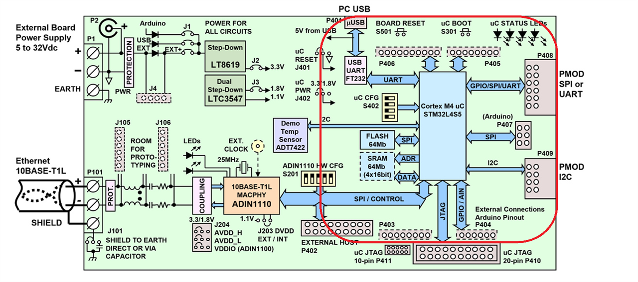

  ADIN1110 evaluation kit can be described as kind of superset of CN0575 Raspberry PI SPE shield (save PoDL circuit), where SPE MAC connects to STM32L4S5 MCU, which can serve as independent network node with hardware encryption offload and even Arduino UNO compatible header:
ADIN1110_eval_block

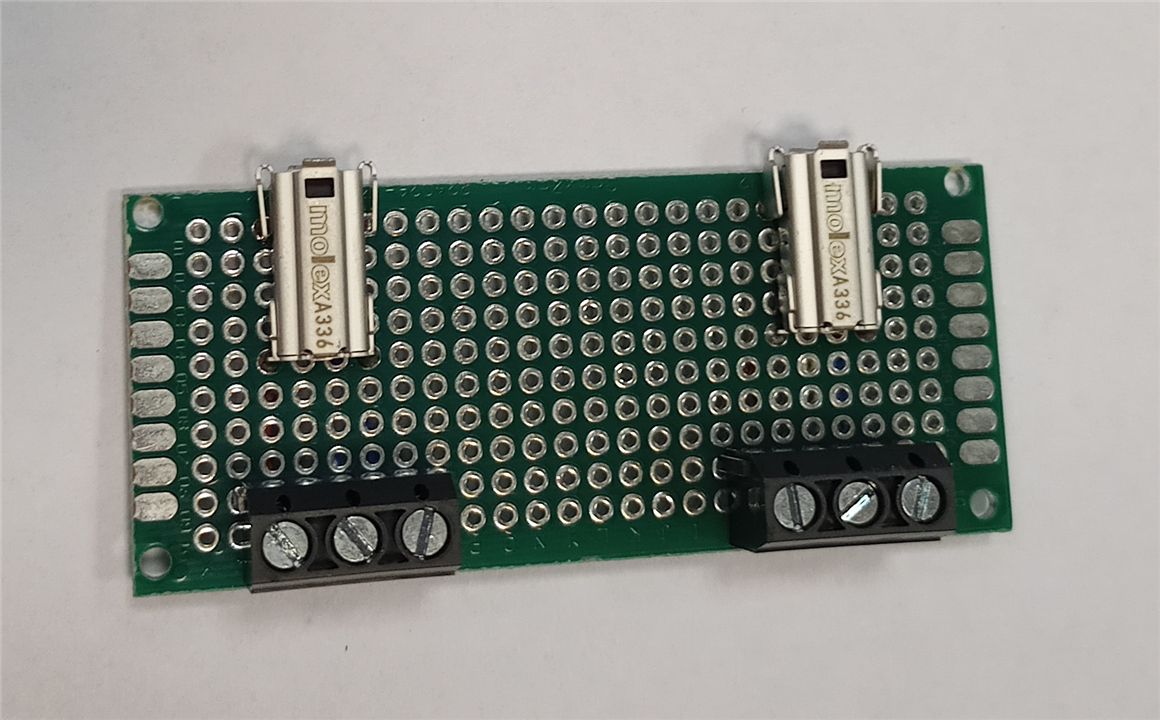

IEC 63171-6 to terminal block adapter
As both types of ADIN evaluation boards terminate SPE link on terminal blocks, IEC63171-6 (didn't find more user-friendly name for this connector) to terminal block adapter was prepared. As veluv01   already shown, IP20 connectors can be easily installed on standard universal PCB, so adapter construction was very easy:
block adapter
and with cable connected
adapter with cable

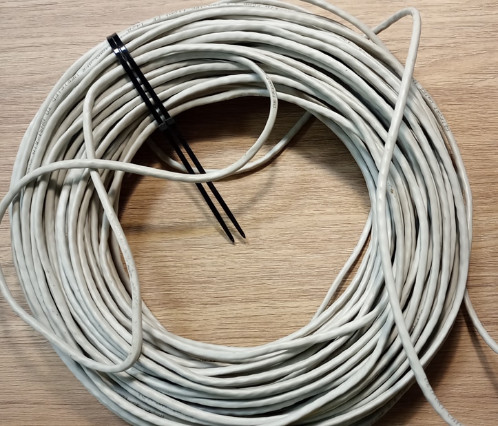

Our first test will be if 48m of CAT5E CCE (copper clad aluminum - very inexpensive one) AWG 24 cable - shown below - can be used for reliable communication using two ADIN1100 evaluation boards in default configuration (working as media converter)
48m_of_cat5

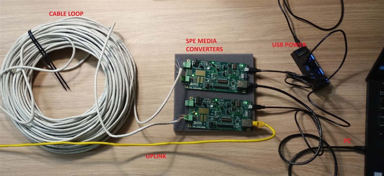

As I now have two of them (E14 team generously decided to let me keep an additional one that was sent in my design kit), I can check if they can reliably operate on medium-length link of cheap and easily avaliable cable in office environment.
Test setup was prepared as in photo below:
test setup
One media converter is connected to the laptop PC, another one to the Ethernet uplink and between them is nearly 50m of (sub)standard Ethernet cable with one pair of four available used for transmission. Both converters are powered using powered USB hub (only power, no data link connected).

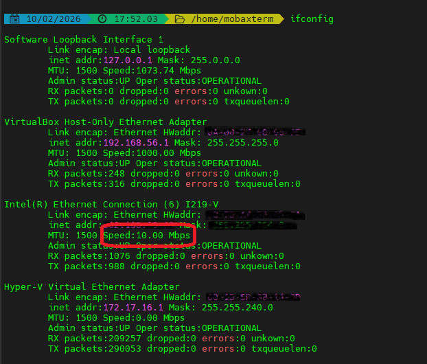

First - autonegotiation was successful and link speed of 10Mb/s correctly set:
autonegotiation

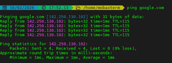

Then, ICMP echo (aka ping Slight smile ) test was successful:
icmp echo test
