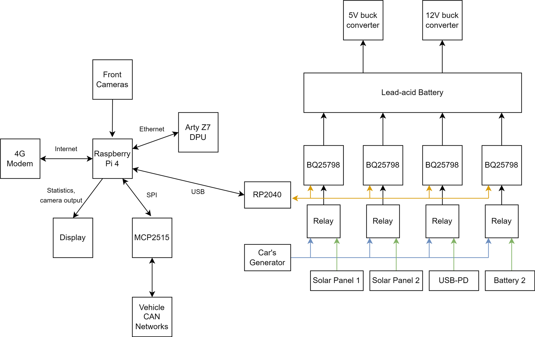

Summary of my earlier project
The system was composed of the following major components:
  • Raspberry Pi 4
  • Raspberry Pi HQ Camera
  • Digilent Arty Z7 (Zynq 7020) FPGA for NN inference acceleration
  • Sierra Wireless EM7455 4G Modem
  • 12V 40Ah (8x 12V 5Ah) AGM battery bank, 4x BQ25756 buck-boost chargers
  • MCP2515 CAN transceiver to interface with the vehicle's CAN network
The AGM battery bank had two ways of charging:
  • With the engine running, the vehicle’s generator provided power to the four chargers
  • When parked, solar panels could be connected, and the BQ25798 charger ICs would do MPPT to charge the battery bank.
The Raspberry Pi 4 used its hardware H264 encoder to create a constant bitrate, 6Mbps video stream, that was sent over an OpenVPN connection to my remote server.
All sorts of metrics, along with GPS data, was logged to an InfluxDB server running on the Pi, set up to replicate data to the remote server as well. A Grafana dashboard provided easy access and nice visualizations for this.

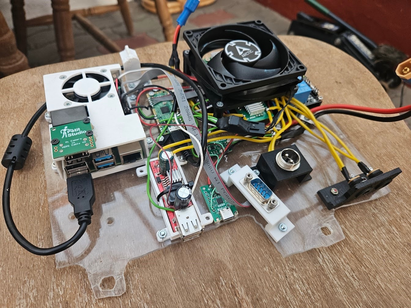

The AGM battery bank’s capacity, around 40Ah on paper, turned out to be wildly undersized. It provided enough energy for roughly 2 days of parked time. Constant cycling and deep discharging are also horrible for these batteries, so the already low capacity just kept decreasing over time.
The charger system was also suboptimal: I used 4 separate “5A” charger ICs in parallel, but the absolute maximum input current they can do is 3.3A, translating to roughly around 10A maximum charging current for the entire charger setup. This was too little to keep the batteries charged purely by the engine, when driving.
The wiring and general ‘aesthetics’ of the system were horrible too:

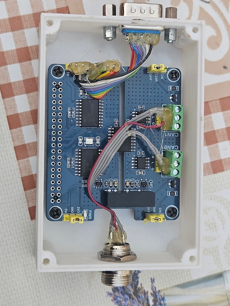

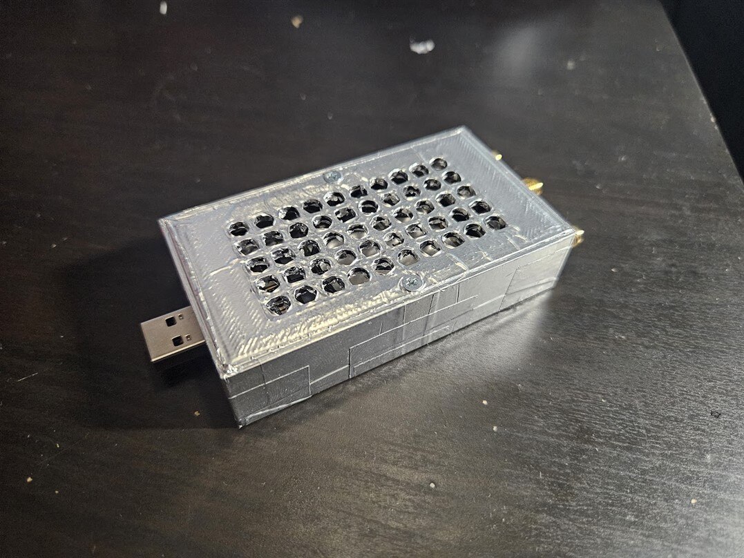

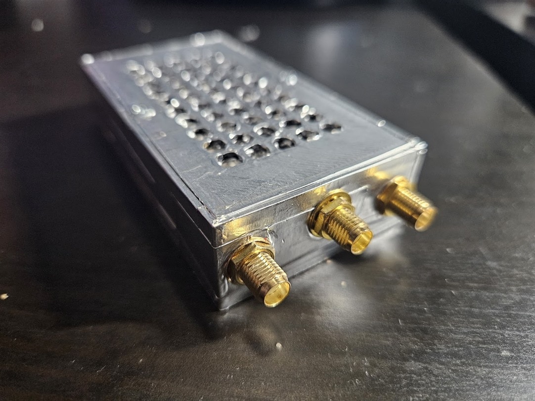

The CAN bus controllers and transceivers, along with the 4G modem, were also located in separate, external 'boxes', with cables attaching them to the main unit. The FPGA was just thrown in there too, with an Ethernet link to the Raspberry Pi.

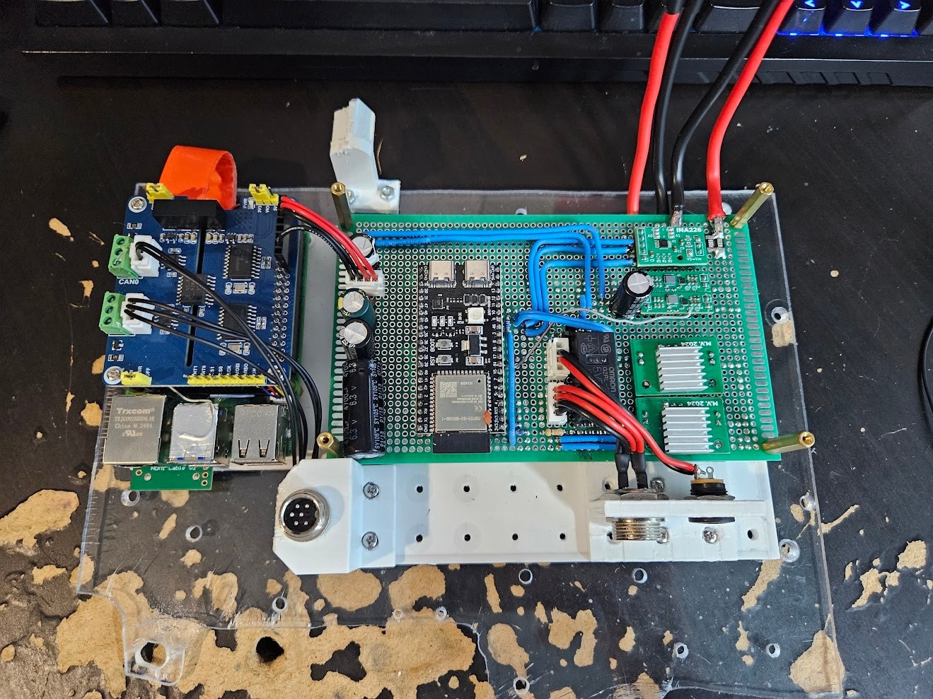

I ended up really liking the overall concept of having an always on, real-time streaming dashcam, and improving it has been on my mind for quite some time. This SPE challenge is the perfect opportunity to do so, but the original setup was way too messy for my liking, so I made some changes soon after the end of the previous challenge, to make it actually decent, and not a fire hazard in the meantime.
Tackling the H264 constant bitrate problem was first, I solved the issue by upgrading to a Raspberry Pi 5, and doing software H264 encoding, which fully supports variable bitrate.
To fix up the wiring mess, I decided to get rid of 2 of the charger modules, and the FPGA. Halving the number of chargers might seem odd, considering that 4 of them wasn’t sufficient in the first place. The rationale was that I had to carry a second battery almost every day to swap with and charge at home anyways, and only having 2 chargers significantly simplifies the circuit, so the net result would be an improvement.
I also changed the Pi Pico for an ESP32, added a few TPS566231 buck converters, and properly soldered together a PCB to hold everything.
The end result is a much nicer contraption:
The CAN bus hat is now used as an actual HAT, and not in a separate box (don't ask me why I didn't do it this way the first time, I have absolutely no idea). However, the 4G modem remains as a dongle on a USB cable.
