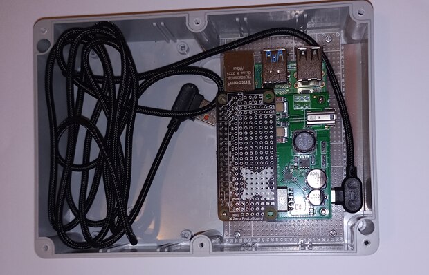

As an enclosure for Raspberry PI, Kradex Z74 with transparent lid was selected. As can be seen, Raspberry PI with CN-0575 SPE shield occupies about half of it, giving some space for additional components

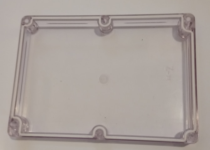

Enclosure itself - rated for IP65 (so it is protected from dust ingress and from water jets from any direction, but not for water immersion), has foam-roll gasket between the main part and the lid that should be trimmed and self-installed from the provided length

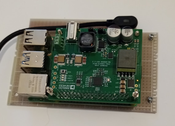

Raspberry Pi itself was screwed into section of PCB cut-out to the shape of enclosure floor, boards connected using 2.5mm spacers and screws - RPI has mounting holes of 2.7mm diameter, so more common 3mm spacers cannot be used.

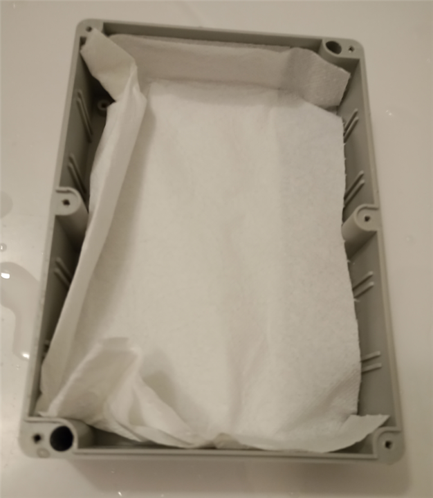

As this enclosure was a part of my research set from Extreme Environment challenges, let's test it Extreme Env way - never mind the formal rating, drop it into the water (with paper towel inserted to quickly identify water leaks)!
And? No excessive bubbling, no water identifiable on the paper towel - success! This enclosure survived short-term water immersion - more tests will be executed as the project advances.

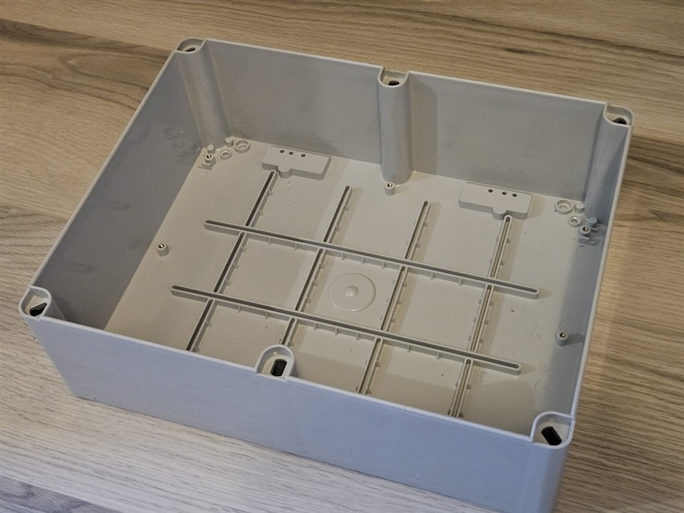

    Oh nice, we ended up with similar boxes then, except mine's a bit larger.

    Interesting one - especially this rail system at the bottom, would make PCB placement easier...

    vmate 8 months ago in reply to JWx
    I couldn't figure out how it's supposed to be used though, there's no way to get something to stay in the rail, so I just used some of those melt-in thread things typically used for 3D prints, you can see them in some of the holes.
  • JWx
    JWx 8 months ago in reply to vmate
    I think with the screw with wide thread (don't know correct English word) - something like screw for wood/metal sheets, thread will lock itself in the rail and hold (if PCB is not too heavy and sudden movement/vibrations are limited)

    kmikemoo 8 months ago in reply to JWx
     JWx I think you are correct.  In the US, we would say "coarse thread" (opposite 'fine thread').  The gap looks similar in size to the threaded inserts for the backing plate.  I can see using them if I just wanted to mount one DIN rail.
