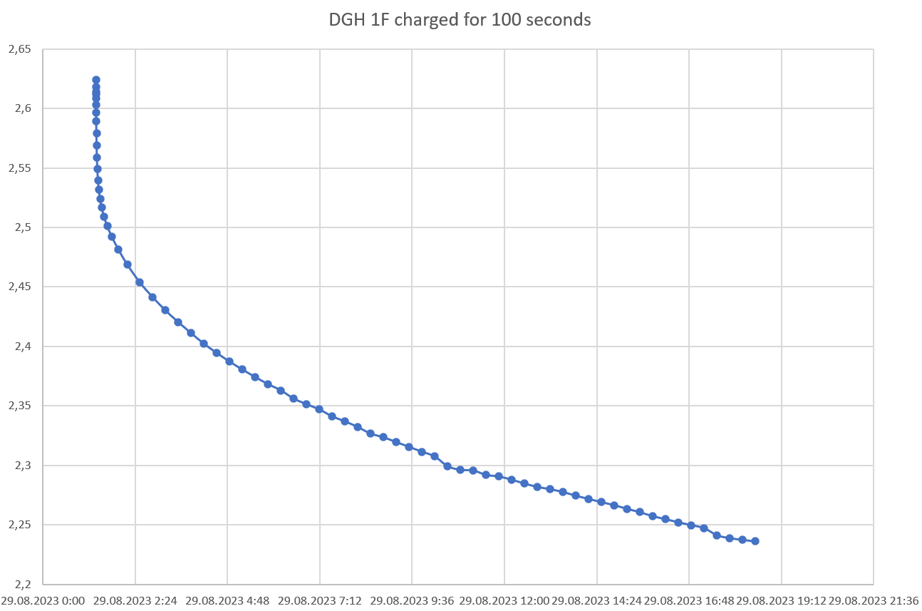

At first, let’s look how it behave when exposed to constant voltage power supply set to slightly under capacitor rated voltage (which is 2.7V). At the beginning my script collects data more frequently and later it starts collecting samples once per 20 minutes. Let’s look how capacitor behave after it was charging from zero volts for 100 seconds. Before experiment all capacitors were discharged (shorted) for at least half hour (some for several days, some for slightly over half hour, but always it was at least half hour). 100 second period is long enough to fully charge 1F capacitor and it also decreased it’s leakage current in this time significantly. Leakage current and self-discharge are dependent.
In first half hour it looked like exponential behaviour:
In first half hour capacitor dropped 0,14 volts which is about 5% of voltage to which the capacitor was charged. Exponential behaviour continued for some time but later changed to liner. On the following image is full plot of collected data (previous was highlighting first half an hour).
In linear part the capacitor loses about 0,009 volt per hour. It is 0,3% of voltage. In theory to 1V it decreases in about 154 hours since charged. This is not problem for my solar powered temperature sensor which needs just to survive night, but for running RTC chip this can be a serios issue. But remember that supercapacitor was charged just 100 seconds. Charging it longer will reduce the self-discharge. In case of RTC use case, the capacitor is powered almost permanently and handles only outages. I did the same experiment when the same capacitor was charged from zero volts for 1000 seconds (ten times more) and the self-discharge (in linear region) dropped to 0,005 volt per hour which means that the capacitor will from rated voltage 2.7V to 1V self-discharge in about 307 hours which is about twice than it case when it was powered just for 100 seconds (ten times less).
