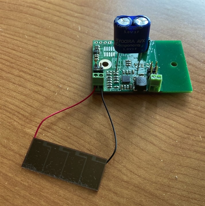

Sensor Device
Sensor device is connected as shown on following block diagram. Device consists of four main chips:
  • ADP5091 Harvester which is advanced chip featuring boost converter for converting voltage form the solar cell to the higher voltage and charge supercapacitor using that voltage.
  • STM32L053 Ultra low power MCU which controls the most of the device.
  • MAX31889 I2C Temperature sensor.
  • MAX41460 Transmitter which is configured for transmitting data from the sensor to the gateway using myself designed protocol working on 868 MHz band.

As you can see on the photo above, I built two units. They are almost the same but there are minor differences.
  • One unit has ADP5092 vs ADP5091 energy harvester chip. Difference is very negligible. Meaning of one pin connected to the MCU is different, but current firmware does not process this input so it does not matter.
  • Unit with ADP5092 instead of ADP5091 has no JTAG connecter because my stock of JTAG connectors get exhausted.
  • Unit with ADP5092 has more properly adjusted voltage divider for ADC measurements of system, battery and regulated voltages.

Solar Harvester
Solar Haverstor is core part of the project. I used it for a first time and at the beginning I was not sure that it will work. But after some tweaks it works. I was not sure that so small solar panel can charge so large capacitor but it works. It takes over 4 hours when providing light from iPhone camera light from the distance of 4.5 cm far from the solar panel to reach level when system get charged enough to power parts (from 0 to 2.2V). Debugging the chip is quite a complicated. I originally did not realized importance of configuration options of that chip. There are 6 voltage dividers which configures voltages, thresholds and hystherisis of the chip. Initially I set all values to make chip start powering parts as soon as possible. ADP5091/2 support starting from 2V so I configured thresholds to about 2.1V but this idea was too simple. The issue which I did not realized originally is inrush current. ADP5091 works in a way that first charge its system voltage to about 2.2V and then start charging backup storage (supercap). After supercap voltage reach configured thresholds, harvester start regulator and generates output for the rest of the system (MCU, Radio, Temperature Sensor). But the inrush current can cause behaviour that system will never boot. It happens when inrush current is too high and discharges the supercap so much to the level when harvester disable regulator again. It charged supercap to about 2.1V, then started regulator, then inrush current of the circuit discharges the charged supercap back to 1.9V, harvester terminated regulator and started charging supercap again until it reach 2.1V. Then the same behaviour repeat. I originally did not realize that configuration of voltage when regulator starts depends on inrush current and supercap capacity but it depends. You can solve it by increasing voltage when system starts, increasing power good hysteresis or increasing backup storage capacity. You need to adjust it not only by taking minimum voltage required by your circuit. Similarly, I originally did not realize that my circuit has some inrush currents but it has. At first powerup of MCU, it starts with default clock (MSI prescaled to 2.097 MHz) which is faster than clock later used by my firmware (MSI prescaled to 0.524 MHz). Before clock reconfiguration, MCU consume more energy than later in execution time after reconfiguration. But in fact, this is not the biggest source of inrush currents. The biggest source of inrush current are decoupling capacitors. I used Nordic PPK for power consumption measurements and inrush current peek was 120 mA for 0.3 ms. It is extremely high for circuit consuming 1.8 uA in average!
For debugging I recommend do not connecting supercap and especially, large supercap. As mentioned at beginning, everything in the system with supercap is extremely sloooooooooooooow. ADP5091 datasheet mention that minimum recommended capacity is 100uF, so for easier ADP5091 debugging I recommend start with 100 to 1000uF electrolytic capacitor before going with supercap immediately. Note that with 100uF supercap you most probably will face never-booting issue mentioned above. With 100uF (measured as 113 uF) electrolytic capacitor and no power consumption of the external parts (only harvester powered) and solar panel disconnected from the system the 100uF capacitor voltage drops from 3.5 to 0.6V in 8 minutes which is much better for debugging. Similarly charging is much faster.
Even without supercap system is slow and it cost me lot of time when troubleshooting my first circuit (note that schematic above have lot of resistor values tweaked since my first draw). ADP5091 updates lot of parameters like tracking best power point of solar panel once per 16 seconds. If power point is not adjusted properly, the performance will be low. So, for example when I attached light near solar panel and was watching system voltage I noticed it do not grow and even worse it is decreasing. I attached light and after 10 seconds voltage was still decreasing instead of expected growth. Big disappointment. But after some time I realized that I need just wait more because after 16 second period elapsed, ADP5091 revaluated best power point of solar (which changed when I attached high-intensity light) and then voltage start increasing, slowly, but increasing.
The last interesting issue which I have seen is that even things which are described in the datasheet in an analog way, they are implement digitally. It is for example termination voltage evaluation. Terminal voltage specified at which level the harvester stop charging backup storage. In case of supercap you can set it to the rated voltage of the supercap. In case of using lithium-ion battery you can set it to terminal voltage of battery (usually 4.2V). But when I was using circuit with 100uF storage I noticed that harvester for some reason allows exceeding this voltage. After some time with violated terminal voltage it stop charging and wait until it decreases below this limit and then start charging it again without any boundary for some time again. Later after some experiment I realized that the time is exactly 16 second (note that it is the same interval as updating best power point of solar panel). And now we are again in the situation when the impact of issue depends on capacity of storage element. With supercap used violating termination voltage for 16 second is not a issue because system will not overcharge supercap so much in that short time. But with 100uF capacitor charging is fast, and harvester can overcharge it significantly which can cause stressing parts (capacitor, harvester, MCU ADC channels, …) above absolute maximum ratings. I have limit originally set to 4.9V and at one moment I measured 5.7V at 100uF capacitor when charging system by high-intensity light from iPhone camera light!
But at the end device work well. 1F/5.5V supercap is suitable for running this even when using very small solar panel. Charging from 0 to 4V took approx. 7 hours on direct sun and from 4V to 2V it drops in about 1.5 days when “no sun” is provided for some reason. More realistic scenario is that voltage in day increase from ~3V to 4.6V (which I later set as termination voltage taking in account possible overcharging mentioned above) and in night decreases to about 3.8V from which it start charging again at the morning. Based on these experimental results it looks that even lower capacity supercap is suitable. I think 0.47F/5.5V should work well also. Note that system will behave differently in winter when there are less light so having some reserve is good idea.

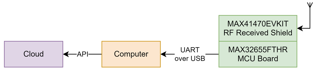

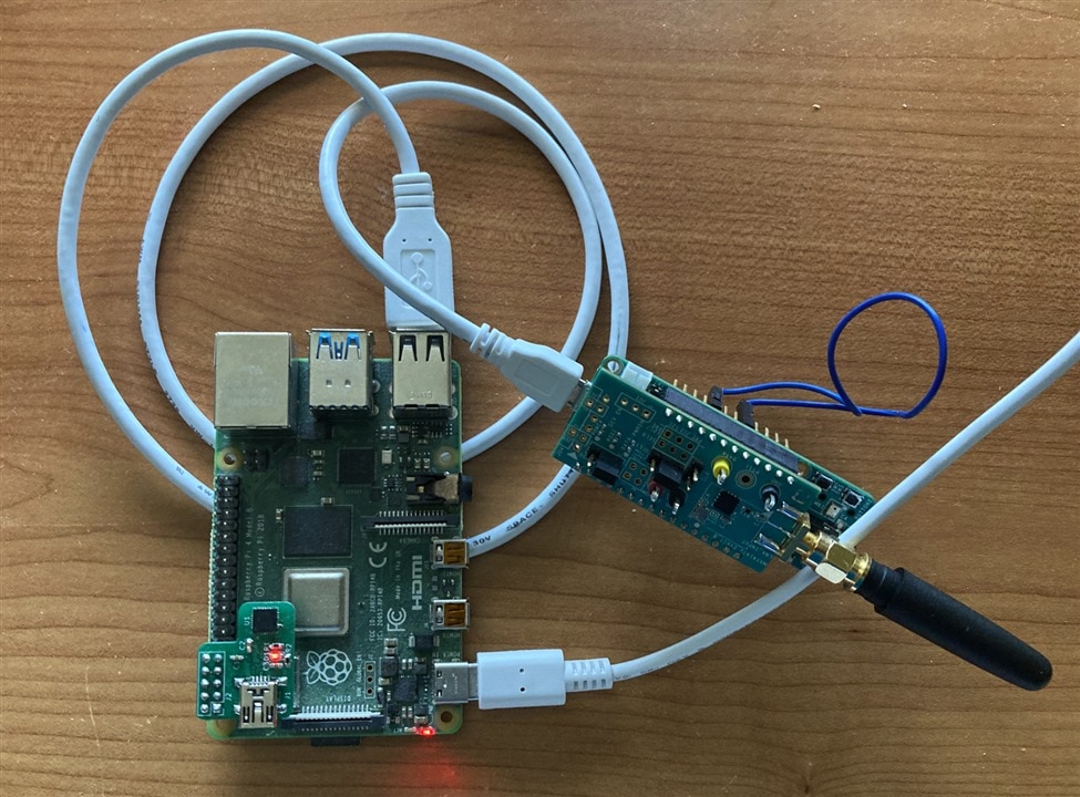

(Internet) Gateway
For receiving data from nearby sensors I designed gateway. It is device which listens for the wireless data, decodes them and transmit them using UART to external computer which in my case is Raspberry Pi. It is visualized on the following diagram.
In real it look as follows:
Main MCU (MAX32655) configures the Radio Received EVKIT. Note the similar names of Rx and Tx chips. MAX41460 is transmitter (used in sensor module) and MAX41470 is receiver (used in gateway). Microcontroller is used in the design for its realtime capabilities of processing wireless data. It runs state machine which detects initial pulses of received packet, then matches sync word and in case of detecting sync word start processing and decoding Manchester coded data. In case of success, it prints received binary data over UART. The only wire needed is for rerouting wireless data signal to different MCU pin because for processing data I use timer in dual edge capture mode and MAX32655 support this feature on different pin than the signal was on evaluation kit shield routed to. Currently I do not send data to the cloud and instead I just logging packets to the text file. Note that in this step packets are still encrypted. My current software is split to two parts. One of them do logging and second part do decryption and export to CSV. Both parts are written in VB.NET and can run on Linux.
