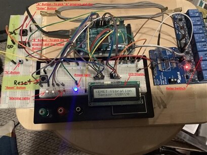

To follow-up on yesterdays blog, I am posting photos of the process:

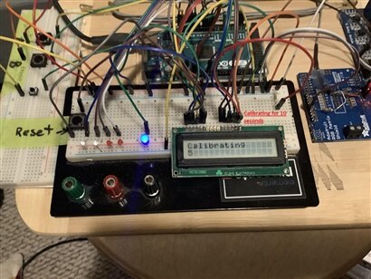

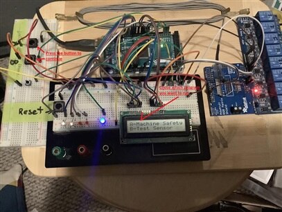

Start-up:
Choose which program
A - Machinery Safety
or
B - Test Sensor
If "A" is chosen: (Set-up with push buttons)
     Starts the "Machinery Safety program".

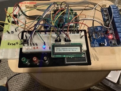

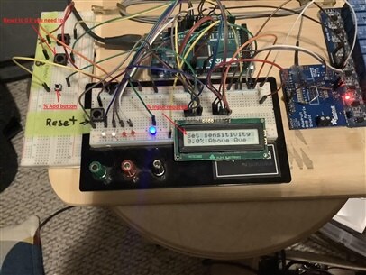

     - First you are asked to enter the maximum percent above average vibration allowable.
          -This is done by pressing push button "C" until your % limit is correct.
          - If you make an error in your %, there is a "reset" to 0 button, "B".
          - When your limit is correct you press the "enter" push button, "A". (As you can see I use these buttons for multiple purposes).
I set the Max above average at 6%

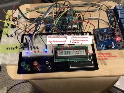

The calibration starts (16 vibration checks in 10 seconds)
       - The program then takes the sum of the 16 checks and divides it by 16 to get the average.
It now takes your % limit to get the shutdown limit.
       - Average + 6%
       - The Shut Down Limit (SDL) is 543.
        - All information is displayed on the LCD.
          - CAL= "Calibrated average"
          - CR= "Current vibration read"
          - HR= "Highest recorded vibration"
          - SDL= "Shut down limit"

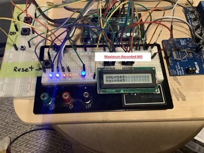

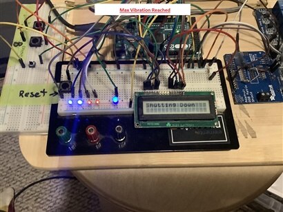

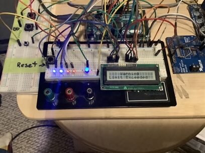

When the Vibration Sensor reads vibrations at or above this limit, it shuts down the machine.

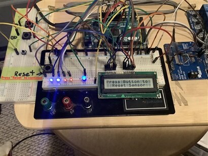

Displays Shut Down Limit & the Maximum reading that caused the shutdown
The reset button must be pressed to continue.
That was the steps taken from start to shutdown. I found that the information displayed on the LCD was very useful information. When I set it up for my CNC I used 6% over calibrated average. When I used 5% it shut down when the x-axis moved and 7% wouldn't shut it down when over-travel happened. The thing I found is that the KEMET sensor is so sensitive that it took me a bit of time to be able to estimate the shut down % required.
