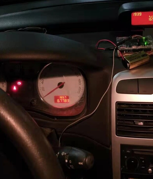

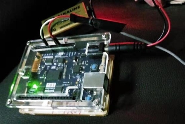

Step 1,Build one portable tool for vibration tracing on car, recording the data from Kemet vibration sensor
Complete with Arduino 101.

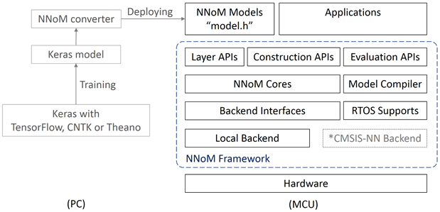

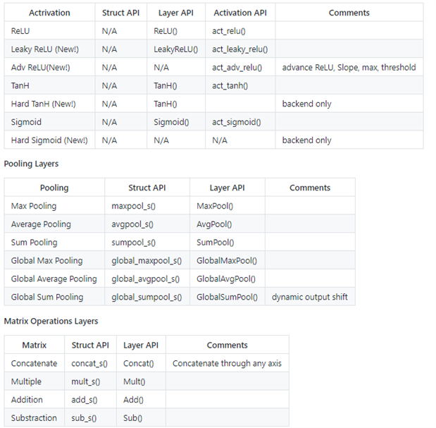

Step 3, Deploy the model on the Embedded platform to be used as predictive maintenance hub.
That is the part I spend most of the effort. I have try tensorflow-lite on STM32F070, STM32G431 and STM32F767-nucleo, PaddlePaddle on desktop, and DeepC in arduino,and NNoM on rtthread RTOS.
That proves not valid for most of the MCUs, Flash restriction can be top one.
While STM32L476RG-nucleo with 1M flash proves valid. But I have to change to arduino 101 for quick deploy. Deploy on MCU can be challenging, but interesting. I think I would better spend more time on one new AI Engine framework for MCU. I would share the progress in blog in this year. I am tire of so many revision-ever-changing rubishes AI engine. But SesiML may be good choice, if not as critical as I am.

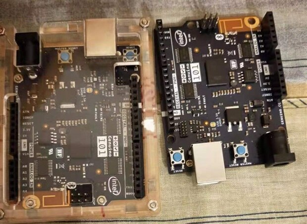

3 Unboxing and Preliminary Functional Test

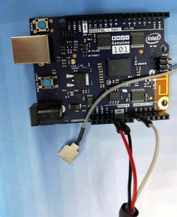

3.1 Unboxing and wiring
Sorry for not post more picture. I start this blog on last day of submission. Deadline is good thing, or I would wander and explore more and provide no output.
The best choice for wiring of this sensor shall be to remove out-of-factory connector, cut the line to fit the length, weld new terminals with similar color and use heat-shrinkage sheath to seal the teminals.
Try use minimal length of wire as possible, that is always good.

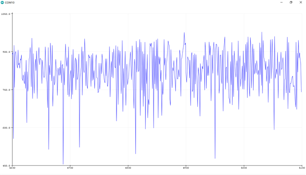

3.2 Data logging with Arduino Serial

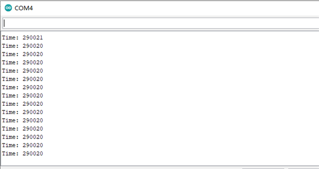

First, test the performance of the sensor. Arduino can provide 10-bit ADC resolution up to 1024, with 512 as still state, 29 milli-second per sample cycle. That is OK for 16kHz specification. Here is simple sketch,
unsigned long myTime;
int st=10000;
void setup() {
  Serial.begin(9600);
void loop() {
  Serial.print("Time: ");
  myTime = micros();
  for (int i = 0; i <= st; i++) {
    int sensorValue = analogRead(A0);
  myTime=micros()-myTime;
  Serial.println(myTime); //prints time since program started
  delay(5000);          // wait a second so as not to send massive amounts of data
Output for Serial Console, With 29us per cycle ADC.
Use data logger for sensor data, be remember, use println() to add "\n" at each data or these is nothing to show.
peak shows the tap to the platform where the sensor is placed. That is very very sensitive.

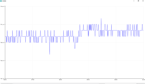

4.1 Comparing with gryo-sensors
This vibration sensor is responsive to Z-axis acceleration, but more sensitive, the gyro-sensor on arduino 101 is Intel-Curie embedded. Not so sensitive and slow in sample frequency. But show similar tendency, it can be cross-check each other.

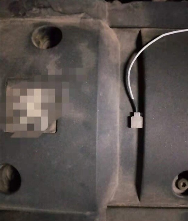

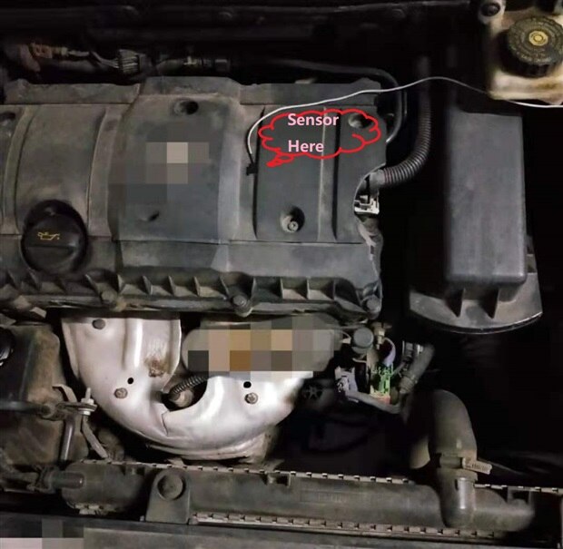

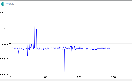

4.6 Car engine to be tested
Just tested to read data with Arduinio 101 data logger. Annotation is difficult simply with arduio, one Human-Machine Interface to select the running-idle-speedup-brake, the car have be mainenance recently and runs well so Fault state data is still not available.

Thanks to the 3m length wire, the vibration sensor can be sticked on top cover of engine and put the arduino 101 inside the car, available for driving state data logging.
Look closer,
With 9V battery plugged, the arduino 101 can be powered by battery.
Start the car, wait for the data to be collected.
Connected the arduino board again with Arduino IDE 1.8.5, the reading is different,
Fetch the data from the board, the data can be used to train the model.

Even there is no final product. I would like to enlight some idea on how to train data. Basicly,
NNoM is best for ARM-M4 core MCU with 1M flash. Refer to https://majianjia.github.io/nnom/  for more. The example uci-inception with UCI HAR dataset can be used as start point, from gyro-sensor combination to model training. https://github.com/majianjia/nnom/tree/master/examples/uci-inception
6.2  The codeing flow shall be
  Input
  Conv
Conv Conv Maxpool
  Concat
  Conv
  Dense
  Dense
  Softmax
The abbrievation means as follows,
Based on The structure of NNoM to deploy on MCU

    Here is the data image
