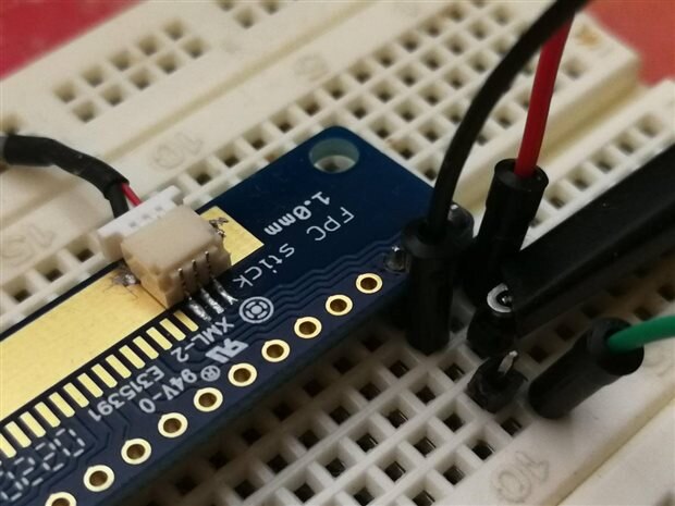

Hardware
I bought bunch of parts listed in previous blog. From those the followings were come really handy.
  • SM03B-SRSS-TB(LF)(SN)
  • Adafruit FPC Stick - 20 Pin 0.5mm/1.0mm Pitch Adapter

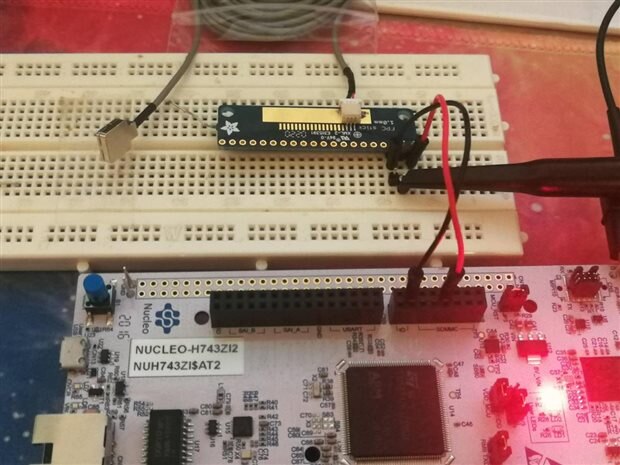

This is how my setup looks like now.
{gallery:width=960,height=750,autoplay=false} My Hardware Setup
My Prototyping Setupimage
Close-up of the SMD Adapter boardimage

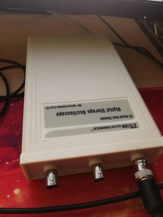

My good old USB oscilloscope that I bought back in Iran about 7 years ago.image

First I used the Nucleo board only as a 3.3V power supply, just to power up the sensor. I used the oscilloscope to do some measurements.

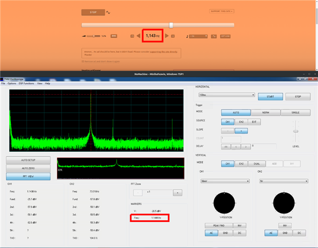

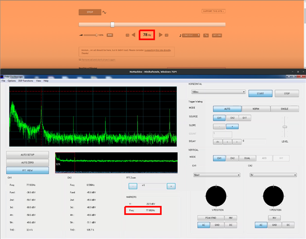

Measuring Sound
I could generate constant-frequency sound using a Tone Generator website and plot the FFT of the signal using the oscilloscope while I was pushing the sensor on top of desktop PC's speaker by hand.The oscilloscope's software can only run on a Windows machine so I plugged the oscilloscope to an old Windows 7 laptop and used NoMachine remote desktop software to take a picture of the screen. So in the below images, the bottom half of the image is showing the Oscilloscope software via NoMachine and the top section shows the Tone Generator website.
{gallery:width=960,height=750,autoplay=false} Sound and the Sensor
1.143kHzimage
78 Hzimage
187 Hzimage

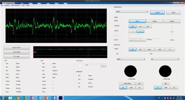

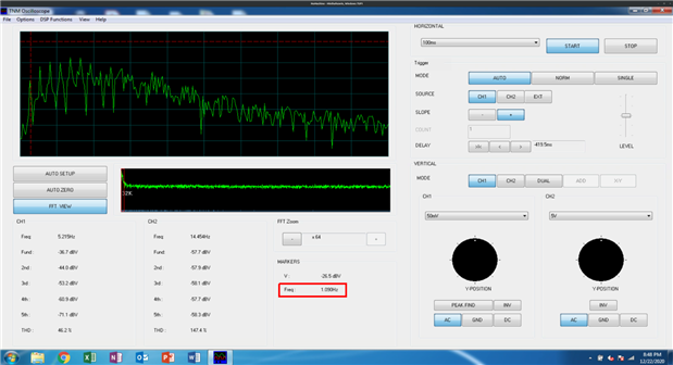

Measuring Heart Beat
Just for fun I tried to measure my heart beat with the sensor. I could not get a good measurement while holding the senor on my wrist. But holding it on my neck could make a good signal. Hear is my heart beat, raw and FFT.So it measures something around 1.090 Hz which is 1.09 * 60 = 65.4 beats per minute. I do not know how accurate it is.
{gallery:width=960,height=600,autoplay=false} My Heart Beat
Heart Beat Raw Signalimage
Heart Beat FFTimage
