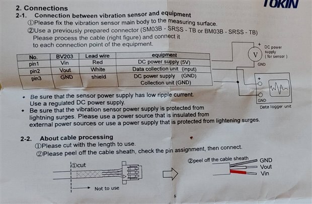

The only requirement for the "experimental design challenge" is to use the vibration sensor. How are you going to use it? I suppose most (if not everyone) will sample the analog signal, but what are you going to use to sample it? Are you going to use the provided STM32 MCU, a different MCU. a DAQ, or something else?
As of me I still haven't decided yet. I got a NI DAQ, a DMM with sampling capabilities and of course a bunch of MCUs and FPGAs. the NI DAQ is probably the easiest to use, its 200 ksps @ 16 bits. Then my DMM could sample up to 1msps @ 16 bits, but not continuously, or at much higher resolution but also a much slower speed. Then the provided STM32 can sample at up to 3.6 Msps @ 16 bits, (and eventually at higher speed through interleaving) but requires much more effort as it needs to be programmed.

    Hi Doug, If you look on page 4 of the manual - the suggested connectors are SM03B-SRSS-TB or BM03B-SRSS-TB, these are surface mount PCB connectors. I think even if you found the cable connectors they would…

    The sensor spec indicates the frequency range is 15KHz and the measuring range is about 1V, so your NI DAQ has more than enough capability. I wish the spec had a frequency response curve but I guess that…

    I will hook it up this weekend and see what I can do with it. The first issue for me will be connecting to the tiny connector - I don't think I have a mating connector yet. It looks to be a 1mm pitch.…

    Hi Doug,
    If you look on page 4 of the manual - the suggested connectors are SM03B-SRSS-TB or BM03B-SRSS-TB, these are surface mount PCB connectors.  I think even if you found the cable connectors they would be too hard to put together unless you had a crimp tool that could handle the small pins.  I wasn't able to find any pre-built cable assemblies so I'm going to try the PCB connectors to see if I can build an adapter.  Probably simplest to just cut it off.  It almost looks like they expect you to do it as there are instructions in the manual on page 5.

  • dwinhold
    dwinhold over 5 years ago in reply to dougw
    In the instruction paper that came with the sensor, it shows an alternative solution for connection.
