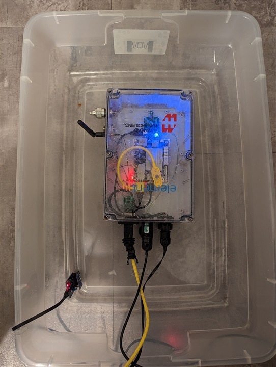

Before putting things inside the enclosure, I did a waterproof test of the enclosure.
For this I put one humidity sensor inside the enclosure.

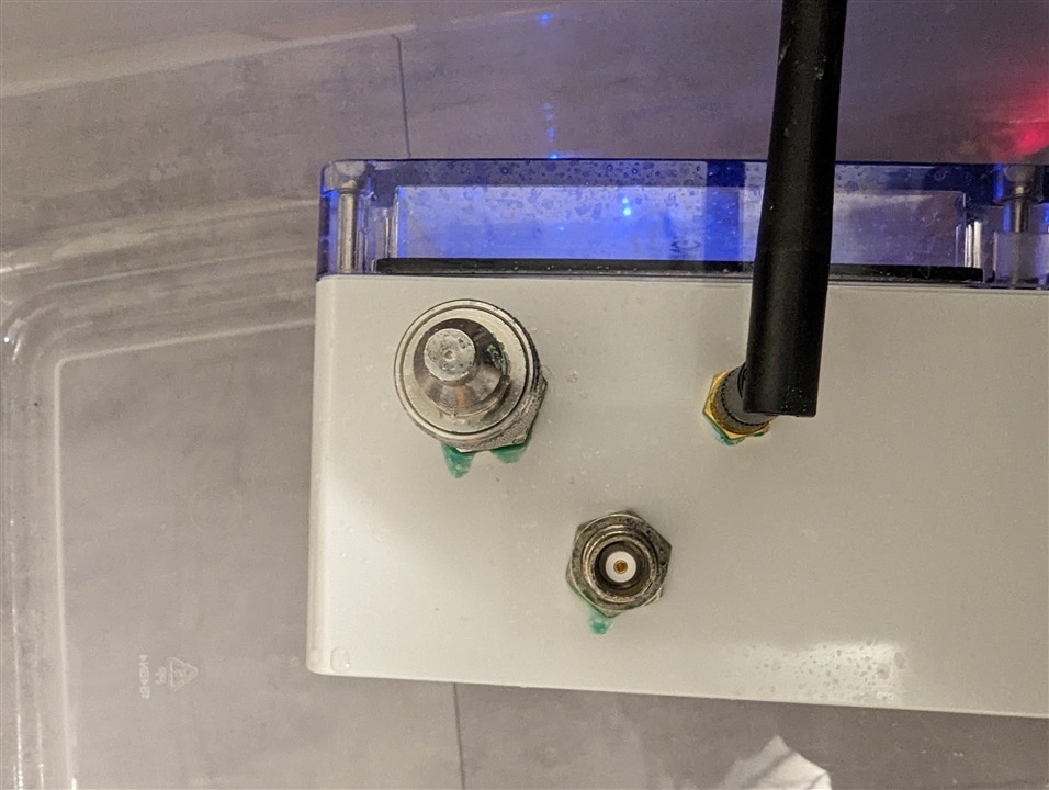

The enclosure was assembled with all the connectors and the Wi-Fi antenna.
This test was useful to identify that the GPIO connector (MRD-BG04-L13-000) was leaking around 40 minutes started the test. image
This wasn't a design failure but it was an installation failure. The cable that I was using didn't meet the gauge requirement for this connector, after fixing this the leaking wasn't happening anymore and the enclosure passed test.

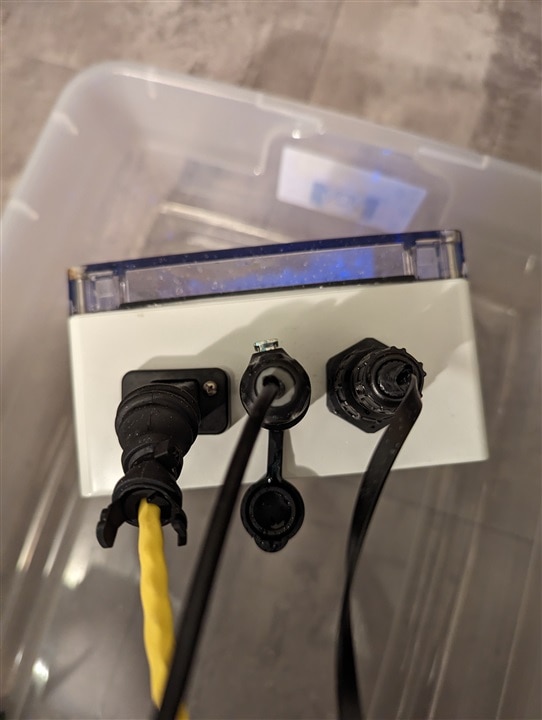

I put the Lattepanda inside the enclosure and a HS3001 devkit from Renesas.
The Lattepanda is connected to the exterior of the enclosure using the USB, RJ45 and GPIO circular connector.

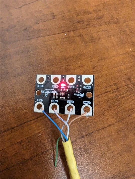

VEML6070 UV sensor.
The original ideas was to monitor the UV radiation inside and outside of the enclosure but I wasn't able to make this sensor works so I didn't use it at the end but it was connected using the RJ45 connector. This feature will be implemented in a future development of this weather satiation.

Splash Test
After the integration of the electronics with the enclosure and connectors I did a splash test using a water flosser as a splasher device. I was monitoring the humidity inside the enclosure the whole test. I find out that the humidity sensor reading is susceptible to the angle of the sensor. This was another successful test, no water ingress.

Salt Spray Test
This an accelerated corrosion test, I prepared a solution with vinegar, salt and hydrogen peroxide. I spray the connector and enclosure with this solution twice a day for 3 days. The enclosure was in a plastic enclosure with a bulb to provide heat and make more effective the test, the temperature was around 40°C.
I put the air quality sensor inside the plastic enclosure, in this chart it's visible the increase of the air quality index, the sensor provides this values so there's no need for extra calculations. The EPA specifies that a good air quality index is between 0 and 50, after 50 and 100 is considered as moderate and between 101 and 150 is considered as unhealthy.
This values doesn't represent that the connector are suffering or anything like that.

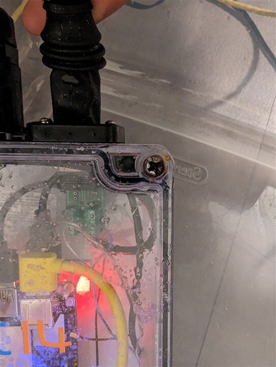

After 3 days, only one of the bolts was getting corroed, my guess is that because I had to assembly and disassembly the enclosure many times in the development and testing, the protection coating in the bolt was damaged.
{gallery}Corrosion Test
No more damaged was identified, even with the corroed bolt I considered this as a successful test, all the connector continue working without any visible damage.
