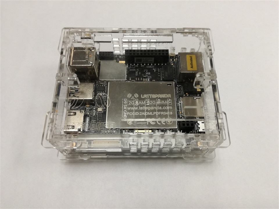

Next - as I am planning to use LattePanda as monitoring station - I have decided to install it in dedicated enclosure. I have bought acrylic one - like this:
LattePanda v.1 acrylic enclosure
Inside the packaging one can find two acrylic, paper covered boards that are containing all the elements and one page assembly manual.
Assembly process is a little tricky - acrylic elements need to be gently removed as they are somewhat brittle and during the assembly enclosure behaves as some sort of 3D puzzle, but at the end it turns out to be sturdy and even can be opened again if some care is taken to not damage corner braces.
Final effect can be seen on the photo below (well - semi-final - without Wifi antenna. That's why the case needed to be opened again)
LattePanda enclosure

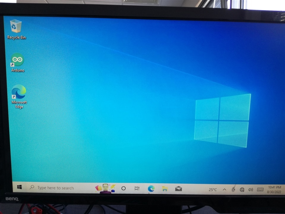

So - lets connect power supply, monitor, keyboard and see what happens...
After brief time Windows 10 desktop appeared:
Win10
but as our monitoring software is Linux-native we will need to reinstall the OS.

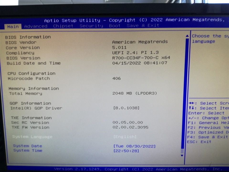

After downloading recommended Clonezilla image of Ubuntu 16.04 LTS (Long Time Support) (and MS Windows image for CR700 H/W version just in case - it is paid for in our version after all) and preparing boot USB drive using Rufus software minor inconsistency was encountered . Manual states that simply inserting USB drive and rebooting initiates installation, but in my case Panda booted into Windows every time.
So - we will need to change boot disk order. As in any PC computer, pressing dedicated key during reset enters BIOS/UEFI. In case of LattePanda, that key is ESC.
This way we entered familiar UEFI/BIOS interface:
Bios1

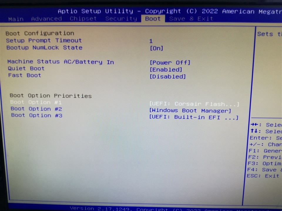

then, on "Boot" tab changed boot order to prefer USB disk
bios boot order
and after reboot installation has started. System image seems to be dedicated to another H/W version (CR200) but it installs correctly on our hardware.

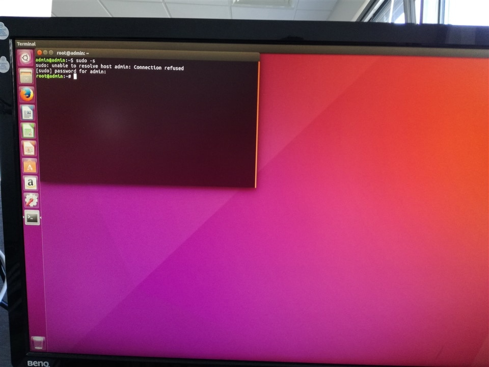

Installation process progressed as in the manual and at the end we got  working Ubuntu GUI (login using admin:admin)
Next step - install SSH server and enable remote access. After connecting Ethernet cable system automatically got address using DHCP, but then repository problem appeared.
After issuing
apt-get update
apt-get install openssh-server
error message appeared informing about unmet dependencies. It turned out that the system used repository mirror at
http://mirror.neu.edu.cn
that seems outdated. Replacing all references to http://mirror.neu.edu.cn with http://archive.ubuntu.com/ in /etc/apt/sources.list file, then re-running
apt-get update
installed openssh server correctly. Then let's install some monitoring tools
