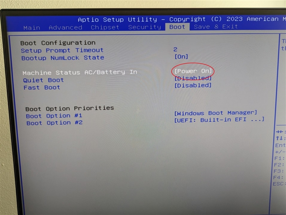

I was having some problems with the Lattepanda software, I had to reinstall Windows, when I was doing it I found in the bios that you can enable a function that turn the lattepanda on when power is provided.

    I ended up doing that too. Once the enclosure is buttoned up, it's pretty painful to get to the power button . I've seen that some people add a remote power button, but I don't really have a need for…

    Basically I was trying to clean some space in the limited eMMC and ended with a system that doesn't work anymore. I tried to reinstall using the image from their site but doesn't work because everything was damaged. So, I reinstalled the bios and then windows, it's straightforward if you know what files you have to use, but at first I was using the incorrect ones so I wasn't having any progress. The user manual that comes in the Lattepanda box mentions the Z8300 but the actual processor that it's in the board is the CR700 z8350.

    maybe you were bitten by the same problem as I have experienced - manual says: insert usb disk, cycle power and it will reinstall.
    It assumes BIOS boot order of: "USB drive then internal disk", but in my case it was "internal disk then USB drive". Had to change boot order and reinstall gone as stated in the manual...

    That's right, I had to change the boot order
