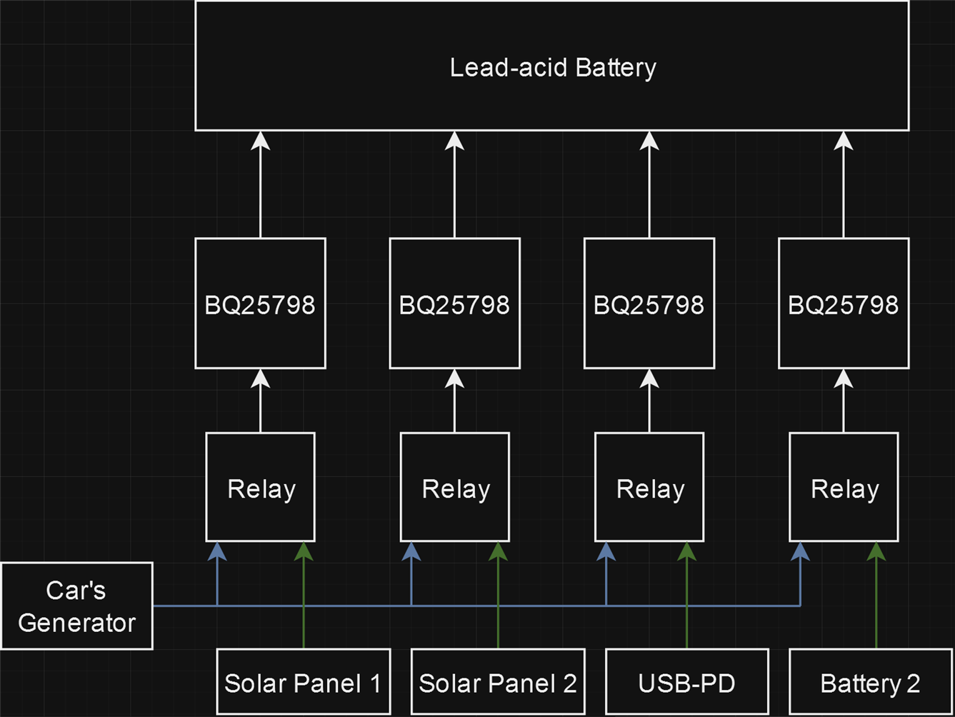

I also decided to add a relay at the input of each BQ25798, so I could choose from two input sources for charging. One of the inputs on each charger will be connected to the car’s generator, so the batteries can charge while the car is running, while the other input on each charger will each serve different purposes. The first two chargers will have the option to use a solar panel as an input power source, the third charger will be for USB-C charging, and the last one is for a second battery to charge from.
Charging system block diagram

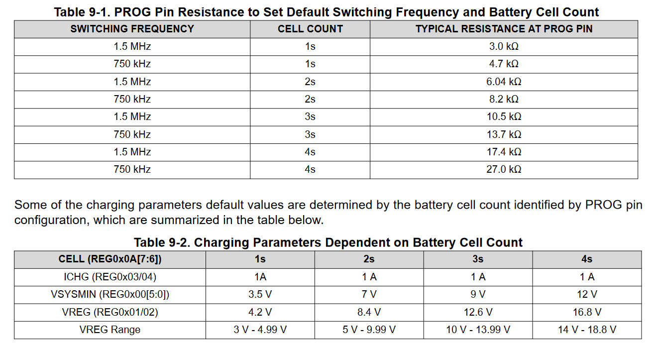

To charge a 12V lead-acid pack, I had to change several configuration registers. The first and most obvious one is charge voltage. A “default” voltage is configured with a resistor, but the exact value can be changed over I2C:
BQ25798 cell count configuration resistor and possible charge voltage ranges
I had to use a 27k resistor on the PROG pin to configure the IC for 4S charging, which would let me adjust charge voltage between 14 and 18.8V over I2C. However, the default charge voltage would be 16.8V, which is bad.
To work around this issue, I removed the temperature sensor resistors on the PCB, to immediately put the charger into a fault state on powerup. This prevents charging, until I manually disable the temperature monitoring through I2C. This means I can change the charge voltage first (and configure everything else too), then disable temperature monitoring to start charging.

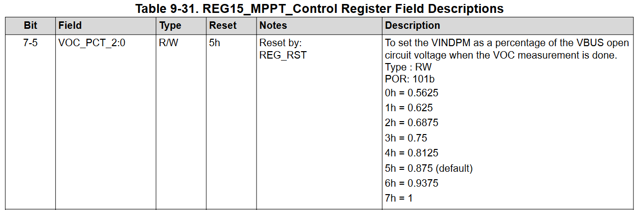

Most of these are self-explanatory, the only one worth talking about is MPPT. Unfortunately, the BQ25798 doesn't support "proper" MPPT, instead, it measures the open circuit voltage once in a while, and uses a preconfigured percentage of that open circuit voltage as the input target voltage.
Here are the relevant parameters of my solar panel:
Solar panel datasheet excerpt
The ratio of open-circuit voltage to voltage at Pmax is 18.6V / 22.9V = 0.8122. These are the available options on the BQ25798:
BQ25798 MPPT configuration register
I also set "VOC interval" to 2 minutes, and "VOC delay" to 2 seconds, which is how often charging is interrupted and for how long to wait for the input voltage to stabilize, to measure the open-circuit voltage.

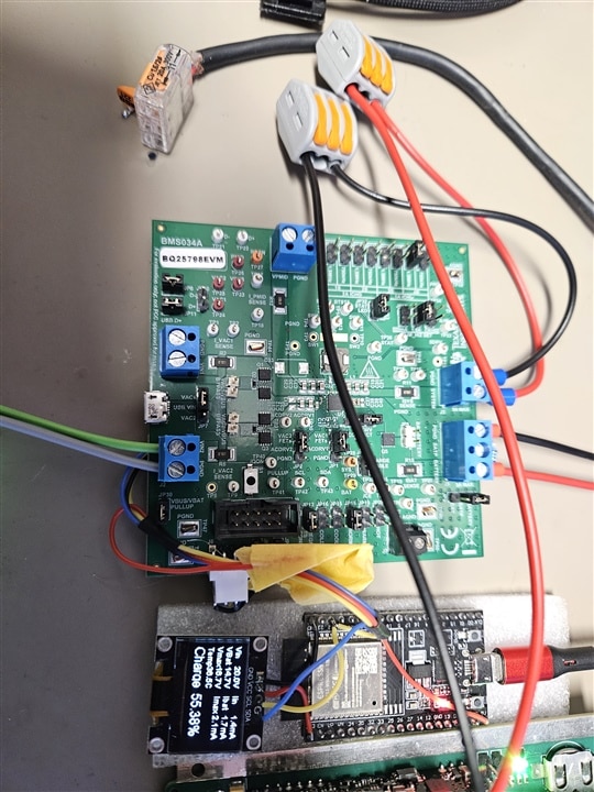

  • kessito
    kessito over 1 year ago in reply to vmate
    imageI got things working nicely with you library, thanks for that!
    I would also like to make a smaller pcb (perhaps a pcbway) than the EVM, would you share your pcb files? (I don't know what software you used, a friend of mine has Altium)

    You shouldn't actually need to do a lot on the Arduino side to make it work, they are mostly autonomous, but I highly suggest reading through the datasheet, everything is explained very well.
    The tl;dr is that you need disable temperature sensing if you don't have a thermocouple, as that will force the charger into an error state. Also enable the ADC, and set up the watchdog if you need it. Adjust charge current limit and input current limit as you wish, or change the maximum charge voltage within the range specified in the datasheet.
    #include <Wire.h>
    #include "bq25798.h"
    BQ25798 bq;
    void setup() {
        bq.begin(&Wire); // Initialize library
        bq.reset(); // Reset BQ internal registers to start from a "clean" state
        bq.setADC(BQ25798ADC::ADC_15BIT); // Enable ADC in 15-bit mode
        bq.disableTS(true); // Disable temperature sensing, if no TS is present, charging won't start without this
        // Optional stuff, check datasheet for default values and explanations
        bq.setChargeCurrentLimit(2.2); // Max current into battery = 2.2A
        bq.setInputCurrentLimit(2); // Max current into charger = 2A
        bq.setChargeVoltage(16.6); // Override default target charge voltage. For example, when configured for a 4S battery("9.3.2 PROG Pin Configuration" on page 25 in datasheet), this would be 16.8V by default.
        bq.enableChargingSafetyTimers(false); // Check datasheet for details("9.3.9.4 Charging Safety Timer", page 44). If the charger is powered for a long time, the charging safety timer will stop charging after a while.
        bq.enableTermination(false); // Disable charge termination
        bq.setWatchdog(BQ25798Watchdog::WD_2S); // 2 second watchdog, if expires, BQ is reset to default settings. If no thermistor is present, this means charging is stopped.
        bq.configureMPPT(BQ25798MPPTVOCRatio::VOCPERCENT_0_8125, BQ25798MPPTVOCDelay::VOCDELAY_2S, BQ25798MPPTVOCInterval::VOCINTERVAL_2M); // Configure MPPT with 81.25% Voc ratio, 2 second delay before measuring Voc, measure Voc every 2 minutes.
        bq.enableMPPT(true);
