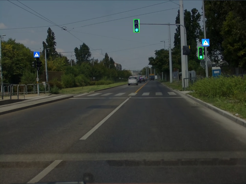

For training such an object recognition model, a vast dataset is required. I could not find anything ready-made that fits my usage, so the only option left is to make my own.
The first step is capturing a lot of driving footage. With the video streaming system implemented in my previous blog, this was made very simple. All I had to do was use my car as regular, and video files automatically started gathering on my server.
The next step is to extract frames(images) from the video. I could just extract every single frame, but that would result in millions of images, most of them not even containing objects I care about. My preferred method of doing this is playing the videos in VLC Media Player, and using its “Take video snapshot” feature. I rebound the keyboard shortcut for this to the “S” key, and all that’s left is to play the video at 3x speed and mash “S” whenever something interesting is visible. VLC will save the frames in .png format to my home folder, ready for labeling.
I used Roboflow for manually labeling the images, the free version was enough to do this. Going through every single image, a rectangle needs to be drawn over objects that I want the model to later recognize, and also given the correct label, identifying what sort of object it is.
A labeled image
