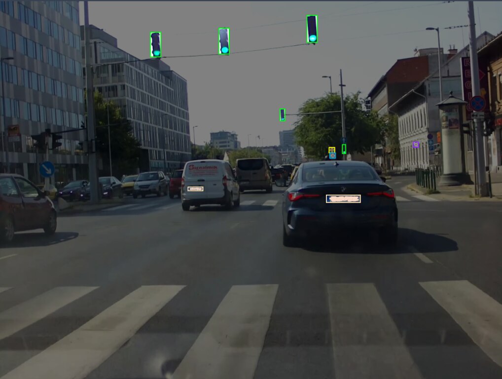

First, I downloaded a copy of my dataset from Roboflow in the “YOLO Darknet” format. The “train” and “valid” folders will be the important part. The dataset consists of .jpg files, and a .txt file along with each image, sharing the same filename.
The text files contain the object locations within an image, for example:
33 0.3143888888888889 0.11387037037037037 0.0204375 0.06477777777777777
9 0.6836111111111111 0.5178148148148148 0.06678472222222222 0.019287037037037037
33 0.4489722222222222 0.10475925925925926 0.020270833333333335 0.06766666666666667
33 0.6222222222222222 0.07262962962962963 0.020493055555555556 0.07066666666666666
9 0.3927777777777778 0.49181481481481476 0.029625 0.009916666666666667
10 0.6610902777777778 0.3902777777777778 0.011076388888888889 0.013888888888888888
33 0.5638888888888889 0.29814814814814816 0.009722222222222222 0.03148148148148148
33 0.6849652777777778 0.3876203703703704 0.006458333333333334 0.02325925925925926
23 0.8263541666666667 0.3760092592592592 0.010118055555555555 0.01349074074074074
29 0.6625416666666666 0.4045 0.010694444444444444 0.013657407407407408
The first number corresponds to the class, the next two are the center coordinates for the object, and the next two are the width and height of the object. Visually, it looks like this:
An image from the dataset with object bounding boxes overlaid

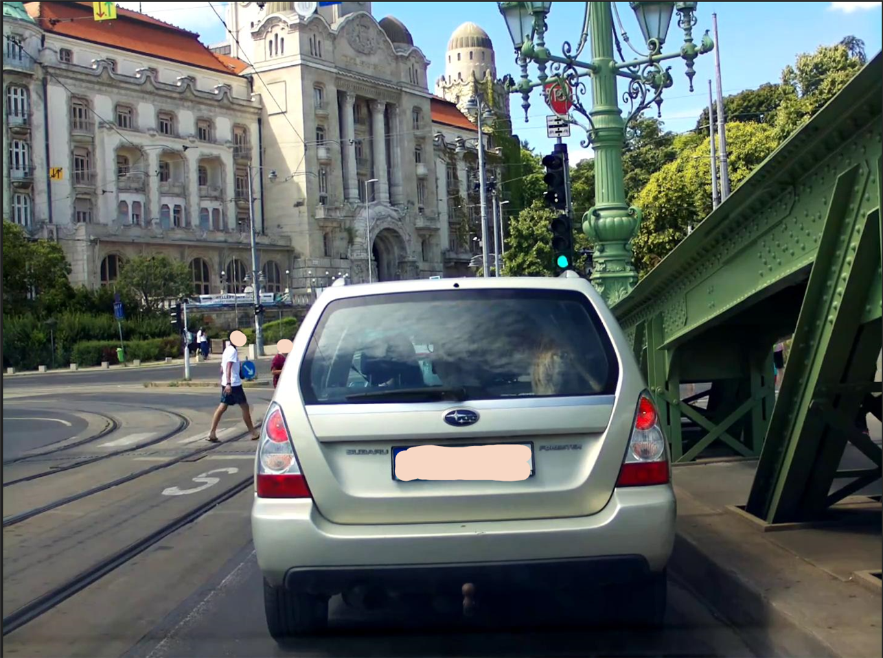

A test image from the dashcam
It missed a hard to detect stop sign, partially obscured by a lamp post, but found the license plate and green traffic light.
I changed the code a bit to continuously do detection on the input image, so inference speed is measurable, removed the GUI code, and added prints for the detection coordinates:

license_plate     [ID]:9
   Confidence: 0.939913
   Bounding box: (649.313, 720.74, 837.862, 785.383)
trafficlight_green     [ID]:33
   Confidence: 0.982014
   Bounding box: (904.06, 349.958, 927.044, 441.191)
(the input image was 1440x900)
With this, I get roughly 2 seconds per frame. Not great, but workable. It is theoretically possible to speed this up further, the Zynq-7020 looks like could fit a very slighly larger DPU, and a newer YOLO model with faster inference speeds might also be supported.
