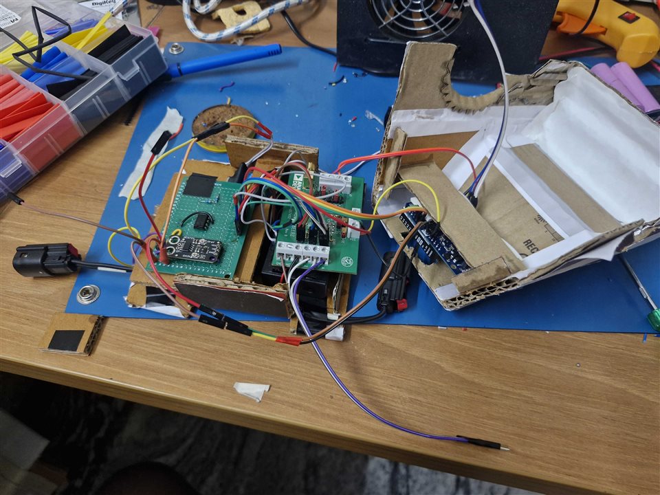

Rather than routing all sensors to a single centralized microcontroller—creating a single point of failure—EVA Guardian decouples vehicle intelligence into two modular nodes:
Figure 2: EVA Guardian High-Level Technical Architecture
Figure 3 — Detailed Technical Architecture: Signal conditioning front-ends, dual Arduino UNO Q SBCs, RS-485 bus, and redundant battery failover routing
The Three Architectural Pillars:
  1. Decoupled Responsibilities: Battery chemistry tracking and vehicle motion dynamics operate at fundamentally different timescales (10 Hz vs. 42 Hz) and are managed by independent processors.
  2. Differential Industrial Bus (RS-485): High-current motor controllers generate severe electromagnetic interference (EMI). Differential signaling over twisted pair via Analog Devices ADM3068E transceivers ensures zero packet loss in harsh electrical environments.
  3. Isolated Redundant Power Architecture: The Safety Node contains its own power management circuit and backup 2S battery pack, completely independent of the main traction bus.

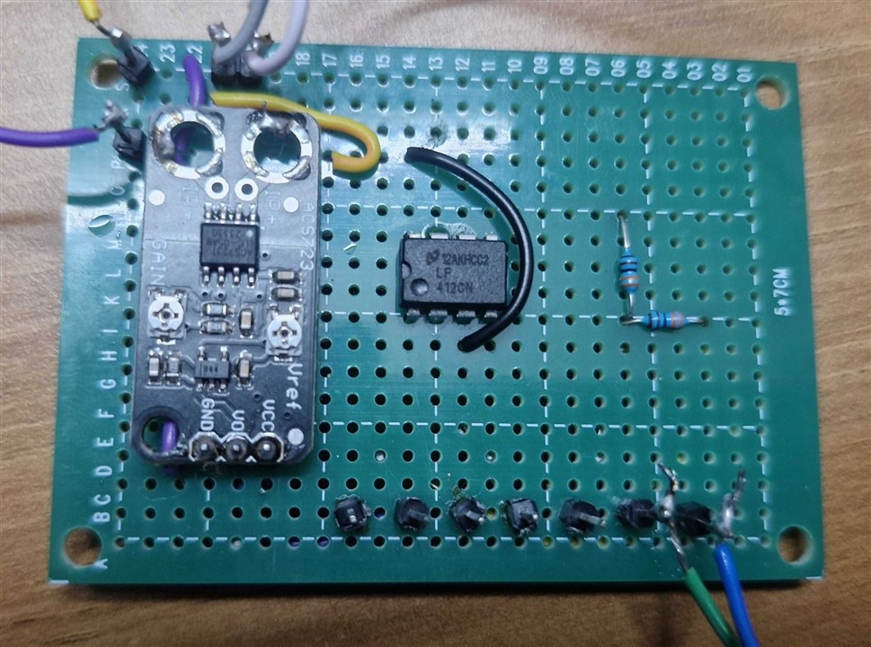

Precision analytics require clean, calibrated sensor signals. The analog front-end (AFE) of the Battery Node was designed to maximize signal integrity on the Arduino UNO Q's 14-bit ADC (0−16383 counts).
Figure 4: Precision Measurement Circuitry on Veroboard: LF412 buffer stage, ACS723 Hall-effect sensor, NTC bridge, and HX-2S-A2 protection module.
1. High-Impedance Pack Voltage Buffer (LF412)
Directly connecting a resistive divider to an ADC causes impedance loading errors. A precision divider (R1 = 6.8 kΩ, R2 = 3.0 kΩ) scales the 8.4V peak voltage down to a safe 2.57V. An LF412 dual JFET op-amp configured as a unity-gain voltage follower (10¹²Ω input impedance) isolates the divider, preventing ADC sampling charge-injection from skewing the measurement:
Vbattery = VA1 × (6.8 kΩ + 3.0 kΩ) / 3.0 kΩ = VA1 × 3.2667
2. Isolated Bidirectional Current Measurement (ACS723)
An Allegro ACS723 Hall-effect linear current sensor is placed in series with the battery load:
  • Galvanic isolation eliminates ground loop noise.
  • Calibrated zero-current quiescent voltage: Vref ≈ 1.70 V.
  • Sensitivity: S ≈ 1.336 V/A.
Ibattery = (VA0 − 1.70 V) / 1.336 V/A
(Negative current indicates discharge through load; positive indicates charging).

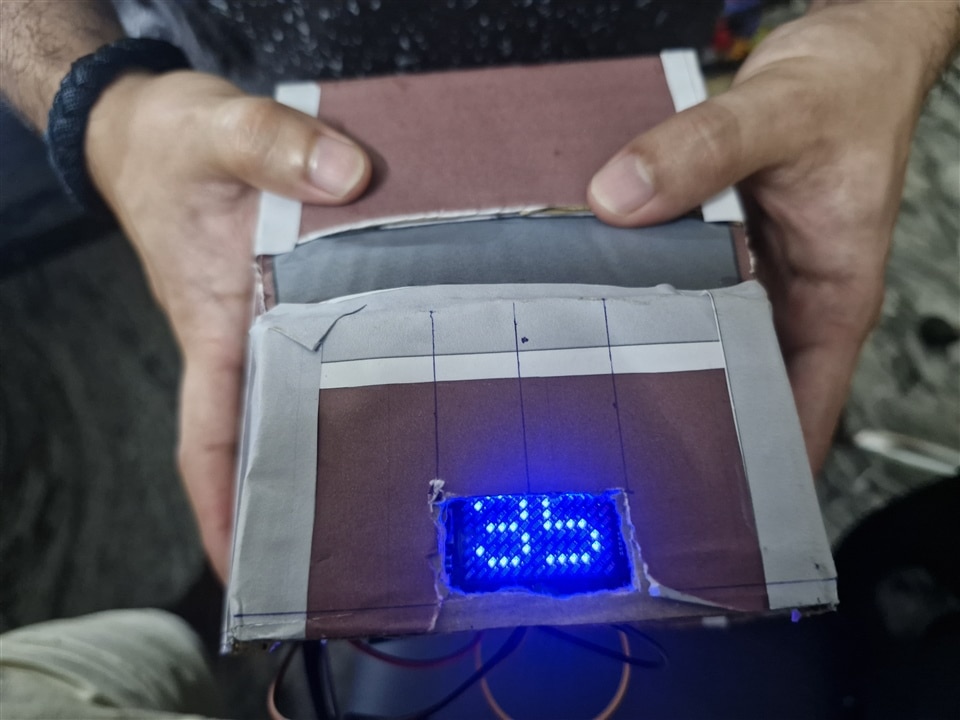

4. Interactive Electronic Spirit Level on LED Matrix: During normal operation, the Arduino UNO Q's 8×12 LED matrix dynamically renders an electronic water level mimicking a physical spirit level based on pitch and roll calculations. In an emergency, it instantly transitions to a high-visibility flashing SOS banner.
Figure 6 — Interactive Displays: Electronic spirit-level water animation on Arduino UNO Q LED Matrix.

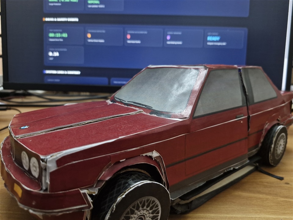

Physical Scale Demonstrator & WebUI Dashboard
To validate EVA Guardian in a realistic physical environment, a scale-model electric vehicle chassis was constructed:
  • Spatial Separation: Rear compartment houses the primary 2S battery pack, HX-2S-A2 BMS, and Node 1 electronics.
  • Cockpit Integration: Front compartment houses the Incident Detection Node, backup battery pack, power transfer relay, and onboard matrix display.
  • Harness Routing: Distinct cable channels for high-current power lines and differential RS-485 twisted pairs.
  • Live WebUI Dashboard: Real-time web browser interface providing comprehensive telemetry: live pack voltage, current, temperature, SoC%, SoH%, 3D orientation visualizer, connector health status, and diagnostic error codes.

• Video 5: Integrated Scale Electric Vehicle Demonstrator
Description: Final review of the integrated electronics housed within the scale electric vehicle model, showcasing harness segregation and cockpit indicators.

1. Managing Switching Noise in ADC Lines
Implementing unity-gain LF412 op-amp buffers and firmware-level Exponential Moving Average (EMA) filtering reduced measurement noise by over 90%.
