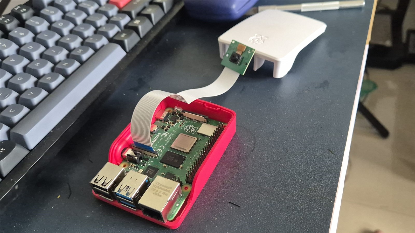

Installing on Debian / Raspberry Pi
OpenCV comes with Aruco support built in. On Debian or Raspberry Pi OS (I am running Mainsail OS for Klipper as i am repurposing an existing RPi):
pip install opencv-python-headless
sudo apt install -y python3-picamera2

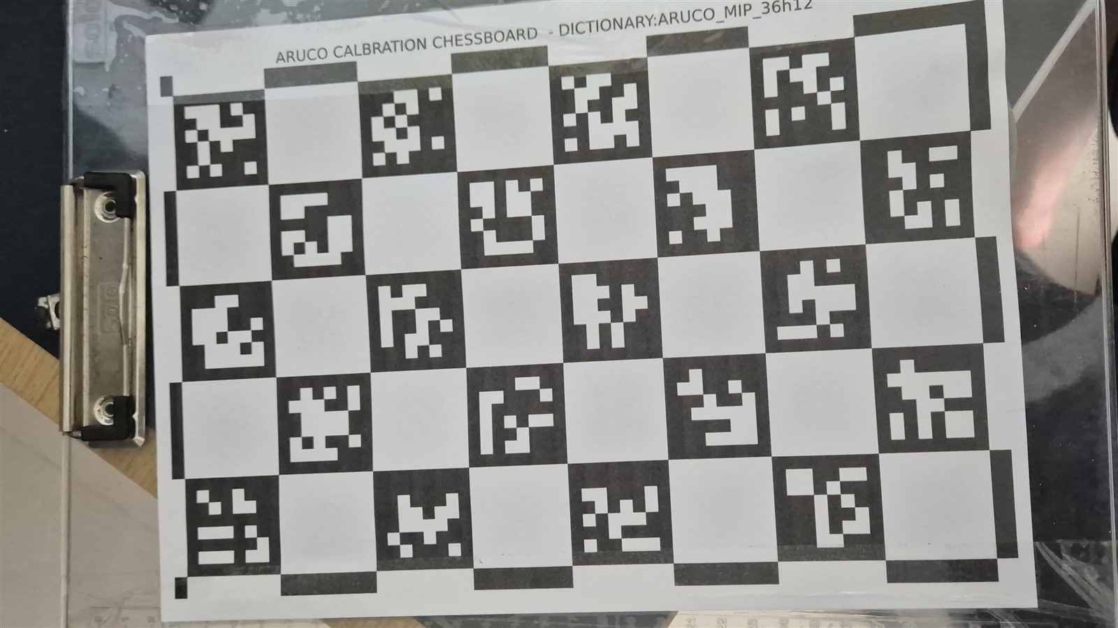

Camera Calibration
Before you can get an accurate 3D pose from a marker, you need to calibrate the camera. Every lens introduces distortion. I am not getting into details because I forgot the theory. But what I do know is that to calibrate, you need a known target. I used an 8×5 Aruco MIP 36h12 grid board with 35 mm markers which i found online.
You show the board to the camera from different angles and distances - at least 5 frames, more is better. OpenCV's calibrateCamera then solves for the camera matrix and distortion coefficients by matching the known 3D corner positions on the board to where they appear in each image.
Calibration quality is measured by RMS reprojection error - how many pixels off the estimated corner positions are from the detected ones. Below 1.0 is good. Above that and your pose estimates will drift. Calibration only needs to be done once per camera and is saved to disk. After that it loads automatically on server start.

Step 3 - Camera Calibration Workflow
I added calibration commands to the server. The workflow from the client is:
  1. Print or display the 8×5 Aruco MIP 36h12 board
  2. Send cal_add while holding the board in view at different angles - tilt it, rotate it, bring it closer and farther
  3. Collect at least 15 frames with good variation
  4. Send cal_compute
elif action == "cal_add":
    frame = grab_bgr()
    corners, ids, _ = detector.detectMarkers(frame)
    if ids is not None and len(ids) >= 4:
        obj_pts, img_pts = cal_board.matchImagePoints(corners, ids)
        if obj_pts is not None and len(obj_pts) >= 4:
            with cal_lock:
                cal_frames.append((obj_pts, img_pts))
                count = len(cal_frames)
            send_msg(conn, {"status": "ok", "message": f"frame {count} added"}, ...)
elif action == "cal_compute":
    rms, mtx, dist, _, _ = cv2.calibrateCamera(
        obj_pts, img_pts, (FRAME_W, FRAME_H), None, None)
    if rms < 1.0:
        _save_calibration(mtx, dist)
        msg = f"RMS {rms:.4f} - saved to disk"
    else:
        msg = f"RMS {rms:.4f} ! too high - tilt/rotate board more and try again"
On the server, cal_add calls cal_board.matchImagePoints() to get 3D-to-2D point correspondences for that frame. cal_compute accumulates all frames and calls cv2.calibrateCamera():
If the RMS is below 1.0 the calibration is saved to disk and loaded automatically on the next server start.

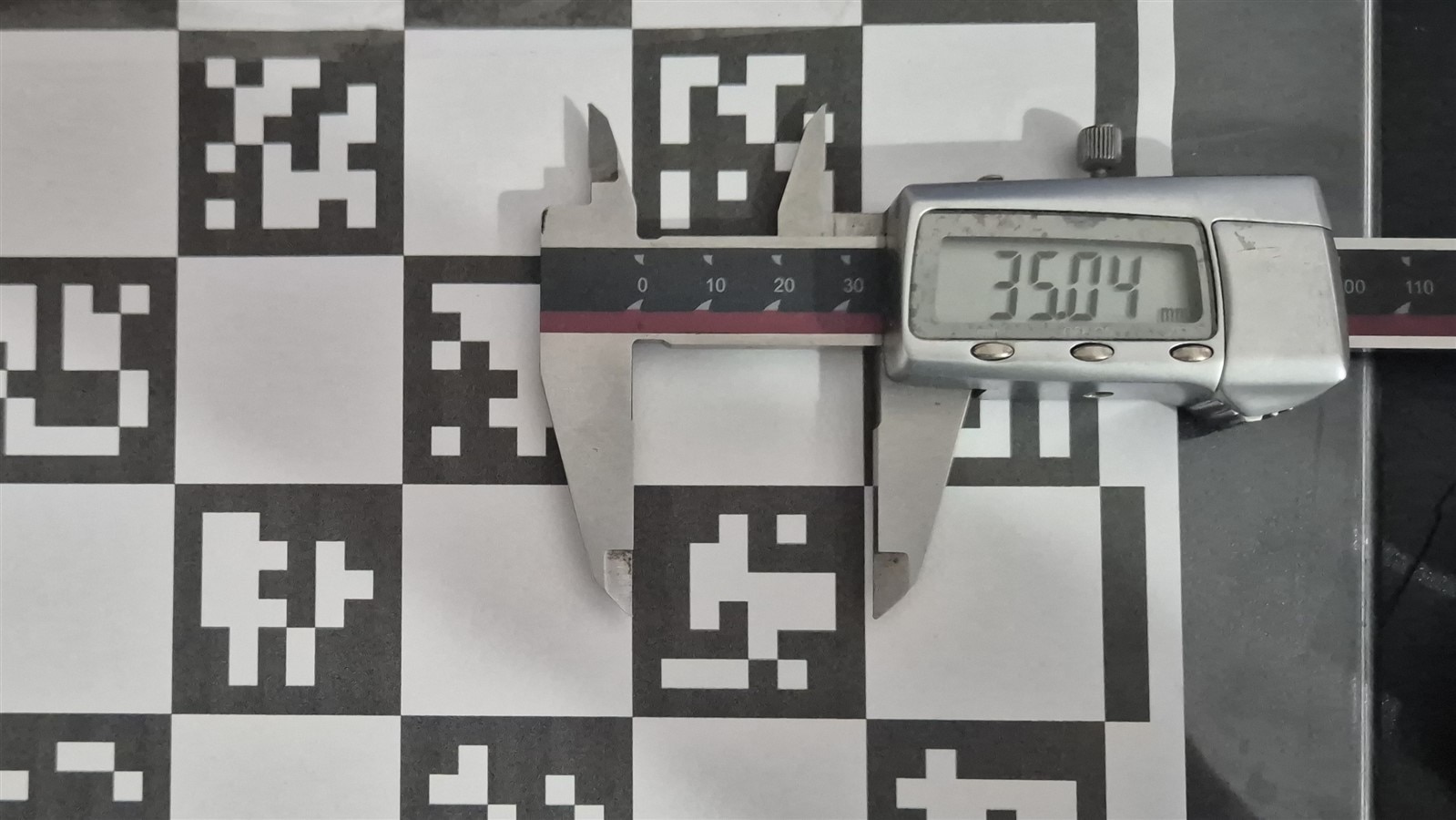

One thing to be careful about: the calibration board markers are 35 mm, but the dock markers I printed are 80 mm (larger because the camera may be placed further away in deployment). These are separate constants in the code:
CAL_MARKER_LENGTH = 0.035   # metres - calibration board markers
MARKER_LENGTH     = 0.080   # metres - dock markers used for pose estimation
Mixing them up gives you pose distances that are off by the ratio of the two sizes. The calibration board size is only used during calibration to define 3D object points. The dock marker size is used later for pose estimation.
