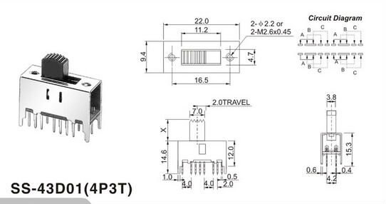

HI all,
I'm in the process of building a model crane,
i'm using an arduino with a motor control IC to operate three motors separately along with a 10K potentiometer to adjust the rotational speed,
!! What i'm having trouble with is !!
I have  a 4P3T Slide switch that i want to wire up as FORWARD/OFF/REVERSE, but i have no idea what im doing i have a circuit diagram of this from the interwebs but still no clue on what to do,
any help would be greatly appreciated
THANK YOU!!!!!!!!!!image
    0 dougw over 9 years ago
    There are 4 switches with 3 positions each where all 4 switches have an A position a B position and a C position.
    Since they are all on the same lever all 4 switches are in the A position at the same time or all in the B position or all in the C position.
    There is one switch in each corner and its 3 positions are represented by an A-B-C.
    The drawing shows which contacts are shorted in the A position with a solid line.
    The contacts that are shorted in the other 2 positions are shown with dotted lines.
    To reverse a single motor you need a 6 3-position switches, so it will be tricky to use this switch to independently reverse 3 motors.
    It can do 2 motors easily.
    Make the B position the OFF position.
    The wiper of switch 1 (the long contact in the drawing is the wiper contact) goes  to one motor terminal.
    The wiper of switch 2 goes to the second motor terminal
    The A terminal of switch 1 and the C terminal of switch 2 are connected to the PWM signal
    The C terminal of switch 1 and the A terminal of switch 2 are connected to ground.
    The same scheme on switches 3 and 4 will handle a second motor.

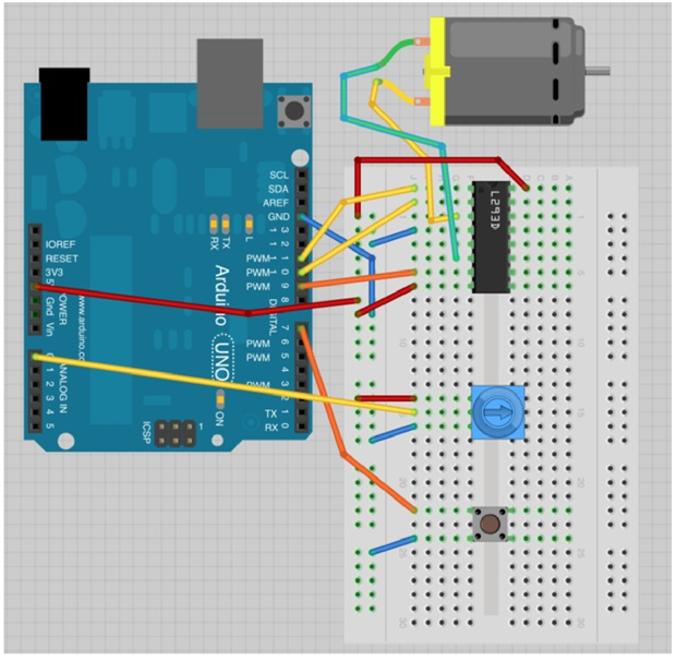

    The idea is to use the arduino to swap the direction of the motors
    i have this code from an adafruit tutorial i was just going to expand on it for the other two motors
    /* Adafruit Arduino - Lesson 15. Bi-directional Motor */
    int enablePin = 11;
    int in1Pin = 10;
    int in2Pin = 9;
    int switchPin = 7;
    int potPin = 0;
    void setup() {  pinMode(in1Pin, OUTPUT);
    pinMode(in2Pin, OUTPUT);
    pinMode(enablePin, OUTPUT);
    pinMode(switchPin, INPUT_PULLUP); }
    void loop() {  int speed = analogRead(potPin) / 4;
    boolean reverse = digitalRead(switchPin);
    setMotor(speed, reverse); }
    void setMotor(int speed, boolean reverse) {  analogWrite(enablePin, speed);
    digitalWrite(in1Pin, ! reverse);
    digitalWrite(in2Pin, reverse); }
    this is how they have set it up, i just want to use a 3 position switch so i had on/off/on or forward/off/reverse

    Hi Hayden
    That L293D chip can already reverse the direction of your motor.
    So your 3 position switch could be connected in place of your pushbutton.
    That way the reversing would be done through the arduino program according to the position of the switch.
    In this case you only need to use one pole, or one corner of the switch (lets say switch one)
    You connect GND to the wiper of switch one (terminal B)
    connect Arduino pin 7 to terminal A
    connect Arduino pin 6 to terminal C
    Then modify you code so that:
       it runs the motor in forward if pin 7 is pulled low,
       runs in reverse if pin 6 is pulled low.
       sets the speed to zero if neither pin is pulled low
    The code should look something like this
