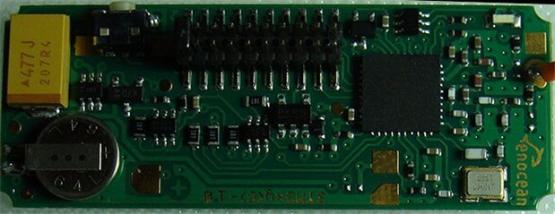

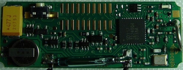

First I wanted to compare the two STM3xy modules and see what the difference was between them. The most obvious difference is that the STM332 has a very small pitch (1.25 or 1.27mm) 20 pin header attached to the board with a jumper over a pair of pins, and the STM329 has a reed relay attached to the board. The header on the STM332 is for adding an optional humidity sensor to the module, however if reconfigured the module will support additional features, exposing IO lines and analog inputs.
STM332 Temperature Sensor Module
STM329 Magnet Contact Transmitter Module
I overlaid the images across each other and made an animated gif that switches back and forth.  The only other standout change aside from the antenna (whip vs helical) that I noticed is that the STM332 also has an additional transistor and what looks like a capacitor to the right hand side of the pin header.
The chip on these appear to be a Maxim SD317 ultra low power energy harvesting RF Tx for below 1Ghz, I can't find any additional details or datasheets on these other than the one page that said what they were, so I'm wondering if perhaps they came from Maxim's custom ASIC design services or are a top secret design with non-discolsures and all that good stuff.
I wanted to find out how the temperature was sensed on the STM332, I was somewhat hoping that there was an external thermistor or something along those lines. This would mean that one might be able to remove the thermistor and inject another carefully crafted signal in there. I placed my finger across the chip and pushed the teach-in button to send the current status, as my finger rested there the temperature steadily rose.  When I took my finger away it cooled down, I'm pretty sure that the temperature sensor is built into the main processor.  I also tried warming up the transistor device next to the header but that seemed to have no effect, I was thinking maybe it was a temperature sensing diode.
It seems that with the temperature sensor as is there is not much hacking to be done. More flexibility can be revealed by re-configuration.

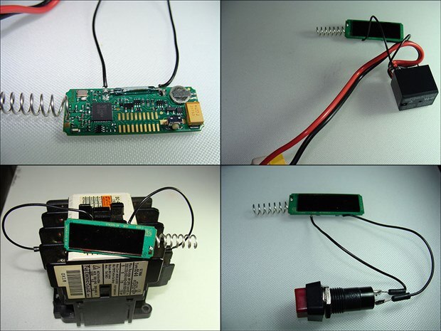

Next up was the STM329 Magnetic Contact Transmitter Module. This board doesn't have the header, it just has a reed relay. I measured 640mV between the left pin and the right lower pin. It's either actually ~640mV or there is a high value current limiting resistor and the load of my meter is pulling the voltage down, I don't have a Hi-Z (high input impedance) setting on my meter at home.
I attached a couple of flying leads to either contact point on the reed relay and attached a variety of switches to it. They all worked when connected, but I did notice that RF noise from the small relay would cause the sensor to false trip. I'm willing to bet aflyback diode across the coil and connecting all three leads to the relay would cure that.
I also tried to see if the magnetic field from the small relay coil was able to trigger the reed switch on the EnOcean module. With the black relay energized I wiped the reed relay along the 5 exposed surfaces but I could not get it to close, I guess in this case the magnetic field is not strong enough, but other relays or solenoids may do the trick.
I would not bother to run long lines from the reed relay, with the voltage so low as it is, any additional resistance could quickly bring it down even lower and prevent it from working reliably.

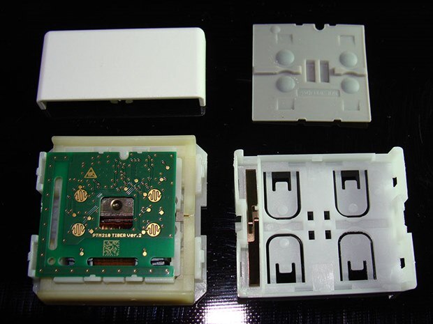

Finally I took the switch apart and poked around inside there a little bit.  It is not difficult to disassemble.  The top rocker lever comes off, there are 4 capture points which can be released with a screwdriver and then the top shell can be carefully snapped free with some persuasion.

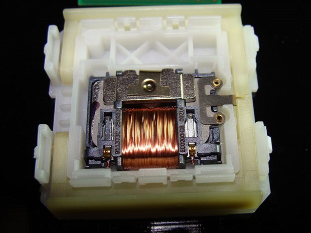

In the top right corner is the silicone rubber keypad. On the bottom right is the cap, with the button shields and return spring for the energy bow (the yellowish colored lever). On the bottom left is the main board for the switch with the 4 switch pads.  You can see the ECO 200ECO 200 energy harvester module aka the 'Electrodynamic Energy Converter' beneath the circuit board.image
Here's a better view of the ECO 200 energy harvester.  There is a piece on the right shaped like an E  when the middle leg is pressed down it generates and electrical impulse in the coil which exits at the two gold contacts near the bottom of the coil, the contacts press against the PCB, powering it with each press. I think that's a pretty cool design! The spring is designed to 'snap' the arm on the ECO 200 so i guess it needs a good bump to generate usable power.

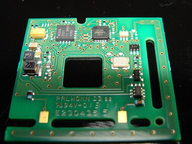

Next is the main PCB from inside the switch. You've already seen the back, so let me show you the front. It's design is quite a bit different from the 3xy boards.
The antenna appears to come down on the right hand side and across the bottom, it's been via stitched the whole length.  In the upper left hand corner seems to be a 4.7uf capacitor. The chip on the left is a Texas Instruments MSP430 microcontroller and the Texas Instruments CC115L IC on the right is a low voltage/low current mixed frequency range FSK transmitter. I think this is interesting because the STM332 and STM329 sensors are both single chip solutions. There's also a bunch of stuff on the board to finesse the pulses from the EC200 energy harvester into usable power.image

    Thanks Douglas, those are some good alternative ideas. My experimenting was pretty much just to see if the reed switch would passively act as a reed relay with the magnetics from an existing relay but I had no idea of the field strength and no real expectations as to the results. I'm sure you're correct about the field being self contained by the armature and some of the other methods you suggested would be effective options. I won't be in a position with my project to need to use it that way but wanted to try it out anyways.
    dougw over 12 years ago
    Good job Johnathan,
    Relays are designed to channel as much of their magnetic field as possible to closing the relay, so there shouldn't be much field leaking out. If you want the relay to activate the reed switch you may need to take an old relay apart and just run the coil with no metal (magnetic completion) around it, or you could try channeling the field through the reed switch. If you want to sense a relay coil maybe you could put a second (sense) coil in parallel.
