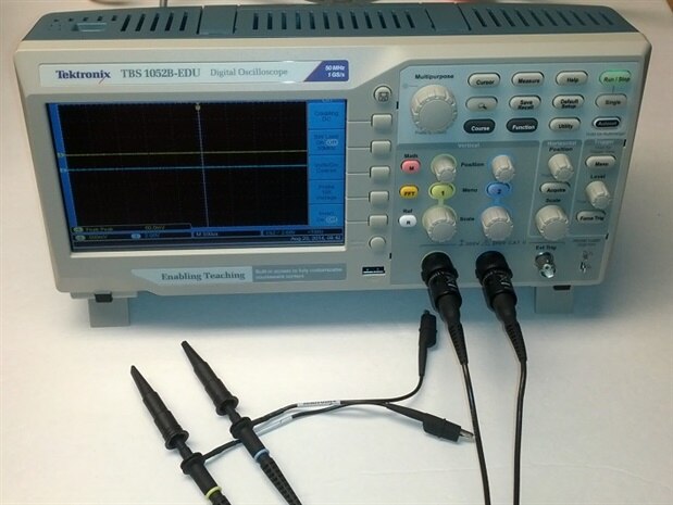

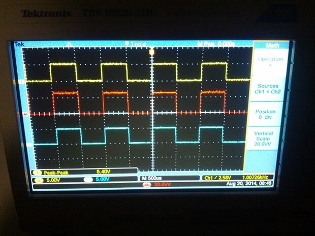

The Tektronix scope is very nice, compact and has a lot of nice features built in. I'm certain it's going to come in handy for several tasks in my project.  I've just included some photos I took before I left. I'll be sure to make some video when I'm testing my current and voltage monitoring setup interfacing with the EnOcean modules.

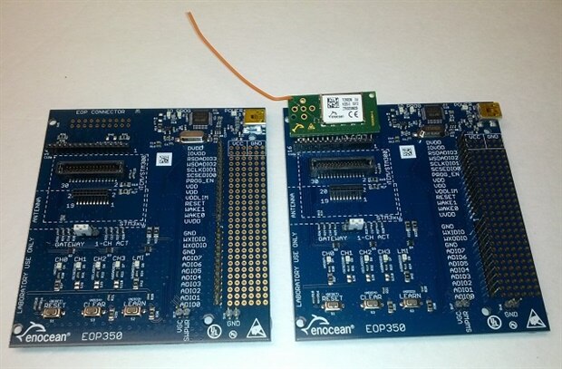

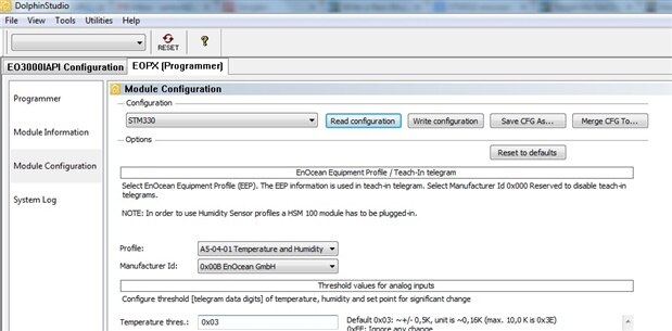

I see some people have received two Raspberry Pis and it seems I am the lucky owner of two EOP350 universal programmer boards.  One came earlier with the HSM100 humidity sensor module I had requested and another one came in the same box with the Tektronix TBS1052B-EDU oscilloscope and it also included a TCM320U module.
With the programmer it was very easy to change the configuration of the TCM332 to enable the humidity sensor. The standard openHAB distribution didn't have support for that configuration so I started up Fhem and it reported that the STM332 did not have an EEP or manufacturer ID associated with it. I went back into EnOcean DolphinStudio and set the manufacturer ID to EnOcean GmbH and then it picked up the sensor and the temp, humidity, set-point and switch values. Although with that ID it shouldn't be picking up anything for the set-point or switch values, it does.

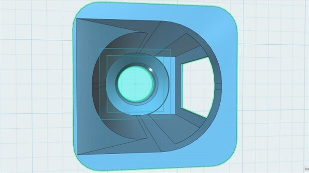

I drew up a holder for the STM332/HM100 pair. It has an opening for an aluminum pipe on one end, and the other end is wide open.  The idea is to drill holes in the side of the aluminum pipe to allow the hot humid air into it, mix it with normal room air, and then down past the sensor.  Because the sensor is limited to 40C max and is not conformally coated, I don't expect it would work right with direct exposure to the full dryer exhaust temperature and humidity, but instead just bump the readings up a small amount and see them decline as the clothing dries. Whether this can work remains to be seen, however here are a few photos of the design of the sensor holder so far.
I drew this up quickly in Autodesk 123D free version.

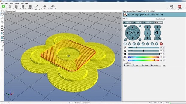

Ran it through my scratch built printer using ABS filament, I use Repetier for the firmware on my setup.

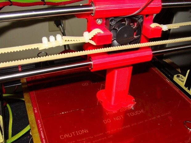

This is the print in process, this is actually a fluorescent red material which looks great under black-light, but it makes it difficult to take pictures of, it has a bit of a glow to it. Also, even with the 'mouse ears' to help hold it to the platform it lifted off the Kapton a little so I used a solderng iron to weld the front-right corner back down.

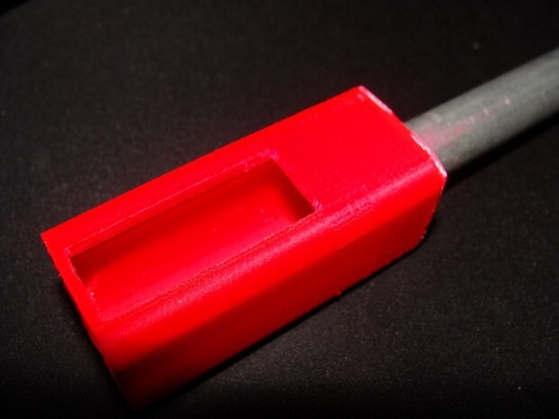

Here's what the sensor holder and inlet pipe look like, ready to be drilled for the hot and humid air inlet and the cool room air mixing holes. I'll let you know how it goes once I get back home.
