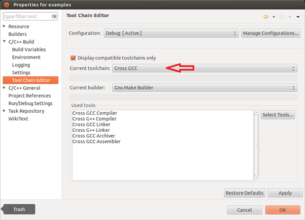

  4. All the three projects does not compile out-of-the-zip. Some changes in the configurations were required. For each project, I had to open the Project Properties window and change the following settings (make the changes to all the build configuration you want to use - I'm going to use ReleaseLib)
    • C/C++ Build -> Toolchain Editor
      • Set "Cross GCC" in the "Current toolchain"
    • C/C++ Build -> Settings -> Tools Settings
      • Set Prefix to arm-linux-gnueabihf-
      • Set Path to the full path of the toolchain (/home/gpavoni/rpi/tools/arm-bcm2708/gcc-linaro-arm-linux-gnueabihf-raspbian/bin/)

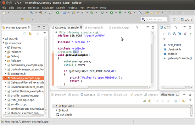

  3. In the "examples" project, open the Gateway_example.cpp file and change the #define SER_PORT to "/dev/ttyAMA0"
  1. In the "examples" project, open the sandbox.cpp file and uncomment the "gatewayExample()" line and comment the "ptmExample();" line

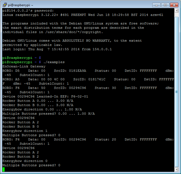

  4. Next step is to free the serial port on the Raspberry board. Follow this exceptionally clear tutorial: Free Your Raspberry Pi Serial Port | Raspberry Pi Spy
  5. Now launch ./examples from you home directory
  6. Press buttons on the EnOcean sensors and you should see telegrams coming through
