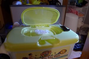

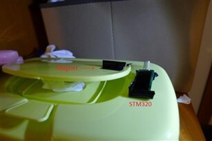

The small size and energy harvesting capability means it fits in small places, like the diaper wipe box.  We’re always forgetting to close the diaper wipe box and it dries out.  The EnOcean reed switch sensor is great for monitoring if the top is left opened too long.  And you can use OpenHAB on the Pi to remind you to close it.
