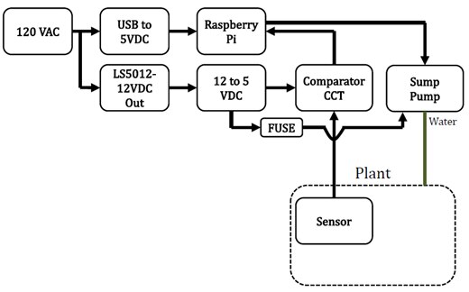

Functional Diagram
Figure 2 shows the functional diagram of the plant watering system. I will be building this system with the components I receive from Newark. I've also purchased a few prototyping boards from Amazon to put the comparator circuit on.
Figure 2: Watering System Functional Block Diagram.
120 VAC - The mains voltage in North America.
LS5012 – Lambda-Tek power supply. 12 VDC out.
USB to 5 VDC - Standard Pi Power Supply unit. MWS158-0502200UC
RASPBERRY PI - Model B+
12 to 5 VDC - LT1529CT-5
FUSE - 2A fuse to protect the sump pump. It's in water after all.
COMPARATOR CIRCUIT - Circuit to determine when the soil is at the low and high thresholds.
SUMP PUMP - Estone DC 3.5V - 9V 3W USB Submersible Water Pump Aquarium Fish Tank Fountain Pond Pump (Amazon)
SENSOR - Funduino soil moisture sensor.
The Comparator Logic
The sensor will be powered by 3.3 Volts. The output swings from 0V to 2.3V, where 2.3 Volts is when the sensor is in water. Since the Raspberry Pi does not have a built-in ADC, we'll have to be a bit creative in reading the sensor output. I'm not concerned with the with the exact moisture level, just whether or not it is above or below set thresholds. My proposed system involves a dual comparator with a low threshold on one comparator and a high threshold on the other. The logic of the system can be deduced from Figure 3.
Figure 3: Comparator circuit logic
The soil moisture signal appears on both non-inverting inputs of the two comparators. The high and low thresholds are set through resistive dividers and placed on the two inverting inputs. The two outputs, High and Low, will be logic level signals that I can read with the Raspberry Pi, which means no ADC is required.
Suppose the low and high soil moisture thresholds are set at 20% and 80% respectively and the soil has a moisture reading of 50%. As the moisture drops to below 20% the raspberry pi will read a ‘0’ on the outputs of the comparators and trigger the sump pump to periodically water the plant until 80% soil moisture is reached. At this point the raspberry pi will read a ‘1’ on each output of the comparators. The plant will not be watered again until the soil moisture goes below 20%.
