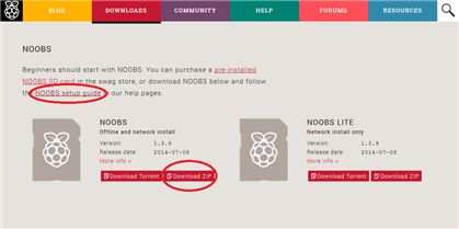

1. Go to Downloads | Raspberry Pi and download NOOBS. Below I have shown an image of the website. Click the Download ZIP link to get NOOBS and click on NOOBS setup guide to see a video about setting up NOOBS.

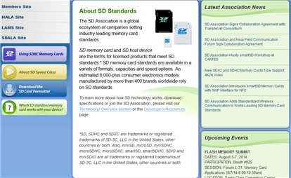

2. Download the SD card formatting utility from www.sdcard.org

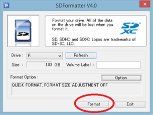

3. Insert your SD card into the computer's SD card reader, run SDFormatter, and format the SD card.
