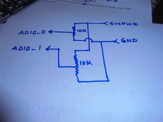

Interfacing Two Analog Input (ADIO0 and ADIO1) with STM330.

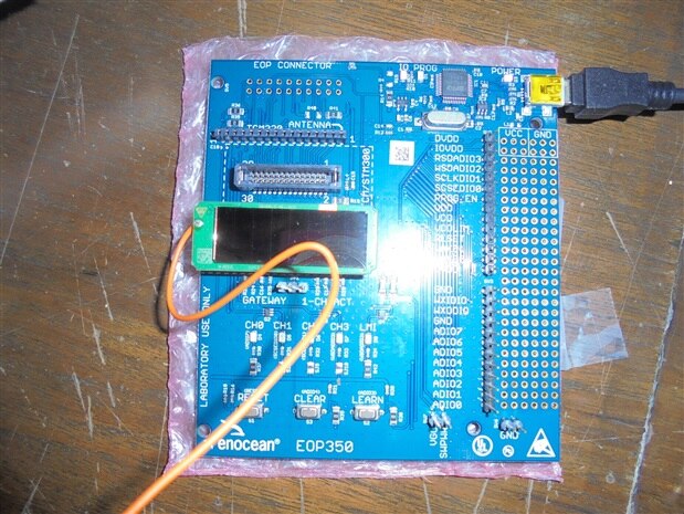

Step2 : Attach STM330 on EOP350 Programmer and Power-up EOP350 from USB port of PC.

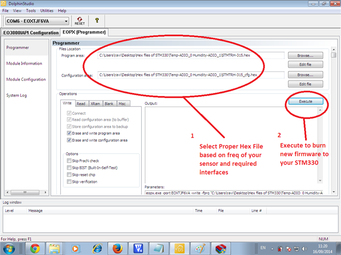

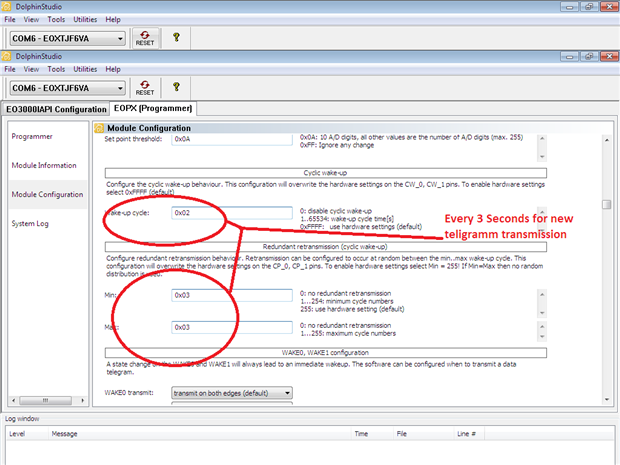

Step4 : Select EOPX Programmer Tab and set File location from unzipped attachment as per your STM330 Freq and required Interface, finally Execute to burn new firmware to your STM330.

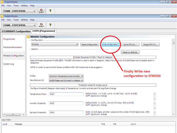

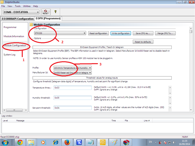

Step5: Still Default EEP profile is A5:02:05 (T Only) with Hardware configuration, Change this to A5:04:01 (T-H) and some extra setup to override hardware setting for Redundant transmission and wakeup cycles timing To speed up testing.
Step 6: STM330 is ready with new firmware... Now it works with power supply from EOP350... So dont remove STM330 from EOP350 because new firmware send out teligrms quickly and solarcell  cant provide enough for power at this transmission rate...(after testing you can reconfigure redundant transmission and wakeup cycle to control it from hardware to save power by decreasing transmission rate)

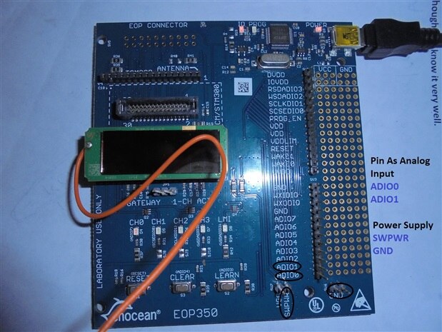

Step 7: Hardware Setup for ADIO_0 and ADIO_1 on EOP350

Step 11: run openHAB ....move pot of ADIO0 and ADIO1 and see the readings on openHAB URL.... ENJOY.....
