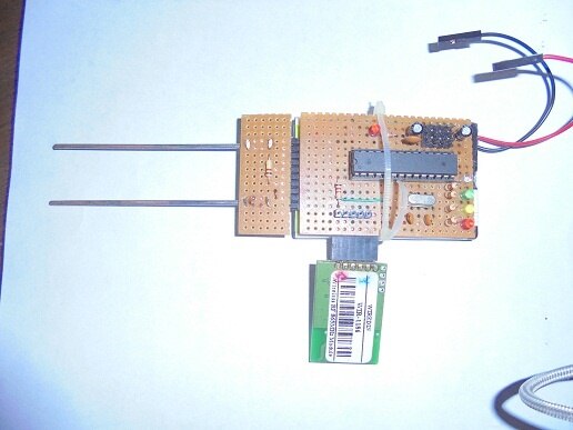

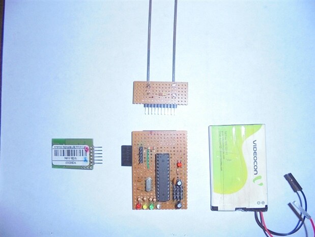

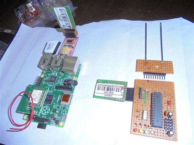

Today in this post I will share my remote arduino which uses sleep mode for power optimization... and used as sensor node to interface remote smoke, LPG Gas leakage and Soil moisture level sensor....
Parts Used :
1. ATmega328P with Arduino bootloader

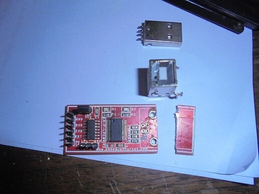

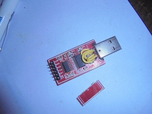

2. USB to UART converter FT232 based

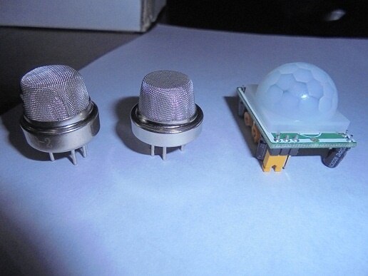

3. LPG Leakage Sensor and Smoke Sensor (As output of this sensor is digital I have mimic it with switch)
4. Soil moisture sensor (I have Home Made but you can buy from here...)

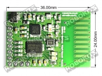

5. RF transceiver (Wireless RF Serial Link 865-869MHz 2KM range [WIR-1186] - $12.00 : Robokits India, Easy to Use, Versatile Robotics Kits.…)
6. crystal and some Descrete components for place arduino on custom PCB.
Before moving ahead let me make this clear that My remote sensor nodes are no way compatible with enocean sensors in term of security and power optimization... But I have tried my best to optimize power, improve security and make it reliable too...
Some description on Important parts...
RF Transceiver (Wireless RF Serial Link 865-869MHz 2KM range [WIR-1186] - $12.00 : Robokits India, Easy to Use, Versatile Robotics Kits.…)
I am using this because It supports Sleepmode (only 10uA) , Encryption so its possible to fulfill Low power requirement of battery operated sensor node and its secure too... As it supports wide input voltage (5-9V DC) range as per Datasheet... and it works fine with 4.2V lithium battery... As It works on 3.25V DC (BA325 LDO on Transceiver)
So there is no need of power hungry voltage regulator at sensor node... I will be simply use 4.2V Rechargeable Lithium battery from my old cell phone to power-up both Arduino and Transceiver at remote sensor node...
DataSheet : http://www.robokits.co.in/datasheets/WIR-1186_RobokitsIndia.pdf

A short video of my arduino based low power soil moisture sensor node....
Here is My Arduino code with sleep mode for both mcu and transceiver for Soil moisture sensor for remote monitoring of my Basil plant ....
here I have set Sampling interval for sensor is 8 second so sleep time is 8 second... it can be easily increased by counting and compering a variable.... as per need

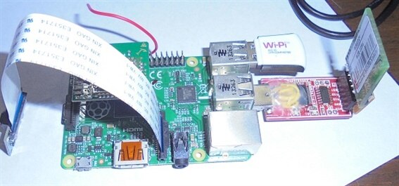

Communication rule of Sensor Nodes with raspberry pi is as follows...
Sensor Node Packet: <SensorID>*<Value>#<HomeID>
where,
SensorID Range AA,AB,AC.... to ZZ
HomeID Range AA,AB,AC..... to ZZ
Value Range As per Double Variable
example: AA*-3.47#XX
AA=SensorID
Value=-3.47
XX=HomeID

Here are few pics of setup raspberry Pi with my RF Transceiver and FT232 USB to UART converter...
I have changed usb connector for direct plug in with Pi...
Here are few pics of my configurable chip-chap sensor node.... with addon soil moisture sensor...
i am using main MCU atmega328 board I have designed for my Quad.... But in near future I will re design the same only for Sensornode
Next step is designing addon sensor board for my sensor node with gas, smoke and PIR sensors...

    shabaz over 12 years ago +1
    Agree with Frederick, nice board mod!! What sensors are you using? I've not experimented with gas/smoke sensors, so I was just curious. Will also be interested to see how they are tested! : ) Cheers, Shabaz…
  • ravi_butani
    ravi_butani over 12 years ago in reply to shabaz +1
    I am using mq2 as smoke sensor...it also works well for LPG gas leakage sensor....but for LPG leakage sensing I m using mq6 because it is more accurate for LPG gas sensing.... As testing you mention at…
  • ipv1
    ipv1 over 12 years ago
    Very nicely done. The USB mod and the cellphone battery jump. Looks like you are progressing nicely.

  • fvan
    fvan over 12 years ago
    Nice mod on the USB connector! image
