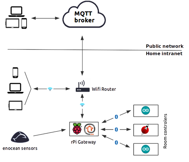

The following diagram depicts my basic idea :
This project will consist of three main modules:
1. A Gateway module to interface between the network and room controllers. This module is responsible for taking the taking the status reports send by each room module and update this  status to user. Also, for the enocean sensors which are deployed in each rooms this will act as a direct gateway to the system.
Hence :
     1. Gateway between user and home.
     2. Gateway between different controllers in rooms.
     3. Gateway of enocean sensors to the system.
Gateway will also be running a database to store the collected information for future visualization.
2. Room Controllers : Each room will be having individual controllers which will be updating current room status to the gateway and also switching the devices according to the commands from gateway. This module is responsible to the ambient condition measurement and forwarding it to the gateway. I'll be using arduinos/launchpads as room controllers with associated sensors.
3. User Interface : This module is will be the part user will be presented with. I'm planning to use the default openHAB UI.
So basically this is how it's going to work. You can setup the network by connecting the gateway module to your Wifi/Ethernet router. All the controller modules are connected to your gateway module. Once your gateway module is connected to you home network, you will be able to access the UI from you PC/tablet/smartphone which is also connected to your home network. This part does not require an internet connection to work. Everything is managed inside your home network. When you enable MQTT broker services in your gateway module, you will be able to monitor and control your home via public network.
For those who are new to MQTT, it is a light-weight publish/subscribe messaging protocol mainly used for machine-2-machine(M2M) communication. You can find more information at MQTT. But MQTT is just a protocol, we need softwares which can talk this. Eclipse Paho is a project which provides opensource implementation of tools and libraries of M2M protocols in a handful of different programming languages. openHAB also has MQTT bindings. We'll be using these bindings in our gateway module with openHAB. A good reading about why we need MQTT for communications can be found in IP Post 2: Designing A System Of IOTs- Rant! by ipv1.
