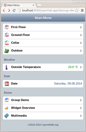

And that's it. Finish. Lets test our demo site by going to webrowser and entering
http://localhost:8080/openhab.app?sitemap=demo
And remember to use a webkit based browser( chrome/safari ). If you use firefox, you'll be presented with a clunky UI.

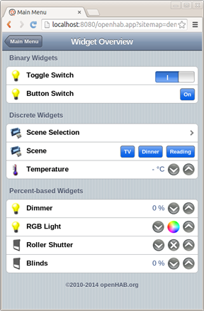

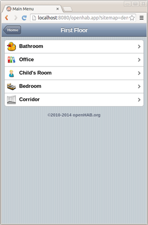

These are a few screenshots from Google Chrome( Version 36.0.1985.125 )

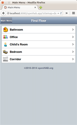

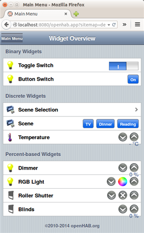

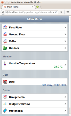

and the same screenshots from Firefox 31.0
So it's pretty much clear -- Firefox messes up the UI.

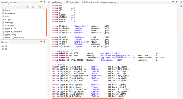

Now download and unzip openHAB-Designer to some directory. Open the directory and start "openHAB-Designer". Now browse to "configurations" folder in your openHAB-runtime. You will get a window very similar to this.
And hurray....we have our installation working. image
