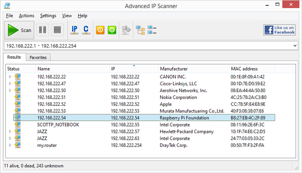

If you don't have an external monitor connected to the Pi, you'll need to connect to it via Ethernet. To do this we'll need to find its IP address.
The tool I use is Advanced IP Scanner. It generally picks up the subnets automatically, so you just need to hit "Scan" and wait.
Once it's done, you want to look down the Manufacturer column for entries called "Raspberry Pi Foundation". Make a note of the IP address.

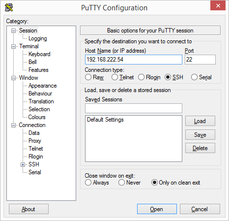

Connecting to the Pi
You can connect to the Pi using SSH over ethernet to run commands, install software, etc.
The best tool on Windows is Putty. Enter the IP address of your Pi, and make sure the port is 22 and the connection type is SSH, then click "Open".

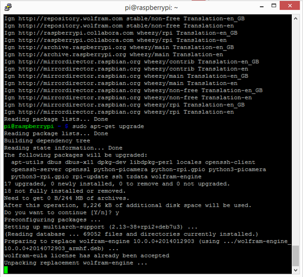

Updating software
Generally one of the first things I will do is make sure the latest packages are installed. This is done with 2 commands:
  • sudo apt-get update makes sure the list of packages is up to date
  • sudo apt-get upgrade installs the latest packages

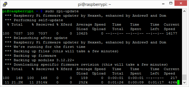

There is another command sudo rpi-update which will update the firmware and kernel to the latest (bleeding-edge) versions. Typically you don't need to do this unless a particular app requires it.
