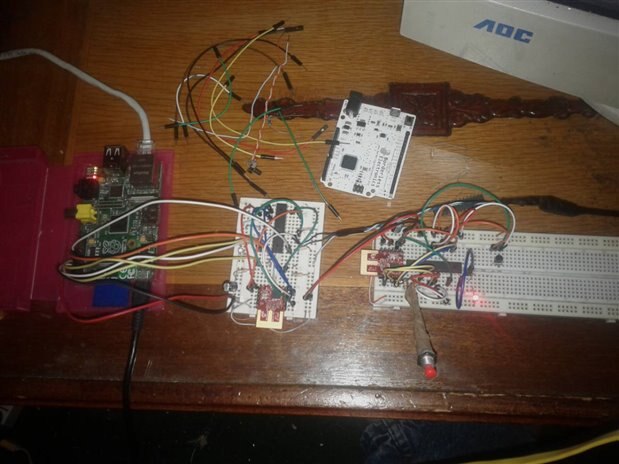

SO instead of scratching my head over this issue (for now) I decided to work around the problem. In the past I have successfully got the Pi to communicate with a microcontroller with both SPI and i2c, so I decided to use an intermediate micro to get the Pi communicating with the wireless module.
As the module uses SPI I decided to use i2c to talk to the Pi. So the set-up if currently set up like this:
PI <--i2c--> ATMega <--SPI--> MRF24J40MA.

Not really go much to show you in the way of pictures, but here are breadboards I have using building this crazy concoction with.

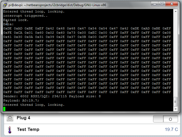

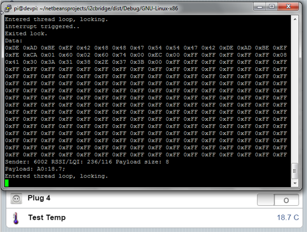

And here are few screenshots of the bridging software running on the pi printing out its debug messages and the OpenHAB webUI in the background displaying the value.

    Top terminal is my app getting a notification that the ATMega has data for it, getting that data over i2c, parsing the data and passing it over the REST API to OpenHAB. The webpage in the middle is a confirmation that OpenHAB has actually updated the value and the bottom terminal is the debug log output of OpenHAB accepting the data and storing it in to a MySQL Database.
