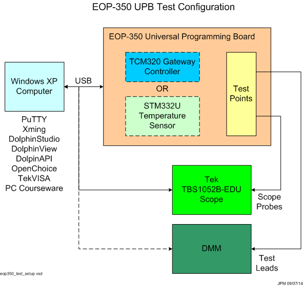

My new Tek TBS1052B-EDU scope and EnOcean EOP-350 Universal Programmer Board (UPB) arrived recently. Now I can configure and explore the analog and digital IO of a STM332U temperature sensor. The EnOcean EOP-350 UPB and the DolphinStudio software will configure and program the STM3xx series sensors. The programming board brings out most of all of the analog and digital IO signals on the sensor module to test points for probing with the Tek scope. The scope will be used to monitor signals. Figure 1 shows the EOP-350 test configuration. A Windows XP computer running DolphinStudio, DolphinAPI, DolphinView, OpenChoice Desktop, and TekVISA is connected to the EOP-350 and to the scope using a USB cable via a now new USB Hub. A Digital MultiMeter (DMM) will also be used for testing and can be connect to the computer by USB collect logged data if needed.
This test configuration will be used to learn more about the EOP350, the sensors, and how the sensors behave when they power up. The three things I want to learn are summarized below:
  • Debug the Built-In-Self-Test error reported by the TCM320U transceiver module.
  • Learn more about the output supply voltage from the STM332U sensor module when it wakes up and supplies power for external circuits.
  • Learn more about the analog input range and resolution of the STM332U sensor module.

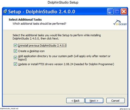

DolphinStudio Install
I installed DolphinStudio and let the install program create a desktop icon, added DolphinStudio to my PATH variable, removed the prior version, and installed drivers (see Figure 2).
Figure 2

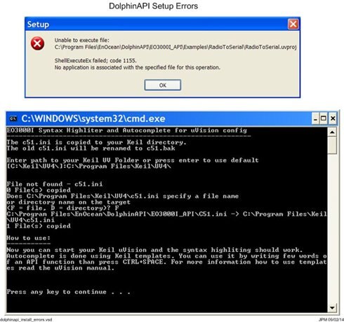

DolphinAPI Install
DolphinAPI was installed with the selected options shown in Figure 3.
Figure 3
It installed but generated an error regarding the RadioToSerial.uvproj, which I could not resolve (see Figure 4), but this did seem to be a problem for the questions I’m trying to answer. DolphinAPI also needed a C51.ini file from the Keil development tools. I had not installed this yet, so I created a dump file to continue with this installation. I later installed the Keil development tools. Keil V5 does not contain a C51.ini file and I have not yet resolved this issue.

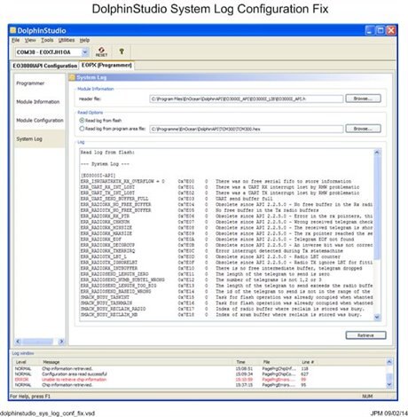

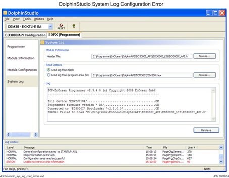

Once DolphinAPI was installed, the system log reported the status of the TCM320U module, as shown in Figures 5 (before) and 6 (after).
Figure 5
Figure 6

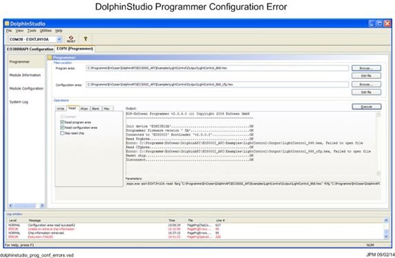

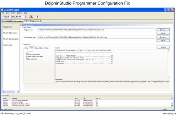

I made a similar change to the Programmer section of the EOPX [Programmer] Read Operations tab from:
C:\Programme\EnOcean\DolphinAPI\EO3000I_API\ \Examples\LightControl\Output\LightControl_868.hex
to
C:\Program Files\EnOcean\DolphinAPI\EO3000I_API\Examples\LightControl\Output\LightControl_902.hex
The program found the conf file too and updated it. Then, it gave me a warning that the files would be overwritten, so I changed the names slightly so the original file selected would not be overwritten by the read operation (see Figures 7 and 8).

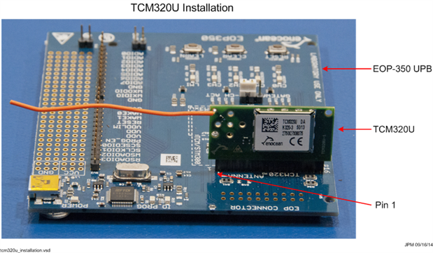

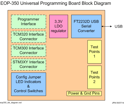

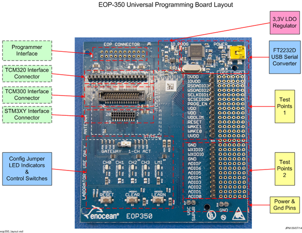

Figure 10 shows the block diagram of the EOP-350 UPB and Figure 11 shows the layout of the EOP-350 UPB [6]. The EOP-350 UPB has a FT2232D USB serial converter that provides communication between the modules on the UPB board and a computer. The 5V supply from the USB cable is converted to 3.3 V by a Low Drop-Out (LDO) regulator. This 3.3V is the main supply for the modules and is labeled as VDD on the EOP-350.
There are four interface connectors. The programmer interface is not used so the connector is not populated. The TCM320U interface connector is a 16 pin single inline connector, the TCM300 interface connector is a 30 pin dual pin plug connector, and the STM332U interface connector is a 20 pin dual pin receptacle connector. Only one interface connector shall be used at a time. The interface connectors are connected together in parallel so two devices will place two outputs on the same signal and cause a conflict.
A section of the board is dedicated to LED indicators, control switches like Reset, Clear, and Learn, and there is a configuration jumper to set a module into mode 1 or mode 2 (more about this later). There are also two test point headers for monitor and applying inputs to a module. There are power and ground pins that provide access to VGC and SWPWR, as well. VGC is the voltage of the charge storage from the energy harvesting circuit, and SWPWR is the switch power output from the module. SWPWR provides power to external circuits when the sensor module wakes up.
Figure 10
Figure 11

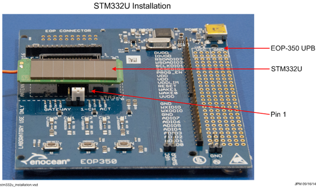

Figure 12 shows the proper TCM320U module installation and Figure 13 shows the proper STM332U module installation.

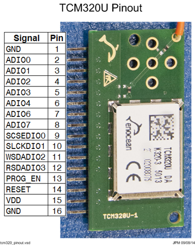

Figure 14, shows the TCM320U transceiver module with a table showing the pin number and signal names [7] [8] [9]. This module is powered with 3.3V between VDD (pin 15), and ground (pins 1, 16). An analog voltage of 0.52 V on ADIO0 (pin 2) sets the module in mode 2 with the configuration jumper in the 1-CH ACT position. The mode is selected by the configuration jumper on the EOP-350 UPB. Communication with the module occurs on ADIO6 (pin 7), and ADIO7 (pin 8). The other pins are inputs or output that can be configured using DolphinStudio and compiled into firmware using the Keil development tools. A more complete description of the signals is shown in Figure 16.
Figure 14

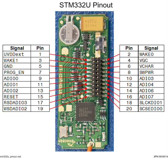

Figure 15 shows STM332U Temperature Sensor Module with tables showing the pin number and signal names [10]. The connections between the STM3XY module interface connector and the test connectors is not specified in the schematic in the EOP-350 user manual so I had to buzz some of them out with the DMM. VCHAR is connected to VDD on the test connector. When power is applied to the EOP-350 UPB via the USB cable, it charges the STM332U with 3.3V from the LDO regulator.
Figure 15

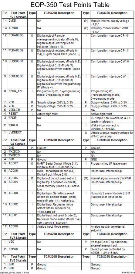

Figure 16 shows the test pin numbers, signal names and the function of each signal for the two modules. The signal types are I=Input, O=Output, and P=Power. If the signal type is in parenthesis then it is an internal signal to the module and can’t be measured on the test pin. Communication with the modules occur using the ADIO6 (receive data) and ADIO7 (transmit data) signals on the module. For the TCM320U, the analog input voltage on ADIO0 selects the operating mode, for the STM332U ADIO0 is an analog set point. The manual is not clear but I’m guessing this is a set point that a user controls to change the room temperature and becomes part of the heating/cooling control system.
Figure 16

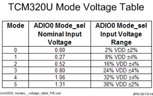

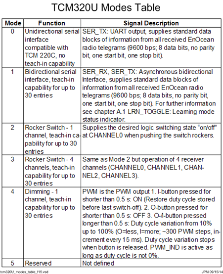

The table in Figure17 shows the operating modes of the TCM320U and Figure 18 shows the nominal input voltage and input voltage range need on ADIO0 to select the designed mode.
Figure 17
Figure 18

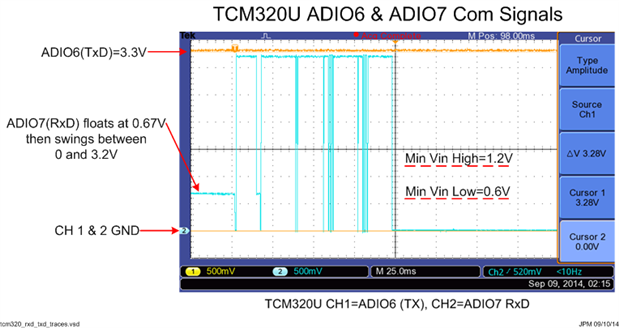

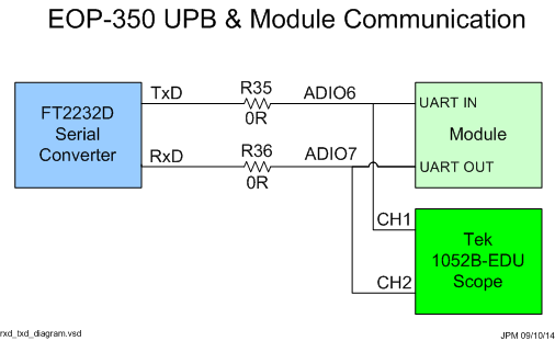

Figure 21 shows the communication connections between the FT2232D Serial Converter and the module. The Serial Converter transmits data (TxD) to the module on ADIO6, and receives data (RxD) back from the module on ADIO7. There are 0 Ohm resistors in series on each of the lines. I presently suspect that there is a problem with the transmit output from the FT2232D. It’s not clear how this might have been damaged. Changing the 0 Ohm series resistors to a resistance between 1000 and 10000 might to help protect the Serial Converter from accidental improper insertion of modules Ohms (value depends on Input Current High (IIH) and Input Current Low (IIL), which are not specified in the Core or module datasheets). The STM332U is particularly tricky to get plugged in correctly without pin or row offsets, for example.
Figure 21
Figure 22 shows the transmit (ADIO6) and receive (ADIO7) signals for the TMC320U measured using the Tek 1052B-EDU scope. ADIO6 is on CH1 in yellow an ADIO7 is on CH2 in blue with both channels set for 500 mV/div. The scope was set for a single trigger on CH2 and the time base was set for 25 ms/div so that multiple bits of the message could be captured. The transmit signal from the FT2232D, ADIO6 never changes state and stays at about 3.3V. These signals are triggered when I retrieve Module Information from the EOPX [Programmer] tab in DolphinStudio. The TCM320U reports a BIST Failed error at this point. The receive signal ADIO7 on the other had makes good transitions between 0 and 3.2 V and the highs are greater than the maximum input high voltage (Max VIH) and the lows are less than the minimum input low (Min VIL). ADIO7 floats at about 0.67V before the FT2232D becomes active. I understand from EnOcean support that this is expected.
Figure 22

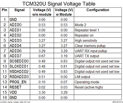

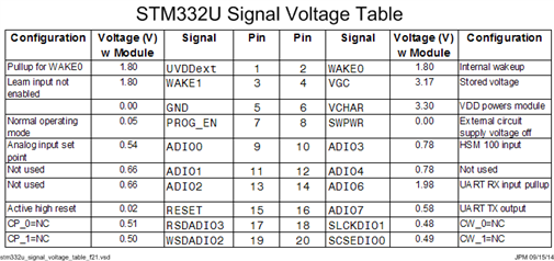

Figure 23 shows a table of voltage at the test points for the TCM320U with and without the TCM320U module installed in the EOP-350 UPB. When the TCM320U was plugged into the EOP-350 UPB, ADIO7 went from a low to a high and some of the unused digital outputs from about 0.5 V to 0.8V which would probably be interpreted as a logic low. I buzzed out the connector pins for ADIO6 and ADIO7 looking for shorts or low impedance connections on ADIO6 and test points and other circuits on the board but did not find anything that looked like a problems. The impedance between ADIO6 and other pins or connections on the board range from about 50k ohms to more than 10 M Ohms (open circuit). So this all seems typical and the ADIO6 pin on the TCM320U does not look shorted to the external pins on the module either. The cover on this module prevents me from checking possible shorts to DVDD and IOVDD within the module.
Figure 23

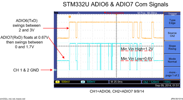

Figure 24 shows the transmit (ADIO6) and receive (ADIO7) signals again but for the STM332U measured using the Tek 1052B-EDU scope. The setup is the same as before with ADIO6 is on CH1 in yellow an ADIO7 is on CH2 in blue with both channels set for 500 mV/div. The scope was set for a single trigger on CH2 and the time base was set for 25 ms/div so that multiple bits of the message could be captured. The transmit signal from the FT2232D ADIO6 swings between 2 and 3 V. This swing provides a good high voltage, but the low voltage isn’t good enough to be a minimum low input voltage, so although the module responds, it still indicates something is not right. Again, these signals are triggered when I retrieve Module Information from the EOPX [Programmer] tab in DolphinStudio. The STM332U reports that BIST passes and provides internal data that the TCM320U would not. The receive signal ADIO7 makes different but good transitions between 0 and 1.7 V, and the highs are greater than the maximum input high voltage (Max VIH), and the lows are less than the minimum input low (Min VIL) most of the time. ADIO7 also floats at about 0.67V before the FT2232D becomes active.
Figure 24
Figure 25 shows a table of measured voltages for the STM332U using the EOP-350 UPB test points.
Figure 25

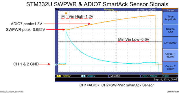

Testing the EnOcean Sensor Analog Input
I loaded the SmartACK Sensor example firmware into the STM332U module and connected the scope to the SWPWR and ADIO7 pins to see how the sensor module powers external circuitry. The STM332U user manual indicates that the SWPWR pin is controlled by ADIO5 output pin on the chip (it is not accessible) and provides 1.8V at 5mA to external circuits. The SWPWR power pin is switched on, and the processor waits 0.25 ms before sampling an analog input. Figure 26 shows the SWPWR signal (CH2 in blue) and the ADIO7 signal (CH1 in yellow). The SmartACK Sensor firmware sets ADIO7 high when an analog sample occurs. It’s not clear that the SWPWR power signal is turning on correctly since the output voltage only reach 952 mV at its peak (expecting 1.8V). It is not on very long either as the peak signal only lasts about 0.20 ms. I’m not able to find much in the EnOcean documentation on using this signal for powering external circuits by searching the knowledge base either. Also, I was not able to collect the analog values using the FHEM server running on the RPi.
Figure 26

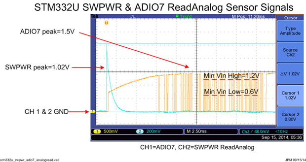

Figure 27 shows the same signals as above but using the ReadAnalog firmware example. This is a neat example. The analog signal on ADIO1 is sampled and then the value is transmitted to a TCM module using the UART communication port. CH2 shows the SWPWR signal, and CH1 shows the data to be transmitted by the UART. Unfortunately, my TCM320U is fried so I can’t receive the value. I used the RPi, EnOcean Pi, and FHEM to collect the analog reading but could not correlate the pot setting to a sensor value reported on the FHEM server. Also, a 10 k Ohm pot between SWPWR and ground with the center tap connected ADIO1 causes the SWPWR to collapse. Again, it’s not clear that the module is configured properly.
Figure 27
