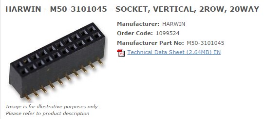

Like ravi_butani I was struggling to sort out a 0.5" pitch (1.27mm) connector, but have finally resolved this, and found these.
Thanks to element14's fast delivery it will be next day (well except its the weekend), so Monday is the next working day.

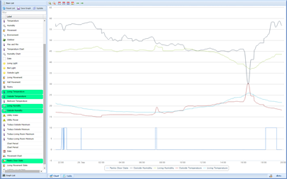

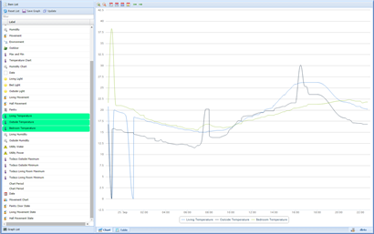

Charts
For my purpose, instant status isn't required, so I have been looking at options using trends or charts.
I'm trialing something at the moment, which does everything I want.
I'm still hesitant regarding it, as openHAB has crashed twice, BUT I can't say if this is the cause or not.

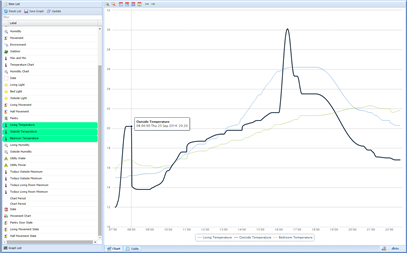

                              The Outside unit (on the windowsill inside) is getting struck by sunlight ... hence the peaks

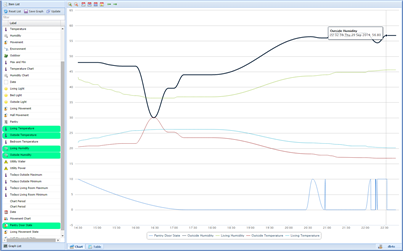

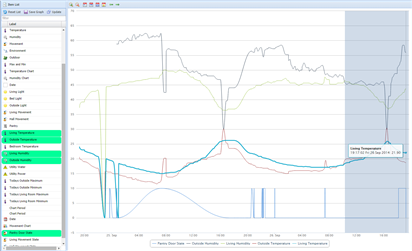

While openHAB has charting ability, you are stuck with whatever you initially setup in the sitemap.
The first chart shows all the temperatures, and the nice part is if you place the mouse over the line, it highlights and gives time and data values.
This plot includes the Humidity, which is useful, but the lines joining is distracting, so a fixed chart may be a pain.
The ability to zoom into any part is VERY useful, and is a simple matter of dragging the mouse across the area you want.
This charting option allows much greater flexibility.

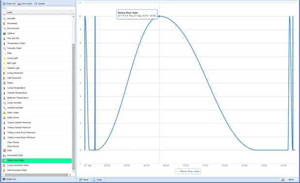

Movement Sensors
My proposal was to include movement sensors, to track movement trends, and ensure Granny is not just staying in the Bedroom or Living room.
The problem was how to display it in a meaningful manner that was relative to the other information.
My first attempt was to take the change, allocate it to a Number item with a value of 10 (so it appeared higher in the charts) or 0.
This worked but as the result above showed, the chart smooths it out and simply plots between the values.
After some head scratching and many cups of coffee later, I decided to modify the rule and update the value before changing it to the new value.
rule "update Movement Graph"
when
  Item Pantry_Door changed or
  Time cron "0 0 0 * * ?" or
  System started
  then if (Pantry_Door.state == OPEN)postUpdate(Pantry_Door_Graph,0)
       if (Pantry_Door.state == OPEN)postUpdate(Pantry_Door_Graph,10)
       if (Pantry_Door.state == CLOSED)postUpdate(Pantry_Door_Graph,10)
       if (Pantry_Door.state == CLOSED)postUpdate(Pantry_Door_Graph,0)
end
It's a solution that works but could be tidied up.
          This certainly makes it obvious when the Pantry Door is open
I'll apply the same trick with the Movement sensors.
So while its not complete, I can see that the ability to add and subtract from the graph is very useful, and will show what I want.
More importantly it allows flexibility.
