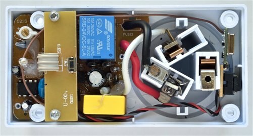

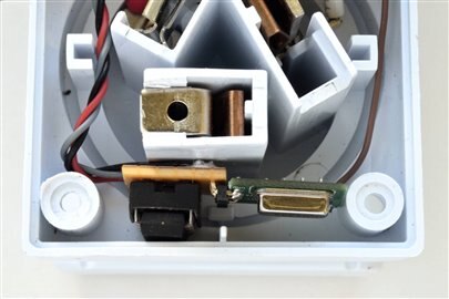

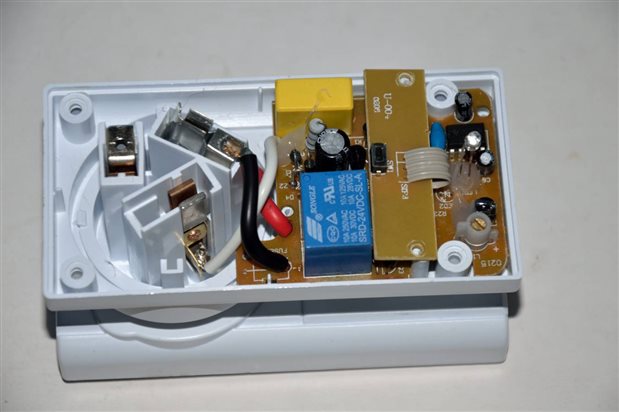

The intention is to fit the Transmitter and ATtiny85 inside an existing Watts Clever RF Switched Outlet.
As the picture shows there is very little room, and as such the final design has been modified very slightly to suit the construction.

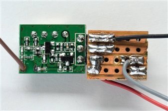

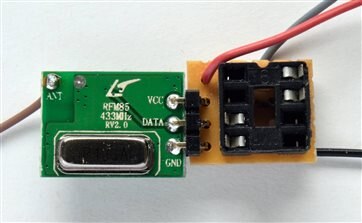

I've used veroboard to connect everything, rather than run multiple wires.
     As the photos show there are few connections, and removing the socket pins simplified the voltage connection to the transmitter.
Ideally I would have produced a pcb and sent it away, but I have only one socket which was not part of my original design.
However because I've seen how useful Openhab is, its worth adding it in now.
Control Pin
I'm using the relay drive pin on the main controller (pin 9)
It will either be HIGH when the relay is ON, or dragged low by the series resistor and base junction.
I don't want to continually send the status, so the ATtiny85 polls the pin for a change and sends the appropriate code.
This reduces the amount of RF floating around which could result in a data collision.

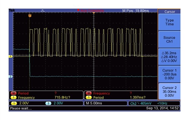

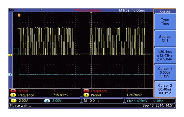

So each data bit is either 350uS HIGH, then 3x 350uS LOW, for a 0 or 3x350uS HIGH, then 350uS LOW for a 1.
Thus each data bit is 1400uS long, and my code is 24 bits long = 33600 uS or 33.6mS long.

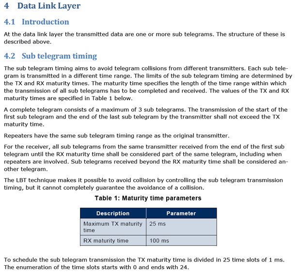

This contrasts with the EnOcean protocol which is 25mS long for 3 sub telegrams
The next item to check was the delay between repeats.
The library shows a sync is sent after the data.
* Sends a "Sync" Bit
*                       _
* Waveform Protocol 1: | |_______________________________
*                       _
* Waveform Protocol 2: | |__________
void RCSwitch::sendSync() {
    if (this->nProtocol == 1){
  this->transmit(1,31);
  else if (this->nProtocol == 2) {
  this->transmit(1,10);
The sync is 32 x 350uS = 11.2mS.
So is my deciphering correct.??
           single code transmission measured at 35.2mS
The calculation was 33.6mS so either the clock is out or there are some other delays ... but close enough.
           two codes transmitted and measured at 80.4mS total
This contrasts with the 78.4mS I calculated ( 33.6mS + 11.2mS + 33.6mS ).... but will work just fine.
Now that I know it takes 80ish mS for TWO data transmissions, I can program a delay for the status transmission and be assured there is little chance of a clash.

Installed
Despite forcing things to one side, bending transistors over, and generally being rough, it would not fit under the switch.
I resorted to fitting it beside the earth pin, which on hindsight is the better location.
Because everything is isolated from the user, there is no requirement to double insulate, so I could use whatever wire that suited and the separation distance didn't apply.
The 170mm antenna is looped up and around, which is the best you can do given the internal dimensions.
