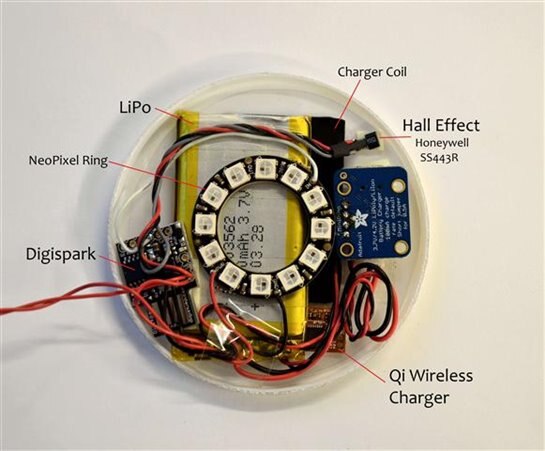

Some people may remember this from the 'Beyond the Phone' Challenge.
and the internals imageimage
Well some-one asked to borrow it, so I've been sorting out the modifications required.
Now that I have the programmer, the Digispark was replaced with an ATtiny85.
A brightness feature using another Hall Effect switch has been added, and the value stored in the EEPROM.
BUT
what does the above have to do with this Challenge?
When I first got the programmer, I managed to 'brick' a couple of ATtinys (a high voltage fuse resetter should recover one).
And in among the various things I tried, I had forgotten about fuse settings.

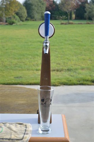

Since I used the last of the ATtiny's for the Illuminated Beer Tap, I needed to dig out another 'raw' chip.
Sticking it into the programmer, and uploading it late last night, it wouldn't do anything.
I recalled seeing something in this High-Low Tech – Programming an ATtiny w/ Arduino 1.0 about the bootloader.
Configuring the ATtiny to run at 8 MHz (for SoftwareSerial support)
By default, the ATtiny’s run at 1 MHz (the setting used by the unmodified “ATtiny45″, etc. board menu items). You need to do an extra step to configure the microcontroller to run at 8 MHz – necessary for use of the SoftwareSerial library. Once you have the microcontroller connected, select the appropriate item from the Boards menu (e.g. “ATtiny45 (8 MHz)”). Then, run the “Burn Bootloader” command from the Tools menu. This configures the fuse bits of the microcontroller so it runs at 8 MHz. Note that the fuse bits keep their value until you explicitly change them, so you’ll only need to do this step once for each microcontroller. (Note this doesn’t actually burn a bootloader onto the board; you’ll still need to upload new programs using an external programmer.)
I had forgotten to burn the bootloader, and hence it wasn't doing very much at all.
So my side road distraction has saved me from some frustration later, and the exercise has reminded me to add some more to my next element14 order.

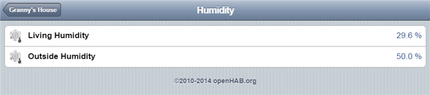

OpenHAB
Due to some issues with parts, my sensors needed to be swapped to 868MHz, and thanks to Markus from EnOcean they arrived followed a few days later by the 868Mhz EnOcean Pi.
I have managed to identify all the EnOcean modules, reprogram two STM330's for Humidity by following Pas Home / EOP 350 Basic use
This post by p-brane is also very comprehensive and makes it very easy to see how to attach the sensors, and check or adjust them.
Forget Me Not Design Challenge Post 05: EnOcean EOP-350 Universal Programmer Board

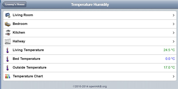

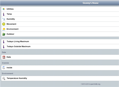

Now that I have some data, it was easier to see where the problems with my menu were.
This isn't the final, but its something to start looking at how I view the data, and make the adjustments.
                As this shows the sensor I have allocated for the bedroom temperature is being recognized but is not programmed.

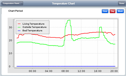

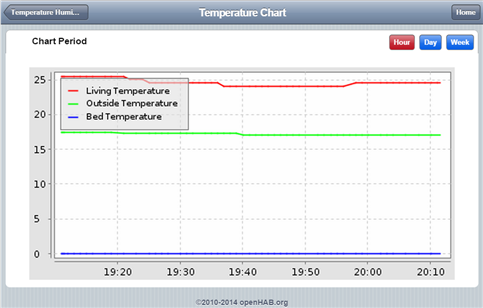

Thanks to fvan post about persistance, I was able to quickly sort out a chart with all the temperatures and left it running overnight.
We live out in the country, and there is no lighting (we have a night light in the hallway) and it was overcast last night, but both the 'Living' and 'Outside' units continued to send data.
I'm impressed by them, and I am questioning if I can use them for my light sensors, rather than an external solution that will need power.
Despite the titles, the 'Outside' unit is sitting on the window sill, and receives the sun directly onto it ... obviously at 0900 and again at 1630.
The 'Living' unit is on the keyboard beside the computer, so might be receiving a little stray heat.
The Humidity sensors (HSM100) are showing figures only, so the next thing is to graph these.
I'm a little surprised by the 30% reading for the 'Living' one as it seems a little low.

    mcb1 over 12 years ago in reply to DAB
    Thanks ....good question.
    I need to check the specs, but I suspect its relative, which would stack up.
    mcb1 over 12 years ago in reply to shabaz
    I see you're on 24.5 degrees at home : )
    Yeah not sure that that is correct.
    There is a calibration inside these and an offset, and its possible neither are correct.
    I need to put something next to them to see if they are correct.

    I see you're on 24.5 degrees at home : ) I thought I was extreme, my optimum setting being 23.5 degrees image
    DAB over 12 years ago
    Hi Mark,
    Good post.
    Are your Humidity sensors relative or absolute?
    That might account for the difference.
