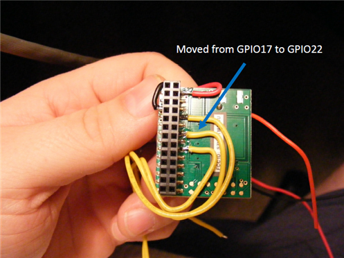

So, I've built the circuit to interface my soil sensor to my Raspberry Pi. I modified the previous circuit to work with the B instead of the B+ because I couldn't get my B+ to recognize my USB keyboard. It's slightly weird because the B recognizes the keyboard. I've included a picture in Figure 1 that shows the soldered modifications. I needed to access some of the GPIO of the RaspPi, and the female header is surface mount. This means I cannot solder wires to the back of the board, or simply replace the header and extend the pins through the board. Note, the picture shows one wire soldered to GPIO17, but I didn't notice that pin is reserved for the RTS of the UART. After noticing this, I moved the wire to GPIO22.
Figure 1: Modifications to the EnOcean Pi board. One wire was originally connected to GPIO17 but was moved to GPIO22.
The modified lines are soldered to the following signals:
  • 3.3 Volt line
  • Ground
  • GPIO4 -> Pump Activation
  • GPIO22 -> Low threshold (Shown as GPIO17 in the picture and modified after the picture was taken)
  • GPIO27 -> High threshold

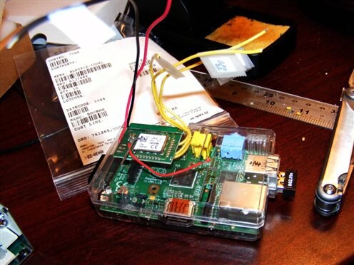

In the picture below we can see the modified EnOcean PI placed back on the Raspberry Pi header and in a case I purchased from Amazon. I really like this case because you can access the header even with the lid on. Notice I marked my wires. You only have to make that mistake once and you'll tag your wires from then on.
Figure 2: EnOcean Pi back on the Raspberry Pi in its case. Wires are labelled as they exit the case.

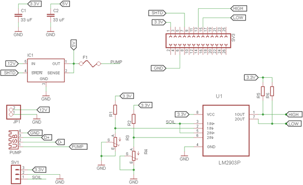

Figure 3 shows the modified circuit diagram of the comparator interface board. A fuse was added to the pump for protection and the header is now for a B unit instead of a B+. Some pullups were added to the output of the dual comparator (U1) because it has open collector outputs.
Figure 3: Modified circuit. A few changed were made from the original circuit: a fuse was added, pullups were added to U1's outputs, and the header was swapped for a B instead of a B+

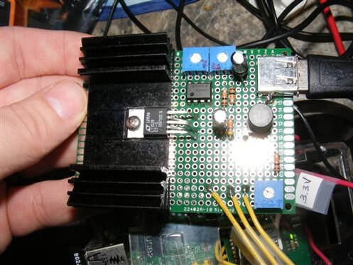

Here is the board I made based on the circuit in Figure 3. On the left side is the heat sink for the regulator that powers the pump. The USB connector on the right side goes the pump and the round black piece below that is the fuse (removable). The IC is the dual comparator and the two potentiometers on the top control the high and low threshold levels. I have not received my soil moisture sensor from DX.com yet (it's been over 8 weeks), so I wired a potentiometer to act as the input voltage. You can see that pot in the lower right corner.
Figure 4: Constructed comparator board. Note the large heat sink. I blogged about the heat sink previously.

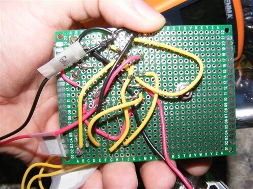

I included the shot in Figure 5 to show the work in wiring that circuit. I only have three wire colours in my collection right now, so red is positive voltage, black is ground, and yellow is signal. It's definitely not a stretch of the imagination to see why they call it a Rat's Nest.
Figure 5: A picture showing the bottom of the board. Not hard to figure out where the term Rat's Nest comes from ...
